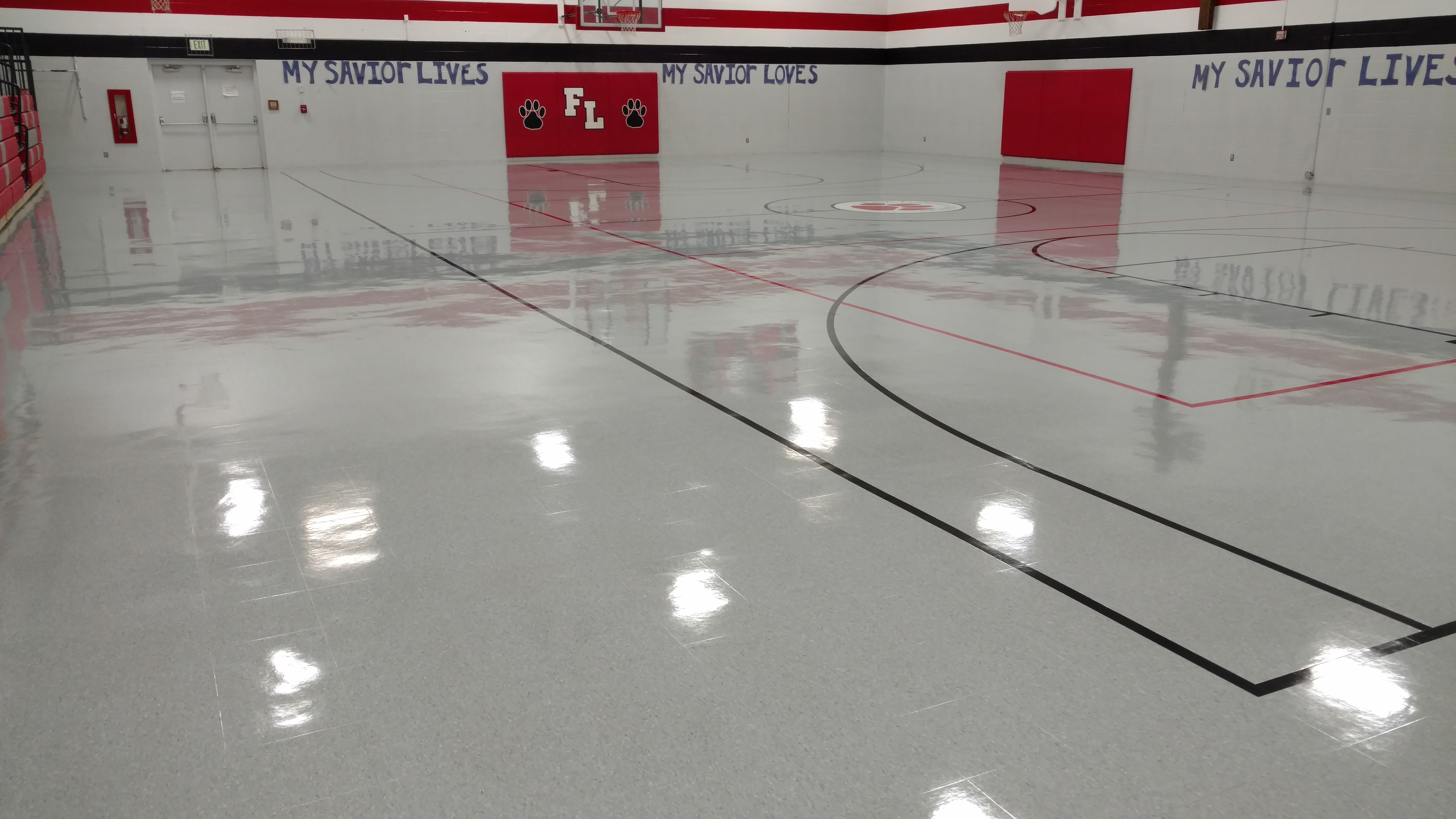

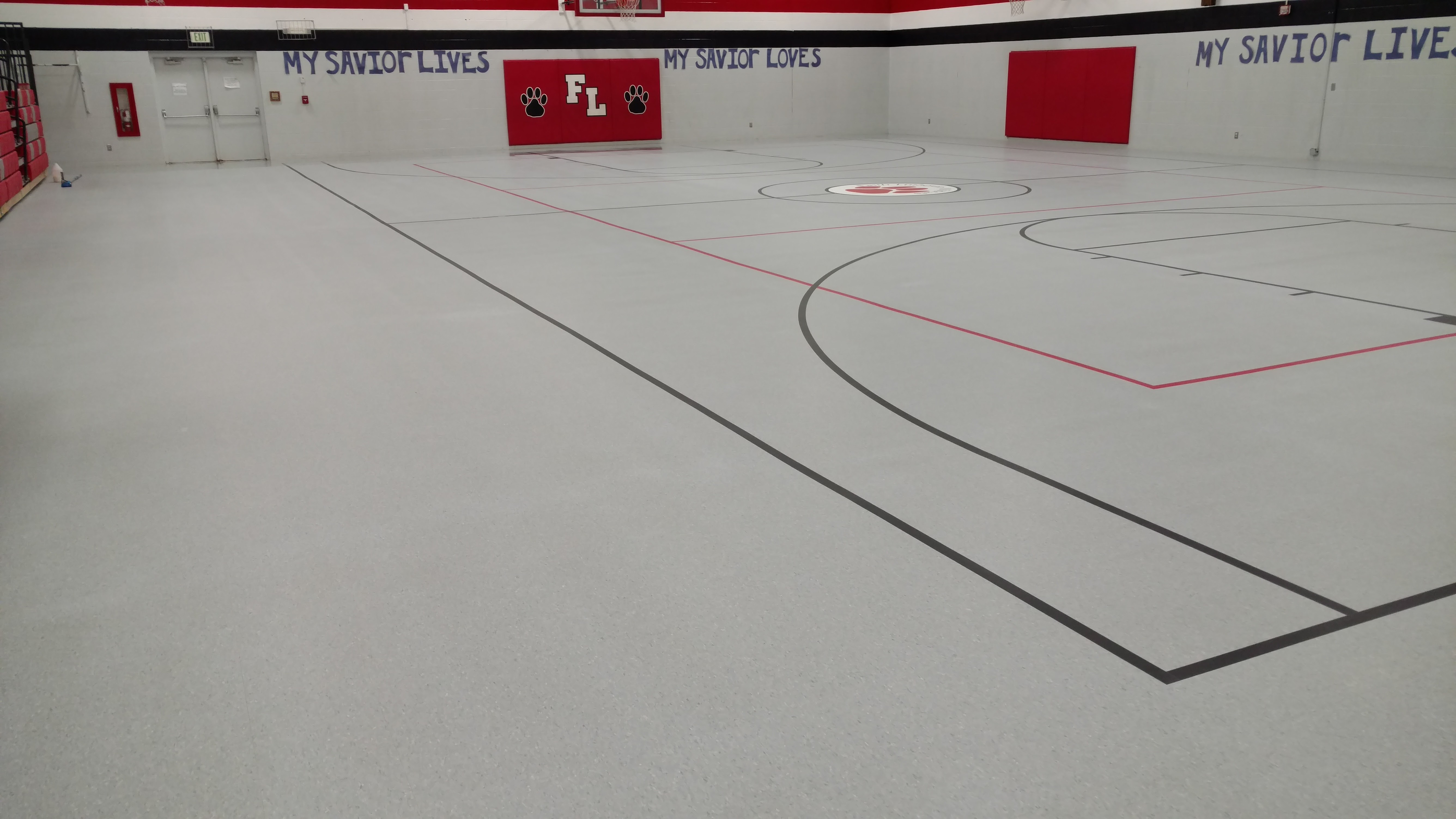

32inch flat mop , poor down about a 10ft line , then go back and forth spreading out the wax. Killing time? sitting on a 5 gallon bucket of wax. I will put down blowers to speed dry so as the wax is drying I'm moving the blowers.

View attachment 79364 View attachment 79365
How far do you spread away from that line, and how thick in the line?

Bruce
On this floor I used 1 gallon jugs , I only use 5 gallon jugs at Nexteer.
I poured the wax center between the bleachers and the first black line and did the same with all the other lines , something in my head says stay between the lines :shrug:
How thick? I guess enough to make sure it will cover the area I'm spreading it over.
