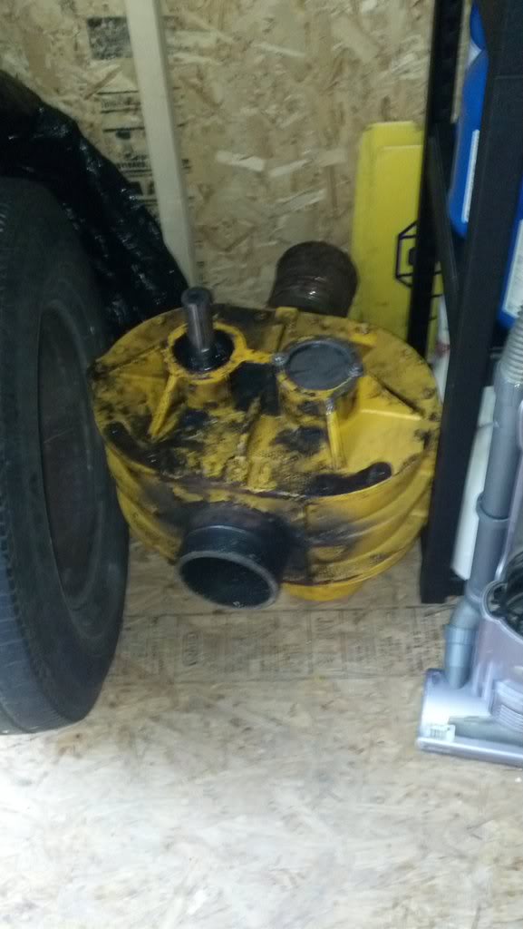

OG 6008 blower is done.
Lower seal popped out when greasing the bitch today.
and now the shaft has some wiggle in it.
My N#$@** rigged bearing fix held but I think it's time to put in the virgin blower.

My thoughts on the short life of V blowers.
Talking to AT today, they said the manufacturer thinks 6000 hours is about all to be expected considering the design and use.
On the 6008 series Vs they were designed ( almost looks intentionally :shock: ) to drip grease from the shaft side down on to the lower PTO shaft pulley. Most V newbs thinks it's loose belts causing them to slip as the grease is so little you can't see it,, so the belt get over tightened. If you find the boards and read about the issue or have a good eye than you put hoses on the weep holes and channel to grease elsewhere and slacken the belts. Overly tight belts lead to short bearing life
Most V owners run there blower over 15 inches of lift so the unit runs hotter....Not good for the blower..
I'd like to hear some thoughts on the goofy angle these blowers are installed at, could be an issue...Where is Ron Beatty?

On the 6008 series Vs they were designed ( almost looks intentionally ) to drip grease from the shaft side down on to the lower PTO shaft pulley. Most V newbs thinks it's loose belts causing them to slip as the grease is so little you can't see it,, so the belt get over tightened. If you find the boards and read about the issue or have a good eye than you put hoses on the weep holes and channel to grease elsewhere and slacken the belts. Overly tight belts lead to short bearing life
you are correct..but I don't think it was intentional...just a bad design that no one thought about...the lines on the weep holes should of been standard issue....
This has been a big problem with a lot of Vortex owners...little grease..a little slip...and they are play dueling banjos on there drive belts...and burning bearing...
I never really seen any issues with the blower at a slight tilt...most blowers don't really care how you set them as long as they are true to what they are running...and can still splash the oil on the wet side....the only draw back was it limited the angle of drive ways that you could set it on because it was already pitched....
yours and Beattys problems are 2 different issues...
114,514
my new blower was built with the pulley shaft on the right side so it will have to be flipped upside down.
Now I'll be greasing the bearings from the out side in, if that makes sense...
should help keep the non drive side bearing in place, if greasing was what caused the last one to start moving off the shaft.

BTW...If you have to flip the blower....will the rotation still be the same way.....?????
Jimbo
2,197
Make sure you check the vent position on the oil bath side since you are turning the blower over...you don't want the oil to drain out.
