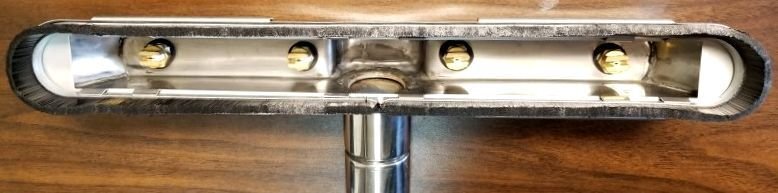

Not too sure about the way the brush split in the front. Need something before Scottsdale.
Larry Cobb
Cleaning Professional
5,795
Larry Cobb
All of our brushes are split in the back.
Somebody slid on the brush the wrong way.
Enlarge the photo to see it clearly.

The split is supposed to be in the back, I'm going to have another talk with my guys again about it. Any other feedback will be appreciated.
Those hoses are standard wire braided vinyl coated hose.
We are also considering a 12" head version of this tool with 2-jets. We've got drawings made up but waiting on some more interest and feedback from some of our clients.

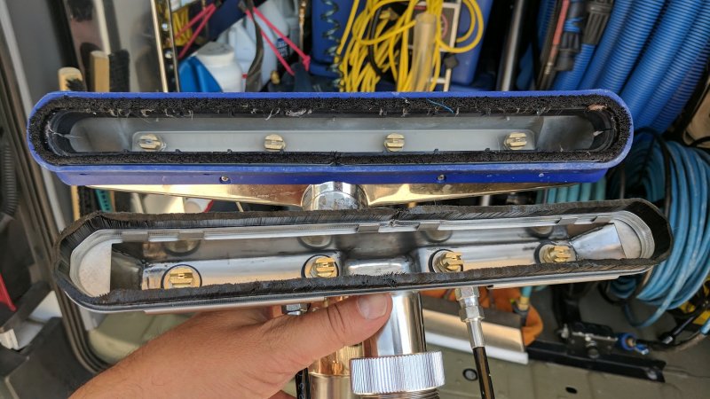

Well..
On Vinyl floors it's a near twin of the HF wand.
A bit more water escapes from the ends (110s should swapped out to 95s)
Brush ring flexes more due to no support ring
Ergos are more traditional but the handle needs to held higher than the HF for good extraction
The 14" on both tools is too wide and hard to fight to get much benefit out of the swivel. It should be rigid and have a 12" option with a swivel.
Both tools would benefit from a much narrower vac slot to speed up velocity.
A glided wand is quicker on LVP as it is....

Thanks for the input Mike.
Did you like the flex on the brush or would you prefer the support ring?
Those 110's are pretty close to the edge so I can see where the 95's would help.
We've got drawings done of a 12" with 2-jets, but haven't produced samples of it as of yet.

I think the support ring is a good idea. Fix it and I will buy. No swivel.
For a very good price : )
117,380
My dream HS wand would be a 12" swivel, 6 jet, narrow vac chamber, brush ring with sliding support.
There is no need for the giant vac chambers on these wands.
The 14" should be rigid imo. Too much effort to control and doesn't work along toilets anyways..
