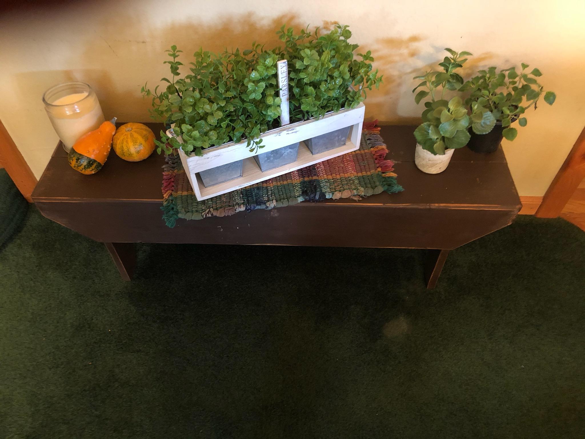

dye , darker colors are MUCH easier that the very light almost white ones
Had one not long ago. Called by a housekeeping service to one of their clients homes. Small spots, on a dark grey.
Had to clean a bunch surrounding it to not feel guilty, the repair went so quick.
