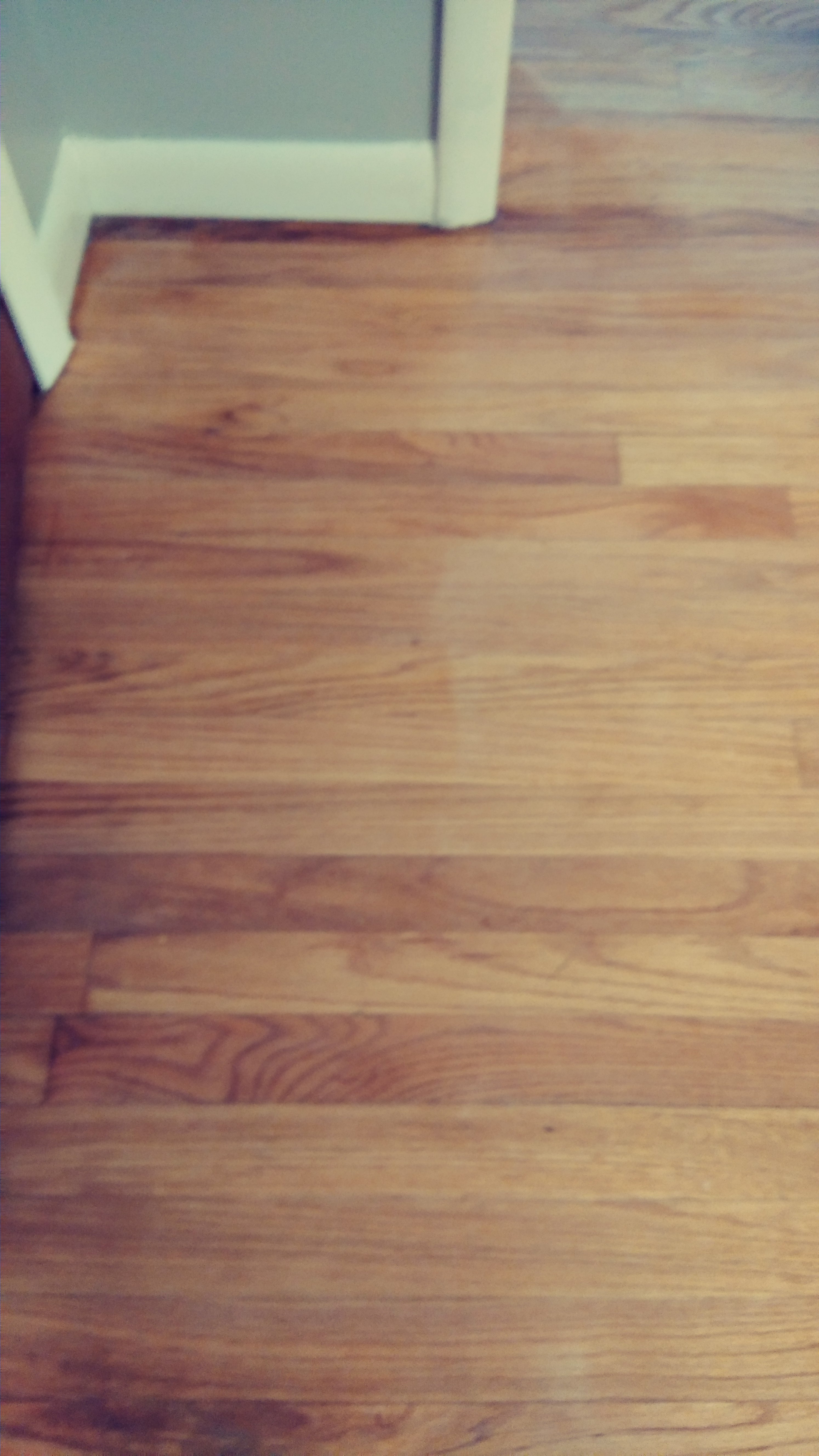

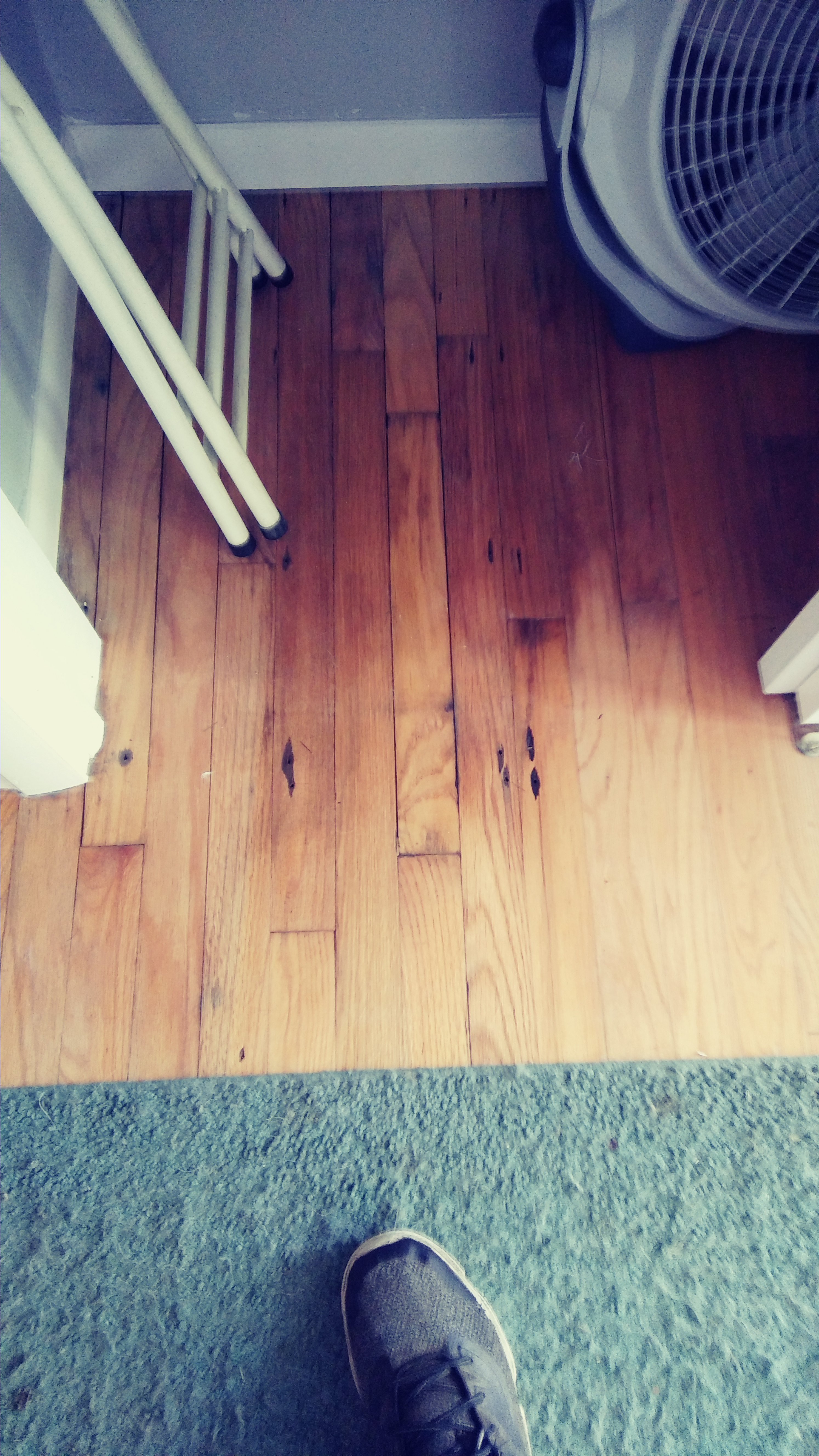

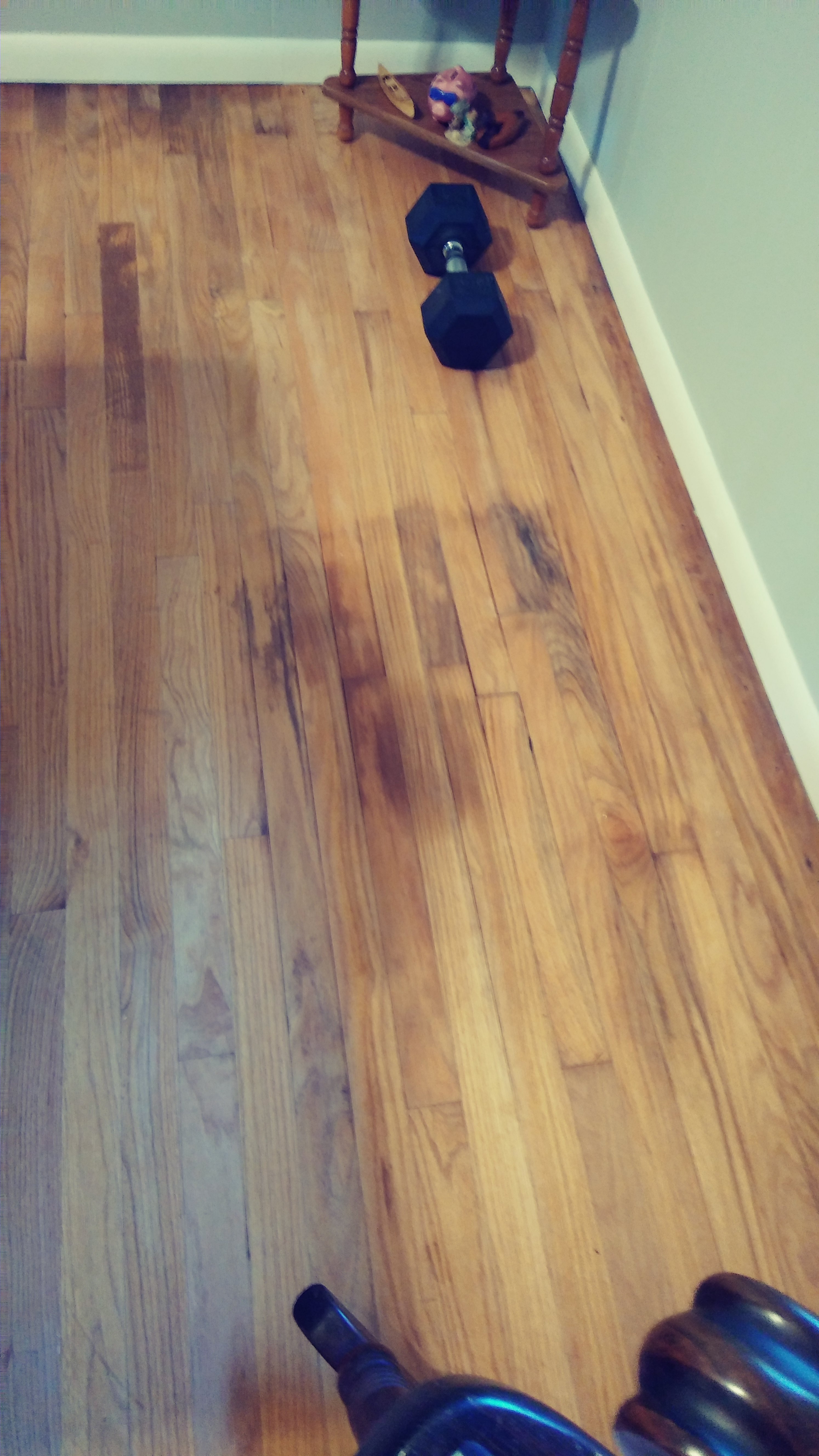

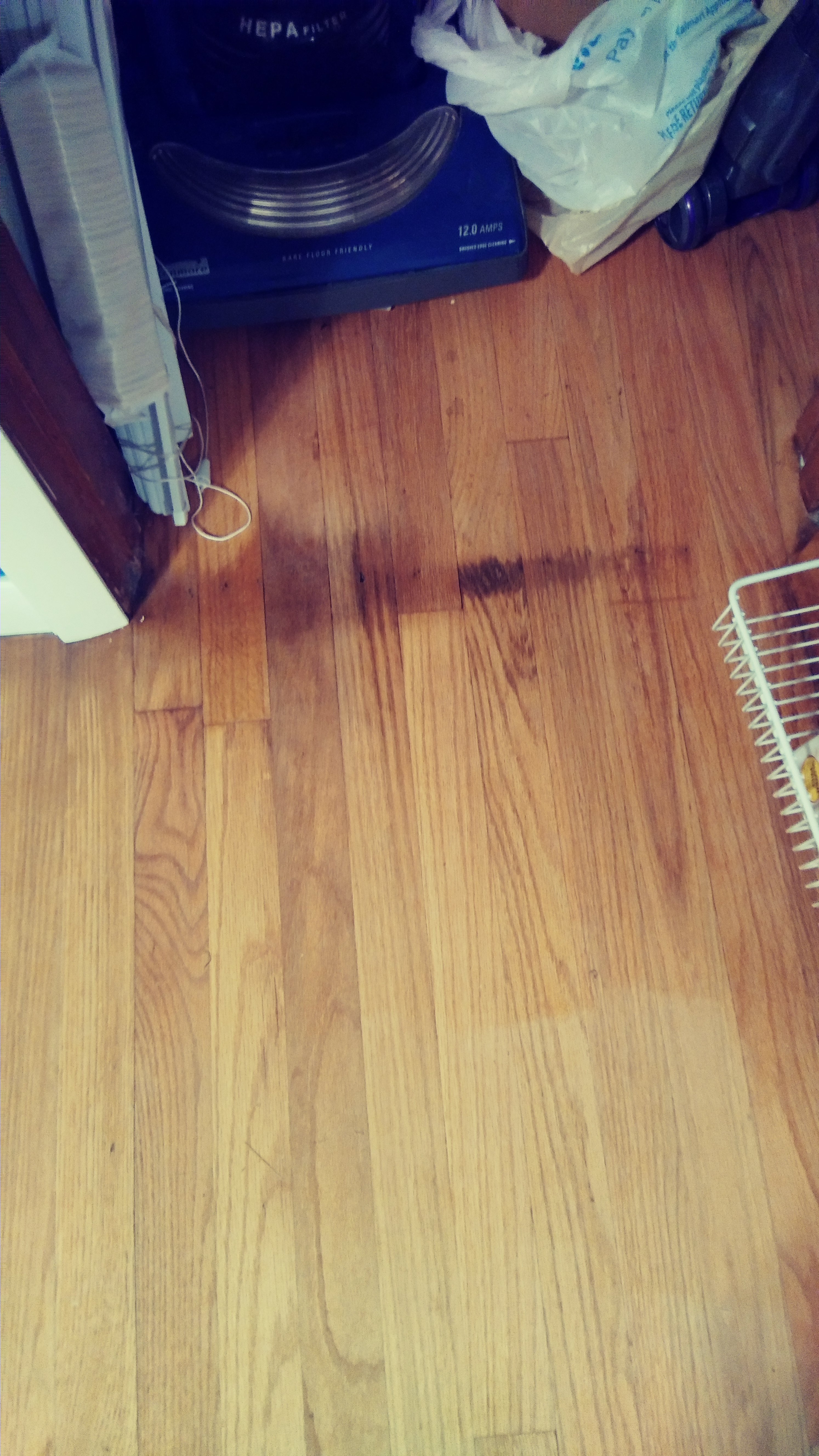

What caused this?
13,371
20180918_164626_Film1.jpg20180918_164612_Film1.jpg20180918_164448_Film1.jpg20180918_164438_Film1.jpgattic fire in april. Moved back in 3 weeks ago and then this happened.
Is there a fix other than replacement?

Started Saturday and keeps getting worse. Around all the walls and a few areas in the middle.
Look at the line under the closet door.

the blackish in the middle of floor, sure looks like water damage to me
The closet lines too, but could be easier explained by someone mopping with door closed and leaving mop water lay under closed door
no clue how it got blackened in the middle by the dumbbell ...unless there was table or something that didn't get moved while mopping and mop water laid under it
again..SWAG...but looks like water soaked in to me, Steveo

View attachment 84871View attachment 84872View attachment 84873View attachment 84874attic fire in april. Moved back in 3 weeks ago and then this happened.
the last pic looks like cleaner dwelled longer or mopped harder to get cleaner on right and not as clean on left
same in closet without black streak
cleaner floor to the closet,less clean in the closet
OR.....
what's being used as cleaner?
Maybe it's removing whatever finish is on floor
It it ole school paste wax or polyurethane?
