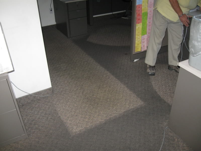

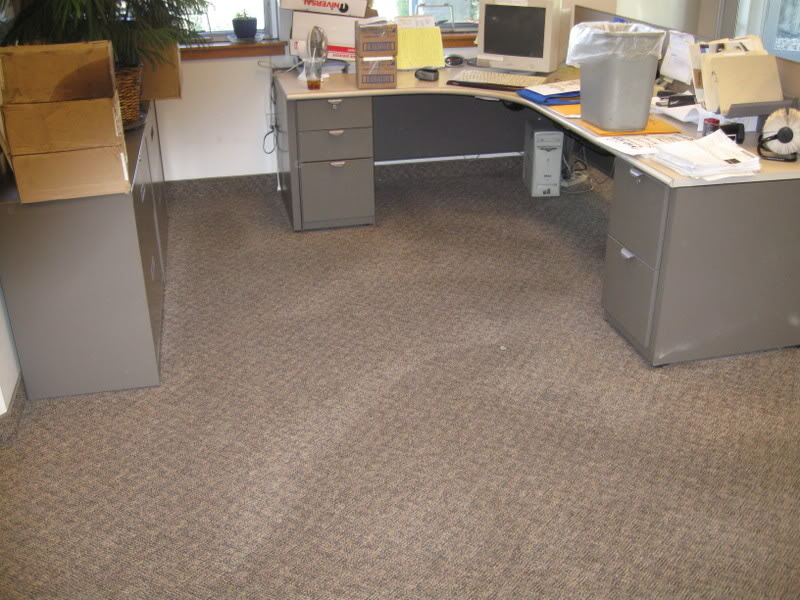

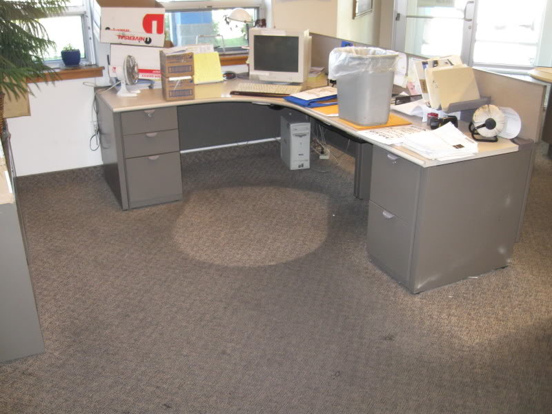

I cleaned a freight company office today. HWE with 220-240 ATM... Greenhorn wand ten flow, bumped the pressure up to 500 PSI. Used a strong solution of bridgepoint Zone perfect mixed with citrus solve. I used Power-Point in my head-cap jug metered around 4 or 6 gal/hour.

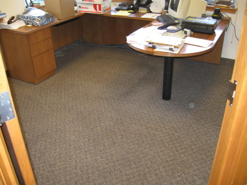

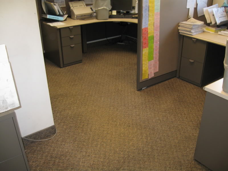

I pre-scrubbed with an adsorbent pad and post padded with cotton. You can still see where the mats were. Is there something I am missing?
And yes, that's my helper in the before pic...

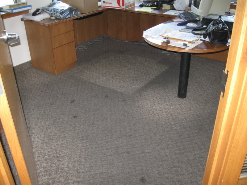

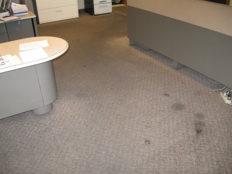

I don't really know what I was thinking with the last two pics. I didn't keep track of my before and afters too well...
Anyway, lemmenowhachathinkin...
112,802
Try pre scrubbing with a Red pad next time and trigger spraying some Encap and 30 vol along with your post padding, but once a carpet is that bad it will never be 100% again.
They should be thrilled with what you did.

First thing I don't get is why you're using Zone Perfect when you have carpet in that condition. If you're a bridgepoint man you should of at least been using traffic slam or flex, I probably would of pulled out power break myself though and mixed for heavy soil and applied it liberally 1 gal per 100-150 ft. You need to choose the right chemical for the job, and I'm one that leans towards going above what is recommended and let the chemical do the work. Boosting those with some citrus and some H2O2, roto scrubbing with a 175 with at least a white pad and rinsing with an emulsifier (which I think you did) would of done a lot better. Don't worry so much about carpet warranties when the carpet looks like that....the warranty is gone. So you're job is to get it as clean as possible and if the customer is worried about the protector you can sell it to them of course. In my opinion based on what you used I'd say you under cleaned that job. Now if you pulled out the big guns like I said above and got the same result I'd say you did your best so you need to make sure you are using the right tool for the job.

Yep, Powerburst(if you are a bridgepoint fan Power Break) and a red pad (I would have used a green, but you are not ready for that). I agree with the others, they should be pleased, that carpet was trashed. In an environment like that it is difficult to completely erase the outline of the mat as the fibers are significantly distorted from abrasion as the wheels roll off and on the mat. It just grinds the sand into the fiber and vacuums (if that place even has one) don't do well on the transition when/if their staff is vacuuming.
