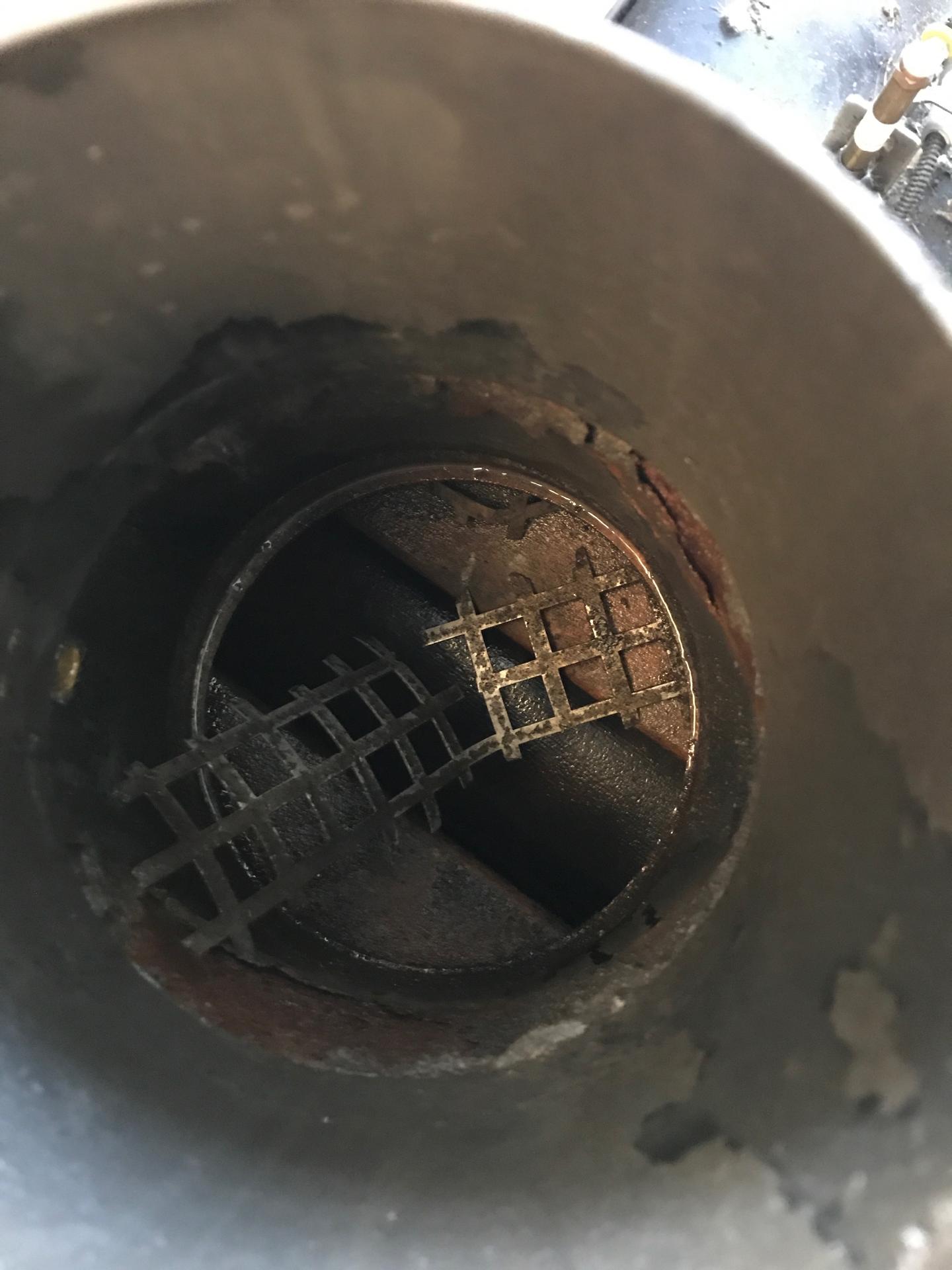

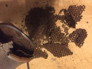

Look what we found in the blower?
Aluminum liner bits from a few months back when a filter failed.

I had the same filter failure happen on the Vortex, like a giant garbage disposal, the 6008 just chewed it up and spit it out.

I'm not sure where we got the aluminum ones but they come stock with stainless and we had plenty of stainless ones on the Sshelf to replace them with

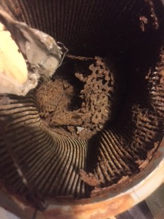

P Style filter removed from a #5 blower due to corrosion failure
