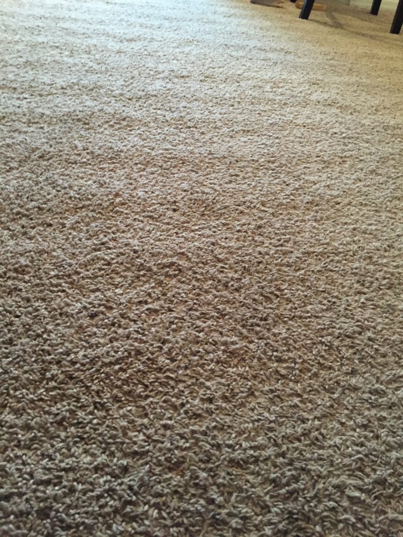

What is this?
Charlie Lyman
2,631
Charlie Lyman
I know what this is and I know what to do.
But, let's say I'm a newbie that has never seen this and doesn't know what to do.
What do you guys say?

Yes, roll crush. I figured it would steam out. I've seen it before, but not with the crush marks so close together.
Customer wanted me to stretch it out.

Seems like it might need a good stretch after the steaming process. Those high points will add up to extra material once flattened out.
I kinda like the look of the waves !!

I haven't messed with it yet. She was moving out and will call to schedule the cleaning.
I don't really want to stretch it because some goon put metal strips along the transitions by the linuloleum. I hate pulling those up.

If it is a high quality, thicker carpet I don't think you will get much stretch out of it at first. It needs time to relax first.

You should be able to gently pry the top of the transition strips up release the carpet and then use a white rubber mallet to gently pound them back into place, unless it's a Z bar transition.

It was installed in 2008. It is cheap stuff in a 1200 sq ft home. It is now a priority because she wants to sell the home. She never had it cleaned either.
But, according to her, it's a million dollar home and she has invested too much money into it to offer a carpet allowance.

If it's that old then I would say you can definitely get a stretch out of it. I would stretch and then clean it.

Steam it then stretch !!
Sorry Kellie .. I really dont know what Im talking about but sure sounds good !!

Lol!! No! Stretch then clean! It's old carpet so it should already be plenty relaxed!

Im usually told the repair guys want it cleaned before the restretch. I figured they just want it clean before they crawl around on it.

Probably because if theyve experienced the results of a super soaker, thinking the carpet may buckle - which then the stretcher will be blamed for poor installation.

So, that is one reason and the other reason was mentioned above as well.
Since I am both the stretcher and cleaner, I stretch and then clean right afterwards. I let the customer know that it may buckle a little bit after the clean but will settle back down. The buckling will be due to the carpet adjusting to its new tensity.
