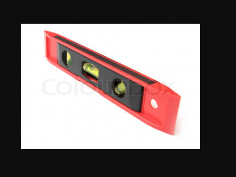

There are 3 axis to line up simultaneously. A level will do one.
Yeah ok.
Done mine top bottom and sides this way…belts been fine running no issues.
