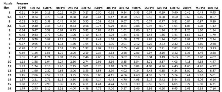

#4 @ 600 PSI =1.55 GPM
#8 @ 300 PSI = 2.19 GPM - Winner . . . more Impact, Better Cleaning,
Decent TM's will do better with even more GPM.

Spraying Systems has lots of jet impact info.
Double the GPM and you get DOUBLE the impact.
Double the PSI and you get 1.44 x the impact.
Most T&G cleaners are running two #0502 jets.
We have been changing them to two #0503 jets,
and seeing a significant increase in cleaning power (50%) .
