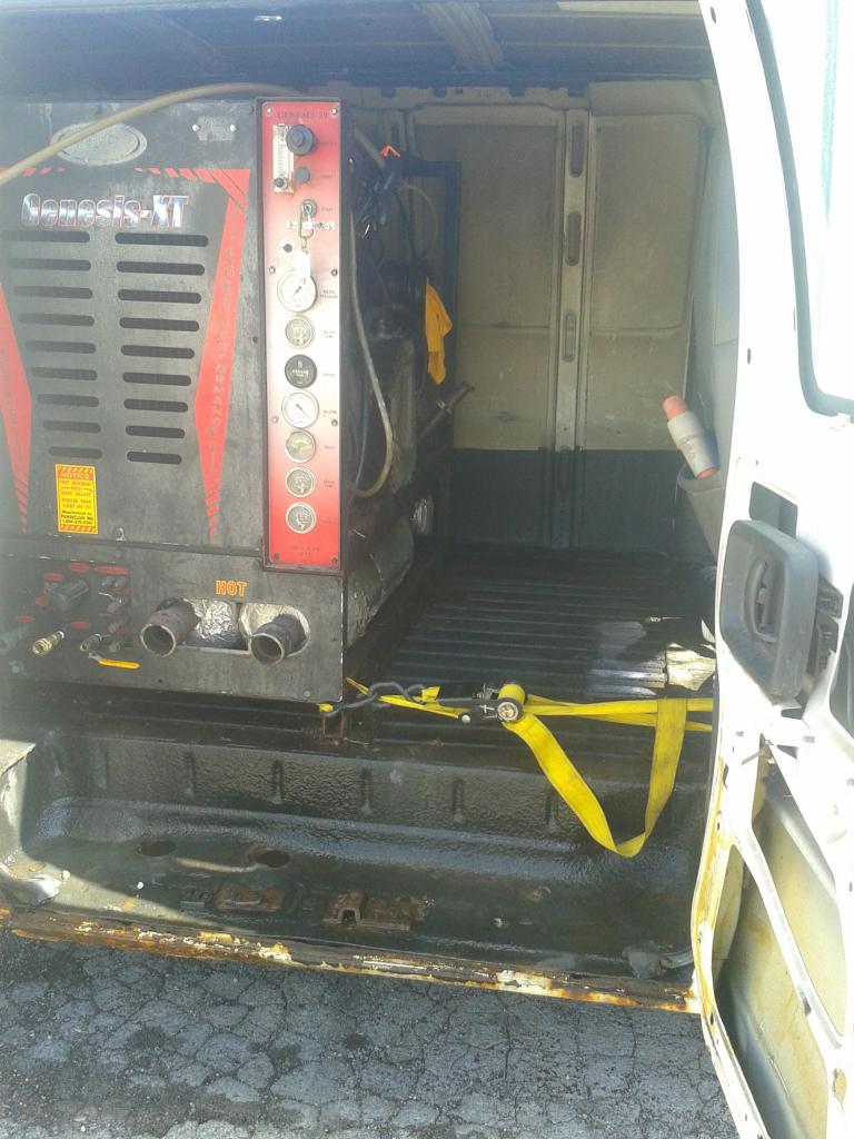

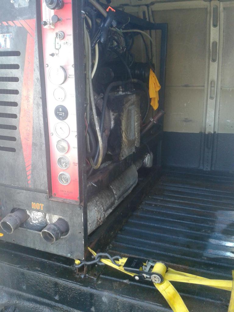

Funny you should mention this. I just had mine pulled out this afternoon. My Son and I cleaned out the van, cut the bolts, plugged the fuel line, secured the TM, and drove it to installer today. It took an EXPERIENCED installer 15 minutes to pull the Genny out with a fork lift because it was installed slightly rear of the side doors. Guys, this is a 1500 lb machine, and it ain't a do-it-yourself job unless you have a forklift. Cherry picker wouldn't get enough lift on it to clear the door, and you ain't rolling it out and catching 1500 lbs!
I wanted the "new" unit in a box van, but couldn't find one I liked, so I am installing into my 03 Chevy extended for now.
More pic's when I pick it up tomorrow.
Well, had "new" TM installed between 1:00 yesterday, and picked it up at 5 today. The experienced installer even stayed over on Wednesday night to get it ready for today. He ran into some problems that extended the install time. No problem for me, I need assured it was done right.
Now some do it yourselfer could have extensive downtime if they run into install problems. I had an experienced installer doing the work, and he got every thing corrected.
I have installed a Mastermatic with my Sons and B-I-Law. It probably only weighed 5-600 lbs if that, and the foot print was only maybe 2.5x3 foot, minus the waste tank. I think we lifted it up with steel pipes and slid it into the van. Ya ain't doing that with todays big TM's!
