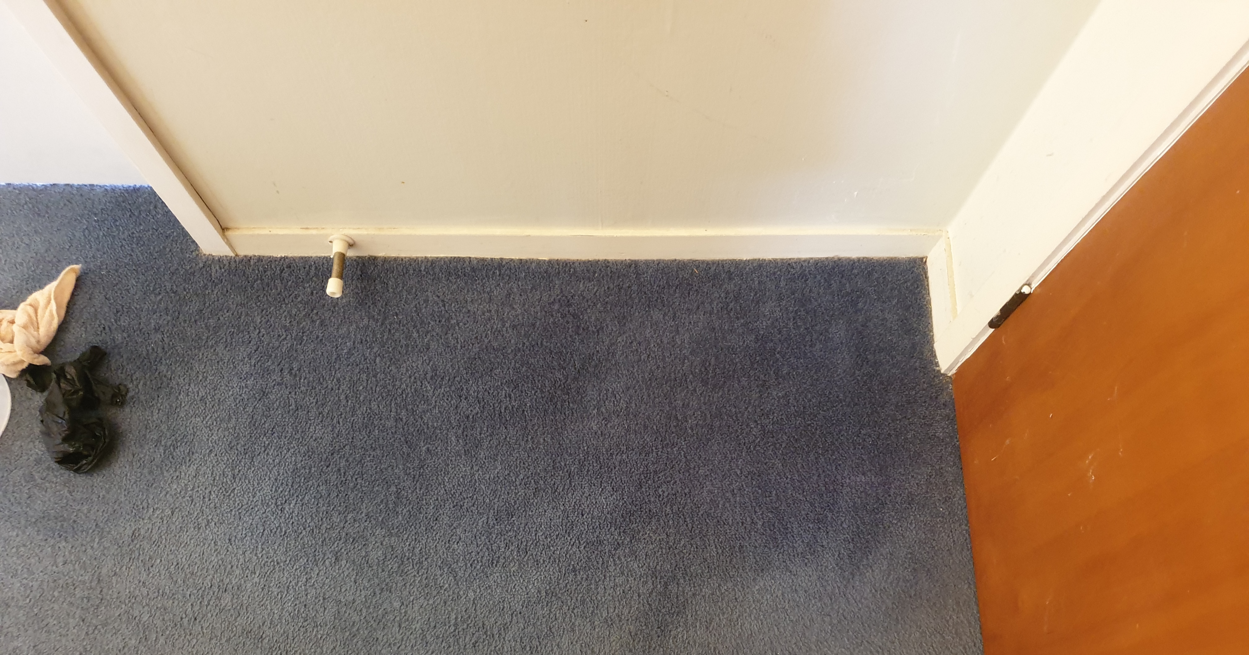

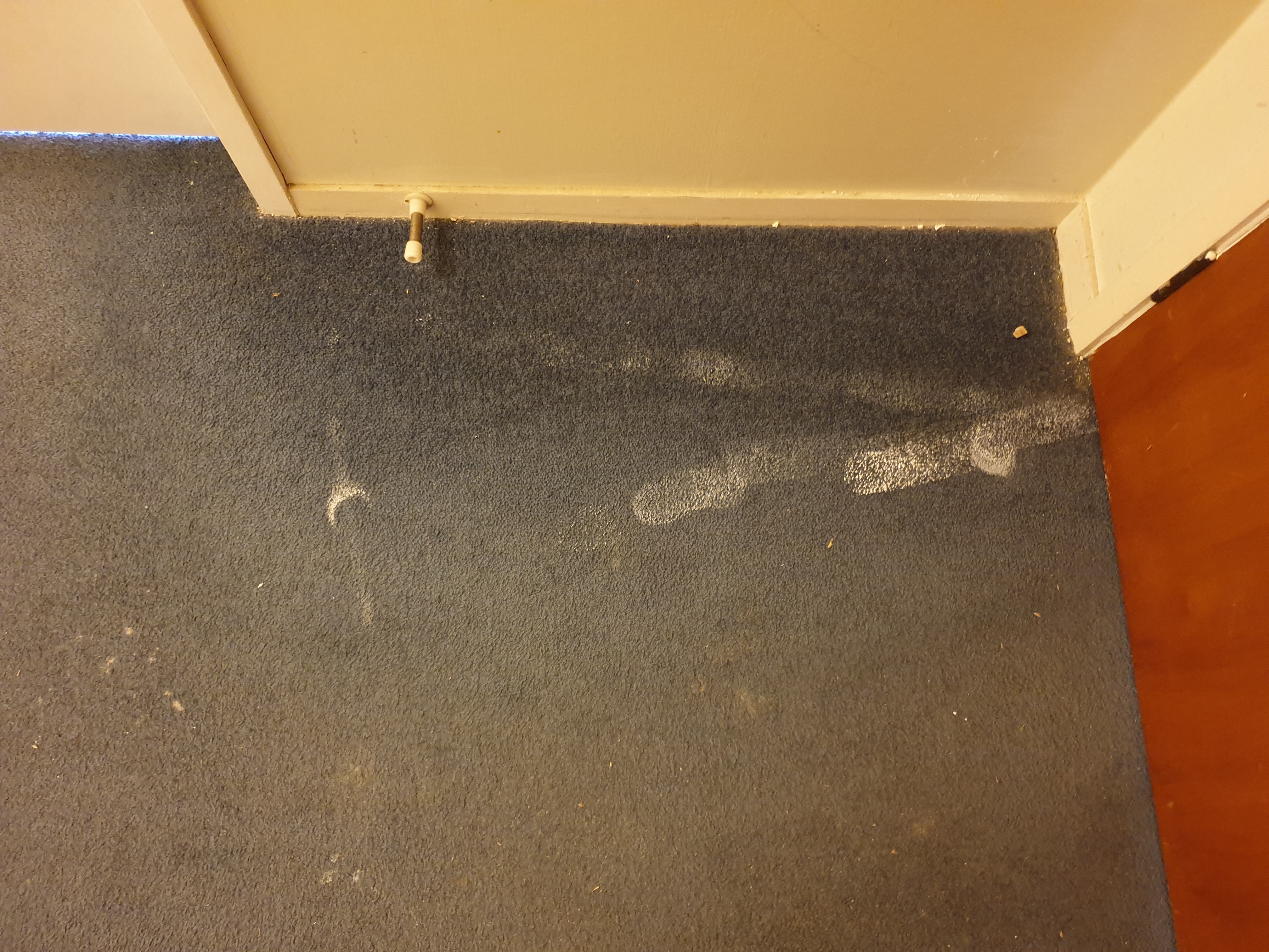

View attachment 95276View attachment 95277
I should of set up a fan.. the solvents were getting to me![]()
I really like goo gone the bottle with the small hole in the center of the seal. A couple bucks fits in the pocket and really works well with low odor. Can get it at a lot of places locally.I havent found a POG I like...watcha using?
acetone and isop 50:50I havent found a POG I like...watcha using?
