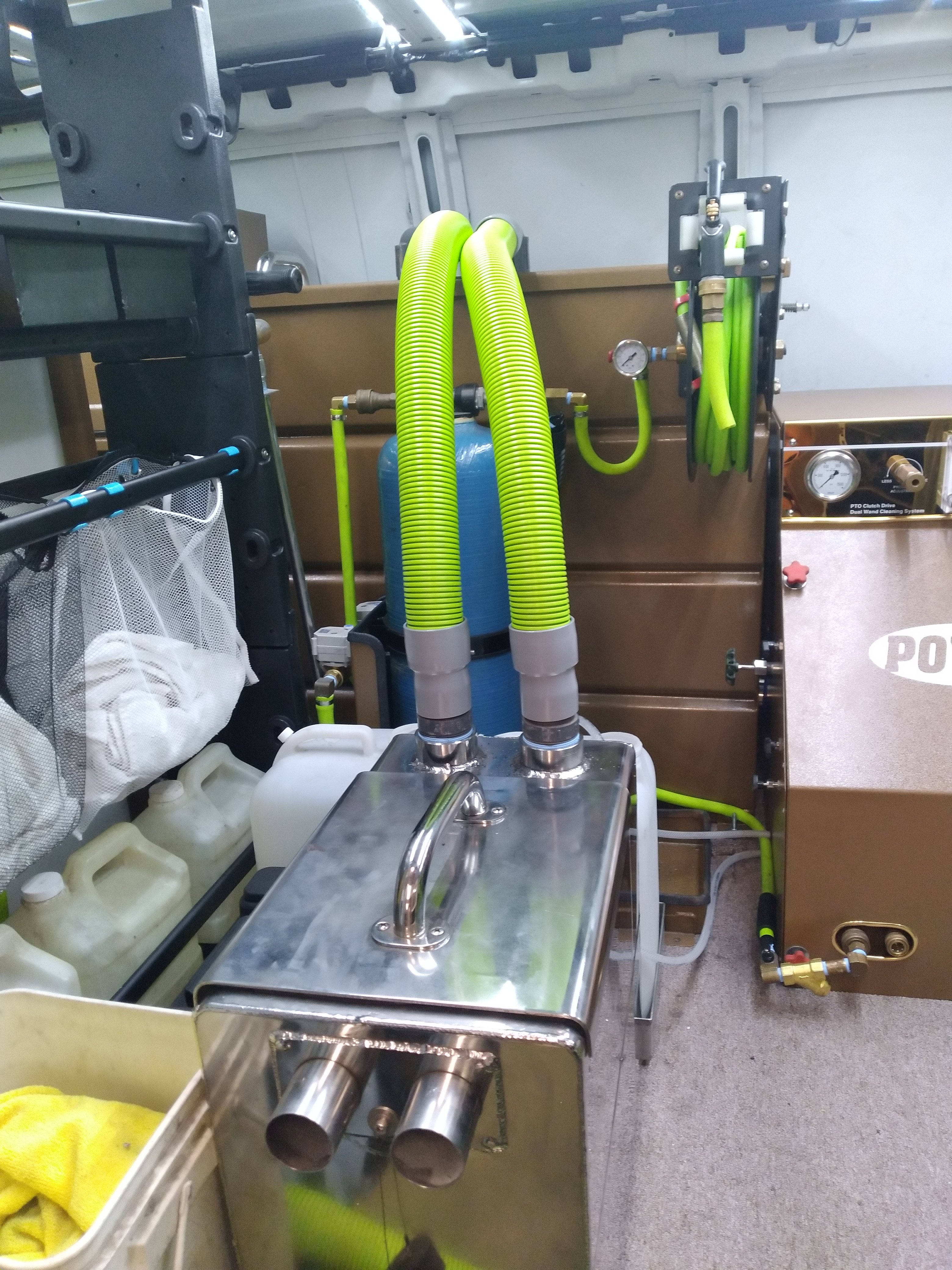

Between 2 meters, vacuum guage and anemometer i will measure simultaneously both lift and flow in various scenarios this may not the true tale of whats going on inside the hose but will show differences in how hoses lay and effect on lift/air speed/volume in a side by side comparison. This is the best i can do without a laboratory and knowledge to use it . My filter tank is setup with 2 inlets so ill hookup 2 -125' lengths of hose 1 straight and 1 in various states of coiling 1 side vacuum guage other anemometer
