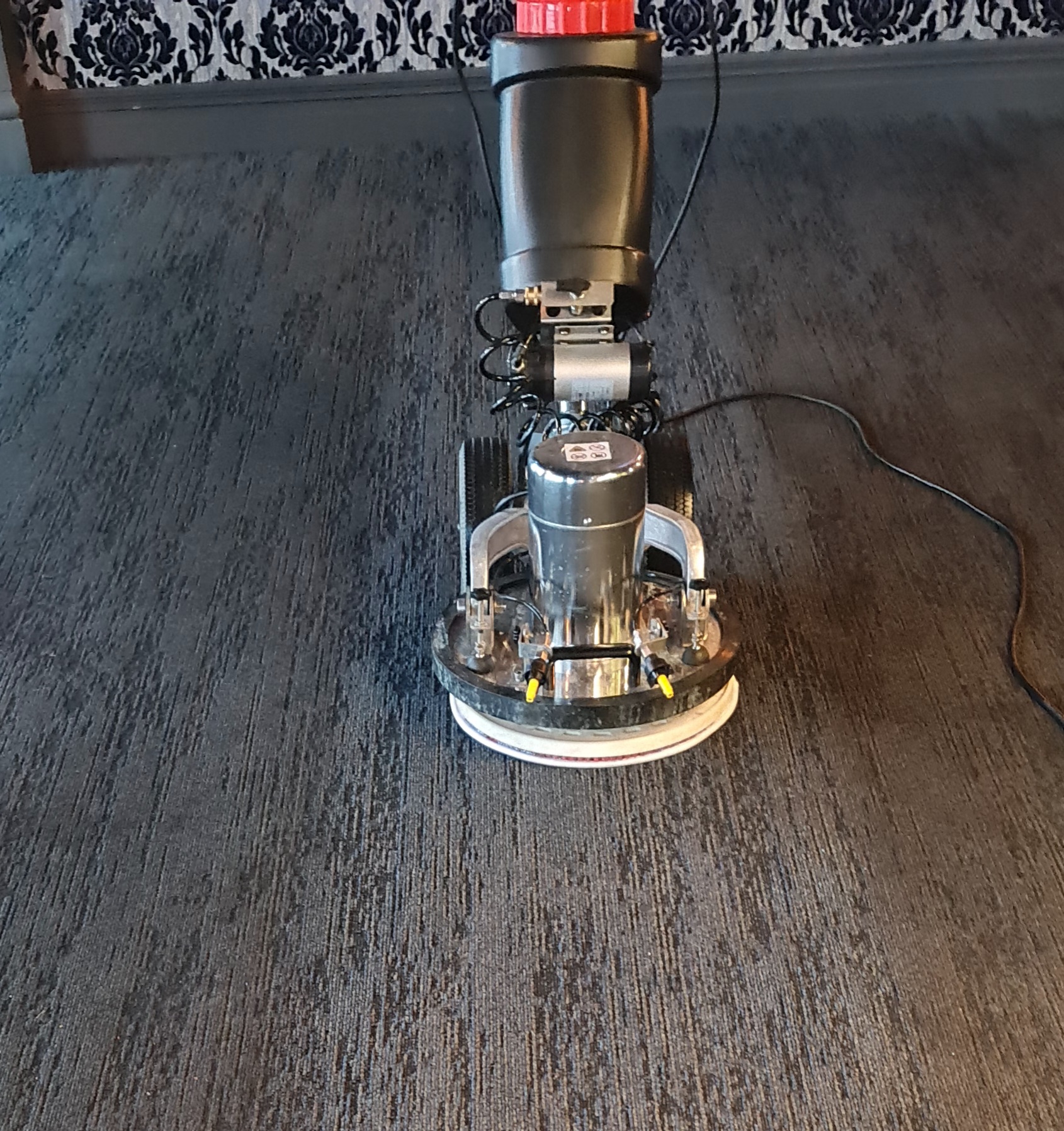

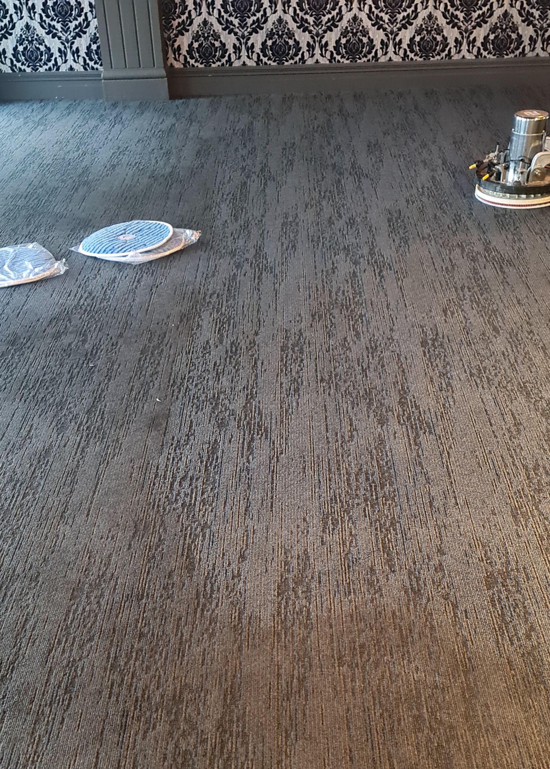

this is the worst cgd I personally encap, I start 7am (their requirements) I'm out by 9am and they open doors for lunch service at 11am
they're open 7 days into the wee hrs, HWE puts them out of action too long
*it gets HWE once a year on staff social day, encapped other 3 visits

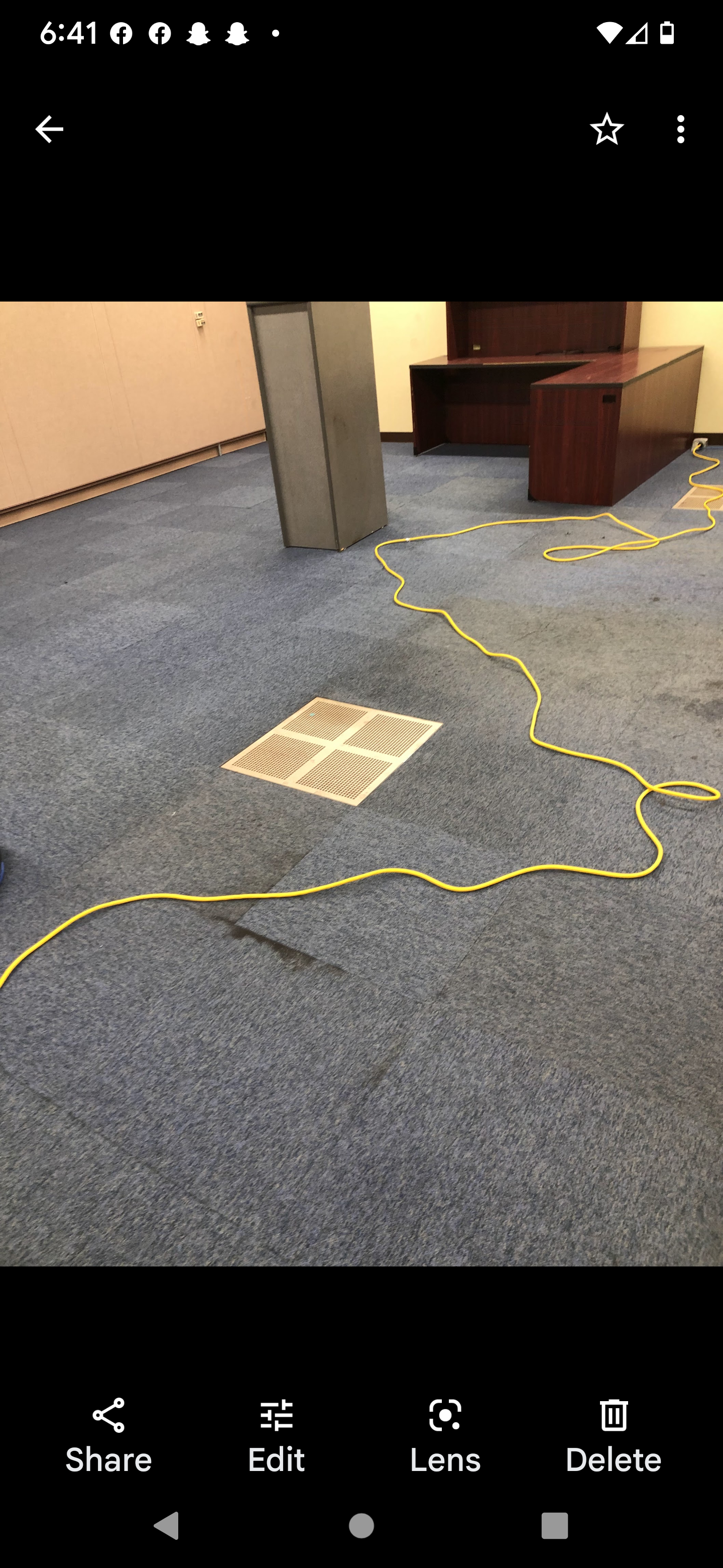

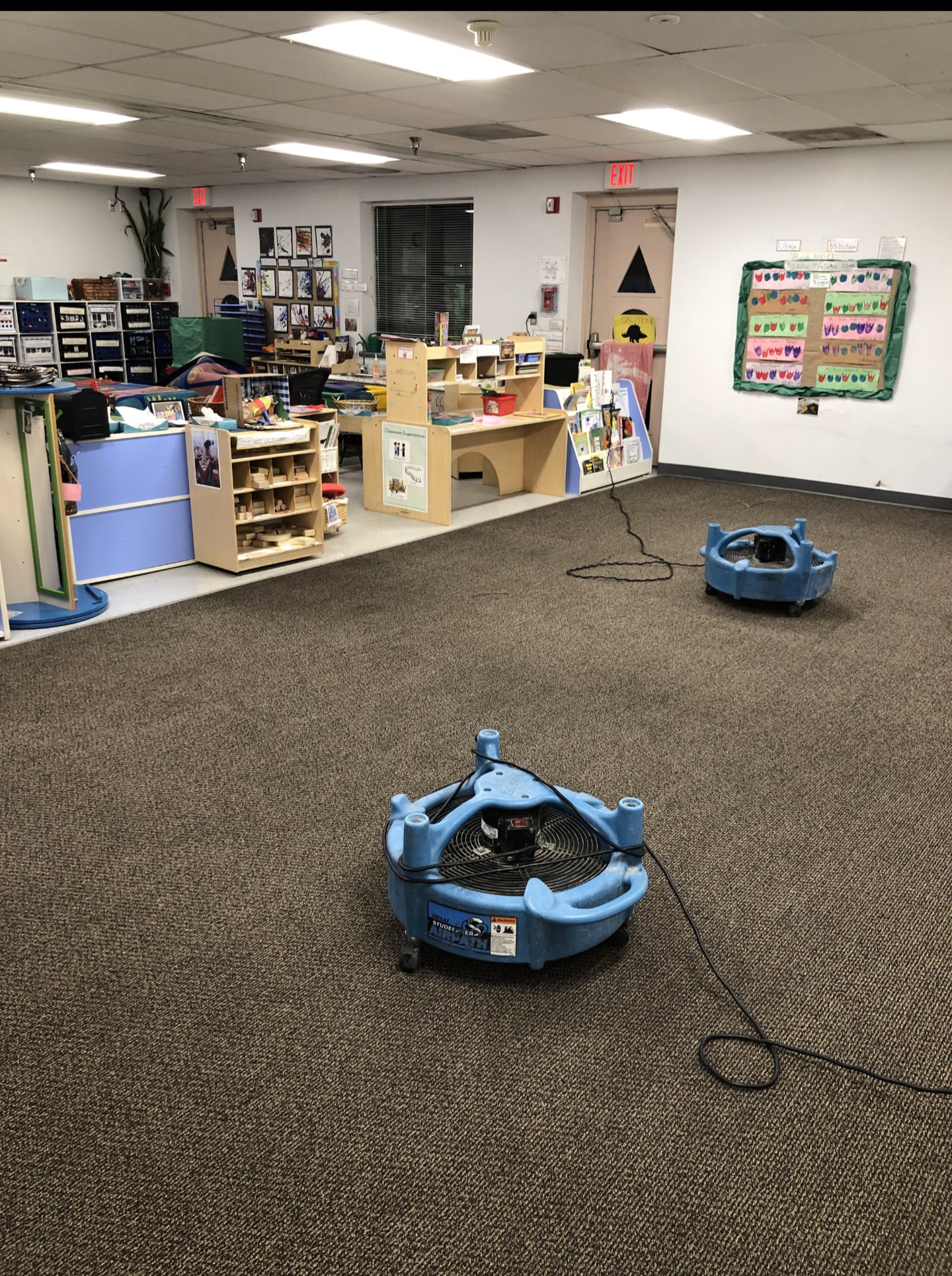

I've done both, the vlm came out great there was no way to run hoses doors locked government facility.
Would've been 350 ft run easy
Basement area that would have been swampy.
My commercial jobs dry fast!

Are you running weights on the Vibe? If not, you should… the cleaning difference is big.

Okay. I don’t. One weight? Enlighten me. What about friction?
Orbot sells a weight kit for it. The problem with your machine is it only has about 35 pounds of head weight, which is about half of the Trinity machines of comparable size. Head weight to VLM is like psi to HWE. So even if you put the entire weight kit on your machine, you’re going to be just above the head weight of competing machines.
Think of your machine with no added weight as cleaning with a wand at 200-300 psi.

If I sold those machines, I would practically beg everyone to buy the weight kit. When I first got an Orbot, I thought it cleaned like shit, and then I learned about the weight kit. Problem with the kit is it pain in the ass to put on and take off, so I just left my kit on, but it made the machine weigh almost 150 pounds.
