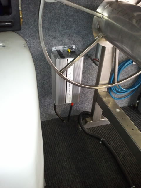

Mike Draper
Jan 13, 2008
4,402
You could install an inverter and easily run the pump out and other things off of it.
dgardner
Apr 7, 2008
5,109
Phoenix, AZ
Dan Gardner
Ah, an inverter still draws power from the battery, and since they are all less than 100% efficient, will draw even more amps for the same amount of work.
