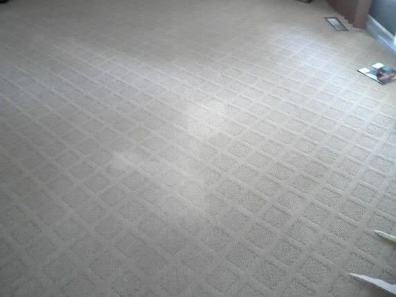

Cleaned a motor home and a house for a client a couple of weeks ago. Black Death struck in the living room. I remember guys talking about it ..."stick the solution line in the vac hose"...nope, I ran to the truck to shut the pump off. When I come back inside I am surprised to find the black splatters on a leather sofa, end table, table lamp and wall. There are also 2 puddles where the solution line leaked on the carpet.
I extracted as much as I could, ran a new solution line and got the black residue that was in one of the puddles cleaned up. The rest of the mess cleaned up well except for a lamp shade. The shade had a coating that reminded me of paper mache, it basically started to disolve as soon as it was damp wiped.
The client was away at this time so she missed all the excitement!
When I wrapped up I called her on her cell and explained what had happened, I took $50 dollars off the invoice to compensate for the damaged lampshade. She was cool with that. Several days later she calls to say there are a couple of lighter spots in her carpet. The light spots appeared where the solution line overwet the carpet.
When I arrived to re clean the custy asked me "Jim, worst case scenario what happens?" I told her I would replace the carpet. She also pointed out that they have a new tv, she said the screen on the old one went all green and red the day following the carpet cleaning. :shock: I asked her if she thought the tv not working was related to the black death incident. She was not sure but was going to get someone to have a look at the non functional tv.
As soon as the prespray hit the carpet the shading blended in with the non affected area, but when the carpet dried the color loss was apparent again

I'm not getting the color loss. I've seen Cyclone and other spotters do this to similar carpet, but disagree that it would have been affected by water alone. Maybe you can mist a little blue dye on the spots?

forgive me for asking this, but is it "possible" that the lighter areas are just a "very" clean spots?
What juice are you using thru the TM?
is that a wool berber or synthetic?

Someone explain how a solution line leak causes color loss. That doesnt add up to me.
No clue as to how that happened either. There were 2 areas affected, 1 of which was treated with a high alkaline spotter (to get the black goop out), the other spot was not but the color loss was equal in both spots. I thought maybe something in the backing wicked up but after repeated vacuuming and cleaning there is no difference.
The shading is very consistent through the room so I don't think that is the case.
Prespray was Trashed Green with a mild mix of PC Dry Slurry through the wand.
Not sure what the fiber is but this makes me think nylon.
That was My thought especially on that style carpet.
A large amount of hot emulsifier can leave a clean spot that cannot be duplicated by wand cleaning no matter how many times you clean it.

do a bonded insert if you cut it right and set it good the problem is fixed for a cheaper price and the custy dont have a beuty mark looking at them all the time
