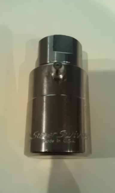

Super Swivel is the standard for a reason.
Get the zerk installed and keep it greased and it should last you quite a while.
