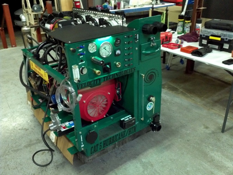

Charlie;
Here's a couple of pictures of the Escape ETM we just received:
New General Emperor Premium Pump -1000 PSI
Quad Vac Motors with 16.6" hg lift 260 CFM
New Aluminum Louvered Covers all the way round to reduce weight (195#) and enhance cooling.
Vac exhaust now directed out the rear of machine.
Sump Pump Pump-Out (90 GPM) with 1.5" Quick Coupler & Hose.
Electronic float control of entire machine.
Saturday it goes head-to-head with 16HP #33 blower TM.
Larry
