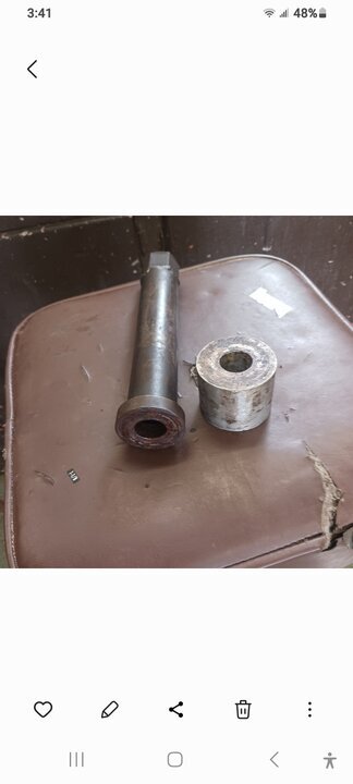

Ya Lee....ya gotta drive the new bearing in place by laying the old bearing on top to drive it home....but you knew that..!
This is what i use to replace the bearings in my driveshafts. The aluminum spacer allows me to install bearings without removing the clutch magnet saving alot of time
