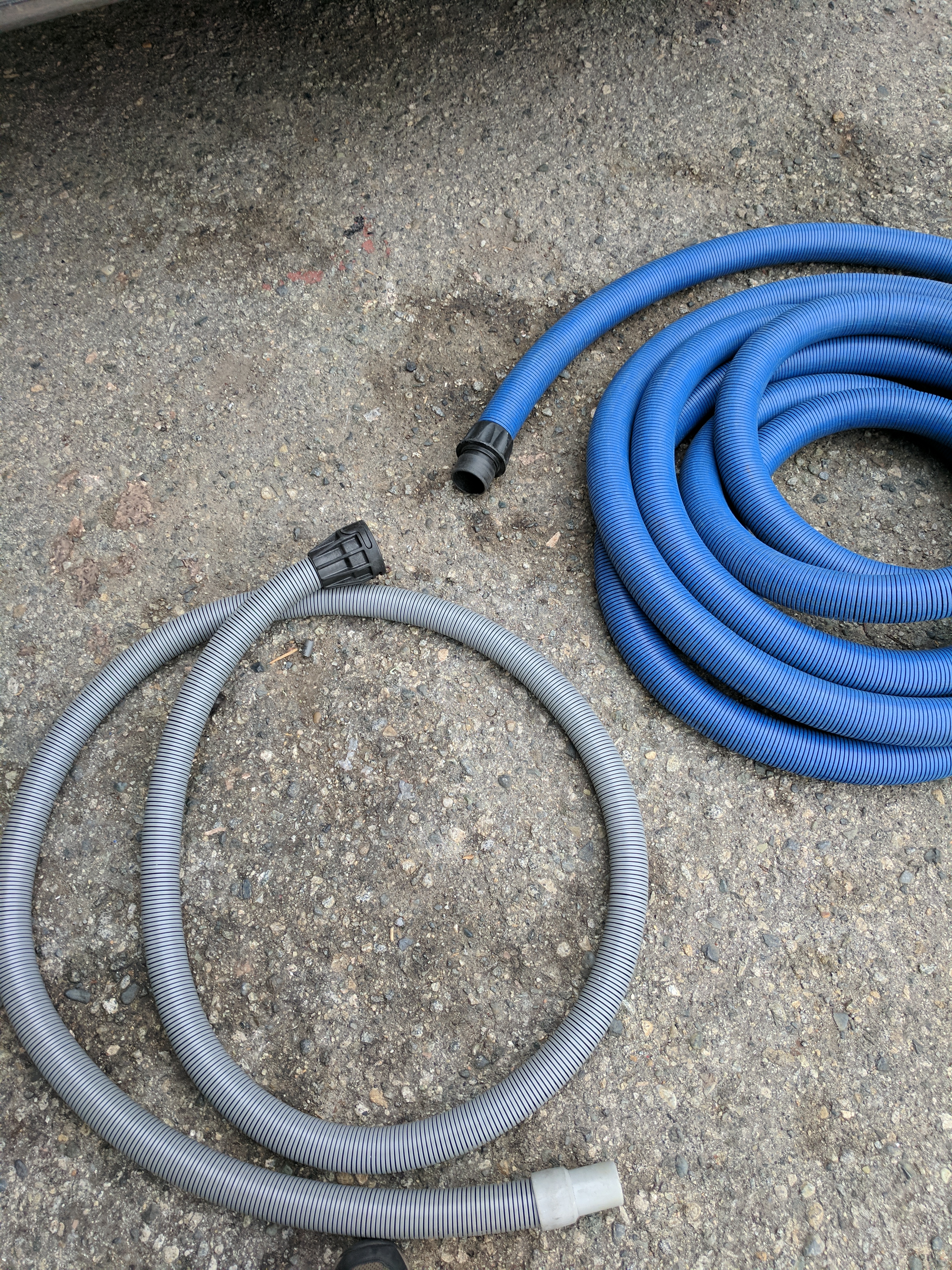

If I had to use a 1.5 whip. I would get a custom hose from Amflex. 50 foot 2” hose taper down to 1.5.

Thanks, I’ll let you know. I’m going to try the 2” to the wand. I’m not too worried about the balance, I just want flow.
I have run 2" to the wand for the past 20 years, and I can show you a more flexible 2" hose that goes to the wand the last 25', then I use a 2" to 1.5" hose cuff to the wand.

I seriously don't understand why 1.75 never became the industry standard?
1.5 cuff slides nicely inside and 2 cuff slides nicely over.. and girly men won't get the arthritis
It probably has something to do with the pipe diameter of 1.75" pipe costing more because it isn't as popular as the 1.5" and 2" pipes within the industry. The increase in size between the 1.5" and the 2" is greater than between the 1.5" and the 1.75".

It's not easy, all the tools, wand, Zipper. Stair tool, upholstery tool are all designed for 2 inch. Added a tool the requires a whip just complicates something that is already easy. 😤

You hang a short whip in the truck. Easy peasy. I switch back and forth all the time. Today I'm using a 2 inch wand testing out my new used truck mount, until I have to do the stairs. Walk back to the truck and grab the stair tool and a whip hose, which has a flash cuff reducer so it connects easily to the main vac hose. Most of my upholstery tools are 1.5 as well as my stair tools. Zipper and rotovac are 2 inch. It's so easy to switch back and forth, I don't even notice when I'm doing it.

I dropped the ‘whip’ 2 months in, and never looked back.
I did a job today, 425’.
I think if I was to run a whip (8-12’), I would have had no suction....

I'm thinking about just using this 2"-1.5" reducer I just found and connecting 2" inch hose to it, since I don't have the whip, or any 1.5" hose.
There's actually a youtube video of a guy using a whip and then connecting 2" directly to the wand via the reducer. You could hear the difference for what that's worth.
I honestly have never minded 2" to the wand, but I also go potty standing up.

The 1 1/2 dev wand with out the whip has tremendous suction it’s a beast

I have dedicated whip hoses on each tool that requires one, namely turbos, stair tools and upholstery tools.
When I get the Devpro, soon, it will be 12x1.5 like the loaner. I prefer 2", but the 1.5 dazzled us. I also had issue with the tapered hose and will instead make a whip like Mike showed in the video.
