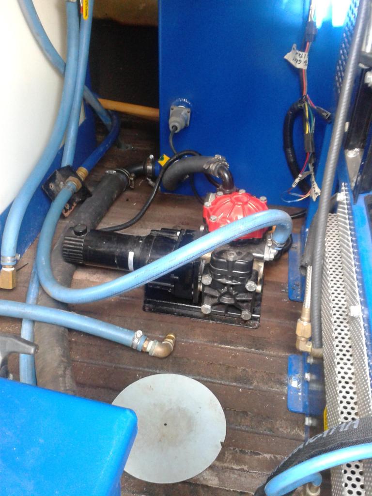

This APO came with the Thermalwave, and I need some maintenence info and maybe a manual download? Are there filters to clean? Do you change the crankcase oil often?

I believe that's a Hypro D50. Manual available on Hypro's website, lots of how to videos on YouTube.
Edit:
Not a D50, it's the smaller one, the D30. Sorry.
Reactions: rwcarpet
I have one them somewhere. They kick butt as long as you use it regularly.
Just don't let the sludge buildup and you'll be fine. I'd also stock a diaphragm or two!

Use a 5/8 wrech I think and take off the two nuts on top of manifold, clean out the check valves, lint and crap will be in there. Make sure they go back together the same way, springs, disks, cages etc. Maybe replace the diaphragm, change the oil, pump oil is fine

The only thing I found was the springs will get hair and such in them and keep it from working properly

Don't maybe replace the diaphragm definitely replace it. They break and then the sludge floods the bearings. Ask me how I know. I believe it's supposed to be changed every 500 hrs.

Thanks for this post. I have one in my Vortex and it's not working. I didn't use it enough and sludge built up inside it..
Any suggestions on a filter I can install inside the waste tank to keep some of the sludge from getting inside the APO port?
