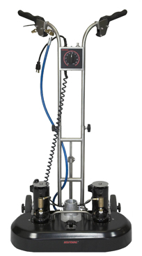

Would you like to test and evaluate a Rotovac Wide Track? They would count on you to provide (valuable) feed back on it's pluses and minuses after you've used it in as many cleaning scenarios as possible. One time at you own home isn't going to do any body any good, you need to be serious about this testing. Take it out and clean as much as possible with it, worn to hell olefins, carpet tiles, grease pits, velvet's, plushes if you can find enough of it and so on and so forth.
They will pay for shipping to and from your place of business. If you fall in love a big discount will be offered.
PM me if you are interested and feel you are qualified.
Dual Wand Cleaning Speed with One Man Operation.

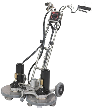

The new Rotovac Wide Track is a 24 inch wide Rotary Extraction tool for high speed cleaning of large areas. Dual rotary jet extraction cleaning heads utilize six vacuum slots and six spray jets to produce thorough, restorative cleaning. The cleaning heads spin at an adjustable 0 to over 200 r.p.m. The Wide Track operates like a lawn mower and cleans equally in both directions up and back. Designed for use with any truck mount or dual 3 stage portable, the Wide Track delivers all the power of your extractor while requiring only one man to operate.​

The ergonomic dual handle design in combination with the high torque drive motors makes the WideTrack extremely easy to push as it power cleans through heavily soiled areas with ease. The high speed cleaning power of the WideTrack can cut labor costs by up to 50%.​
Power Extraction Cleaning with Ease
The Rotovac WideTrack takes the backbreaking "wand fatigue" labor out of carpet cleaning. Dual high torque motors along with a comfortable ergonomically designed dual grip handle team up to make the WideTrack extremely easy to operate and maneuver.
Variable Head Speed Control
The WideTrack is equipped with a variable head speed control dial which allows the operator to customize the head speed from 0 to over 200 RPM. This feature allows the WideTrack to adapt to a wide variety of carpet from commercial glue downs to plush installed over pad residential carpeting. Glue down carpet may require a slower head speed for smooth operation and maximum recovery while installed over pad plush carpeting may need a faster head speed for best results.
Works with any truck mount
The WideTrack is airflow calibrated and high pressure plumbed to operate with everything from small 3 stage carpet cleaning extractors to the largest, most powerful truck mount systems.
Here's how it works:

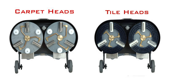

The Rotovac employs a process of Rotary Jet Extraction cleaning (patent pending). Each cleaning head has three spray jets with three 2" vacuum slots. Dual high torque gear motors power the heads in a counter-rotating motion to produce up to 1500 rotary cleaning passes per minute.​
<center style="color: rgb(0, 0, 0); font-family: Arial, Helvetica, sans-serif; font-size: medium;">
</center>Features:
  • 24 inch cleaning swath
  • One machine does the job of two operators - cut your labor in half!
  • Ergonomically Designed Dual Grip Handle
  • Adjustable Speed Control Dial 0 to over 200 RPM
  • Stainless Steel Telescoping Handle
  • Dual High Torque Gear Motors
  • Carpet Pile Height Adjustment Wheel
  • Guaranteed to improve your cleaning

It looks like if you use it like a "lawnmower" it would leave 1" dirty strip down that middle of your pass.. It would be cool if they figured out a way to overlap in the center. Maybe shape the heads like a gear or something.
San Francisco, CA
x2
