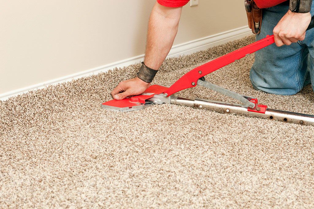

Just wear. Probably not power stretched when installed. Warm bath makes it relax. Usually it goes back when dry but if not, the customer needs to have it restretched band their expense.

Residential nylon, over pad..
You can quote this, scripture and verse, as to how that installation should have been done, and likely why this is happening
