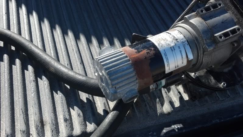

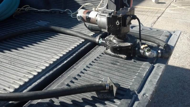

It's bigger than I thought, it's the $1,500.00 pump out but I'd sell it for $400.00 cash.
$500.00 if you want a 30-minute warranty!
or Pay Fred $50.00 to can Connor! :p

Thanks Richard.
I actually have the same Prochem APO sitting in my shop. I was supposed to be sold with a legend on eBay but the deal seems to have fallen through. Let me test mine and see if I can’t get it going. I may still take you up on the deal.
Jim’s post about the location of the float makes since. I use a float switch for made for sump pumps which never fail. I will try moving the switch higher in the tank and see if that helps.
No problem! Need anything else? I got a lot of chit just sitting around.
