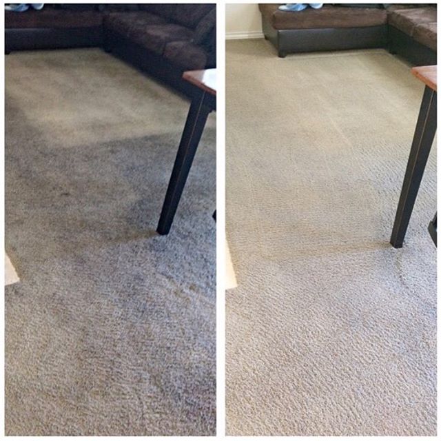

Take this recent one in particular.
hostafter-jpg.18812
Sure its dramatically different. Sure the home owner pee'd themselves when they first saw it.
But my anal retentive, 30 year's of experienced eye sees lots off DEEP soil still there. Many on the board won't see it and those that do wont say anything but as your friend I feel I owe it to you. A truckmount and an RE ran over that would be nearly as dramatic a difference again.
You may not believe me or you may just hear those dollars of truckmount maintenance, fuel usage, more gadget costs, training headaches, break downs etc fighting off my suggestion like and want to ignore me or call me crazy but HEAR ME OUT!
Will. no amount of pulverizing, jiggling, twirling or agitating is going to bring that bottom layer of soil up IF YOU DON'T INVOLVE REAL WET EXTRACTION.

Mike, I see your point, but also realize that Las Vegas is one of the most transient cities in the US. The turn over is insane and people want a low price point.
I'd love to know how many of Will's clients are repeat or how many are one and done. It's it's own niche and if he is doing a lot of one and done due to the turn over, then his method works just fine for that. He's getting results that the clients are happy with at the right price point and he has an endless stream of clients due to turn over. I agree HWE would be better, but if this is working for him and he found a way to make it successful, then let him keep at it his way.
Will - do you see a lot of repeat customers? If you don't, do you want them? If you do then Mike is on to something. If you don't, then keep doing what you're doing.

Since the results of wills encapsulate are nothing short of Amazing on the surface and much lacking in the undergrowth what do you attribute the problem to? Does the encap not penetrate the tops of the carpet fibers and therefor have triple strength at the surface and nothing below, or is there a problem with the system of spray, scrub, bonnet, groom?

The deeper soils need to be penetrated. Encapping lays the fibers over on each other not allowing penetraion to the nap.
Those soils also need stronger product because they themselves are already concentrated
Using a brush instead of bonnets as a first step helps as it does with hwe but I often prespray again after cleaning an area I see those shadows. It's why I charge extra on trashed carpet.
And how come nobody ever offered me a truck mount knowing I was running a bane?
13,372
Hek a crb with the right product will dig all that crud out then hit it with bonnets.
I'm just shaking my head..
Let me suffer for ten years geesh

I've given into your to your theory over the last couple months. I know we need a TM in the very SOON near future. Especially for Tile. I've been looking at some of the new/used plans through Butler Financing. I looked on craigslist but am sketch about those. I don't know what to look for when buying and don't want to waste 7k on something that could 2 days later, blow up on me. Not knowing how they should sound, look etc. Just another excuse in getting one yet. My plan is January to begin the actual process of buying. I don't advertise tile enough right now, because it is such a pain in the ass to do. So you are correct there and I will be flying you down when I get to this point. I'll use my comp dollars for a good room for ya. :)
Two things on this subject: I would only use HWE on filthy BLACK dirty carpet. VLM will still be our main carpet cleaning. I would offer HWE only as secondary. In no way do we want to be known as another Steam/HWE cleaner in town. I've only had 1 request in the past from a commercial building asking for steam cleaning. Other then that, we want to still STAND out from competitors with the Dry Carpet Cleaning. Second: This means I'll be adding debt onto the business. (understandable this will be necessary to grow). Debt.. Something we haven't had because you are right. VLM is an affordable way to begin cleaning and you can grow it pretty quickly. Paid everything in cash. 10k to setup 1 truck for 2 guys to run. Easy enough to where we have 3 of those now compared to 1 truck mount and van. My credit is shit. When you can't get loans easy, entering this business VLM style is also more affordable. Just from being on this board I've had calls from cleaners around the country that are HOST/Encap method only. I don't think VLM will be going away and will become more preferred by home owners not wanting wet carpets, stains reappearing, etc. (sorry that's my only HWE dig). :smile:
From January 2016 to today, we have cleaned 1,200 homes. 970 of those are new customers 230 are return.
- Vegas is very transient. People are moving out of state all the time. Home owners buying staying for a few years and selling. Renters renters and more renters. There are also half the city not willing to pay $$$ to make dirty dirty carpet clean again. People with this carpet are usually low income renters. Over the last 2 years we have moved away from these by raising prices and have been doing homes in the zip codes that we want. High end has been growing to this last year 6 hours with 3 guys for $3,000 cleaning already clean Wool Drapes, Wool Carpet, Leather, Upholstery, Rugs. This has been helpful in growing from rich guys secretaries whose friends used us and mentioned us on Facebook or else where. And commercial is moy bueno! So another reason you see it is hard for me to believe that HWE is a better direction to move into.
Carpet like in the picture above that has heavy traffic, after we've cleaned it, I can go back into the home 8 months later and see traffic lanes barley starting to form. Promise that is not a lie. lol These places really do stay up well after we have cleaned them. I'm not sure about the comment with dirt rising back in a week and a lot of it. Most of our customer comments say how long the carpet has stayed clean after we did it. I've had only 1 phone call in all 4.5 years in business that the carpet became dirty or sticky a few days later. It was because the tech didn't use enough HOST. As long as they didn't use a rug doctor or some cheap 2 room for $39 dude, the carpet does well. The second time around is even easier to clean.
Many HWE cleaners have a bad name in this town. There are so many and people associate "HWE and Steam Cleaning" as having their carpets soaked again, stains re-appear a few days later, bait and switch type guys coming to their home. That is why we have been able to do so well within our market. "Dry in 1 hour" "Eco-Friendly" and the retirees really do love talking to our guys. Young customers love the process and have been very high on referrals for us.
Expect NaturalDry to have a TM beginning 2017 then you can turn me over to the dark side.
Heavier soiled carpets are going to need more product. Spray more and grind more in.
As far as residue, the company line is that the "sponges" keep working gathering more soil until removed during regular vacuuming. :biggrin:

I think Will has his system down as long as his guys follow the proper format. Hwe will be a nice option especially for large tile jobs. Where people go wrong with vlm, is they only do a portion of the steps. For example, a building that I do the hallways in had always been cleaned by someone using host. Regardless of what they may used as a prespray, if any, they were not removing the Host powder. You could spread the fibers and see compacted Host powder (or sponges if you like) I brought along a certified pile lifter to vacuum the carpets with and I started by the managers door. She came out after about 10 minutes of vacuuming and exclaims, "Wow, the other guys never got the carpet this clean". If I was smart, I would have finished vacuuming and collected the cheque. Instead, I explained that we were just vacuuming and we still were going to steam clean the carpets. After the job, she was really blown away. Using Host on commercial carpets like this can produce amazing results but you have to follow all the steps and the last one is vacuuming the Host out. Sounds and looks like Will has that down pat.

Isn't that what the pre and especially the post vacuum is all about? My understanding is that the the remaining soiling is encapsulated and then a post vacuum when dry is necessary to remove the encap+soil.
When you are using the crb doesn't that bring the encap down the fibers and the loose soil up the fibers to be wiped away by the follow up bonnet and all layers vacuumed away by the follow up vacuuming?

John is correct.
Lots of soil left down at the roots
What is the reasoning for the soil left down at the bottom? Is there a flaw in the chemistry that doesn't allow the encap down to the bottom of the fibers? If you pre vacuum the carpet 80% of the soil should be removed. The remaining 20% should be touched by the encap by either the crb scrubbing the carpet or the bonnets describing/wiping the dirt away. Then there is the post vacuum that should take away the remainder. Now I can see if the full process isn't being followed that there would be significant soil remaining. But if the process is followed correctly what specifically is the shortcoming?
