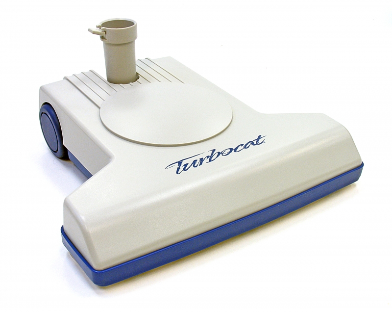

I have no idea why you guys use these portable vacuums that have virtually no air volume when you have a hose that could be hooked to a vacuum agitation head that would really pull the dirt out of the carpet.
Ever thought of using a vacuum head designed to be used with a Central vacuum hooked to your TM?

yep and they blow apart in a few uses
spins way too fast
9,756
Works good with a HEPA tank vacuum but on a TM...damn. Just damn! :eekk:
Scary mommy scary!
I just started using a back pack vacuum with the turbo cat.... Works get and doesn't sound like it's going to break and fall apart.... I'm just too lazy to Strap it on my back and actually use it... Them things are heavy... I can see why janitors like them...

They make the heads that are electric, not air powered. Or the electric powered head from a normal cannister style vacuum.
28,273
We have used our tm to provide suction for a certified pile lifter. Works fantastic but you need hepa style filtration to avoid dust getting into your blower
