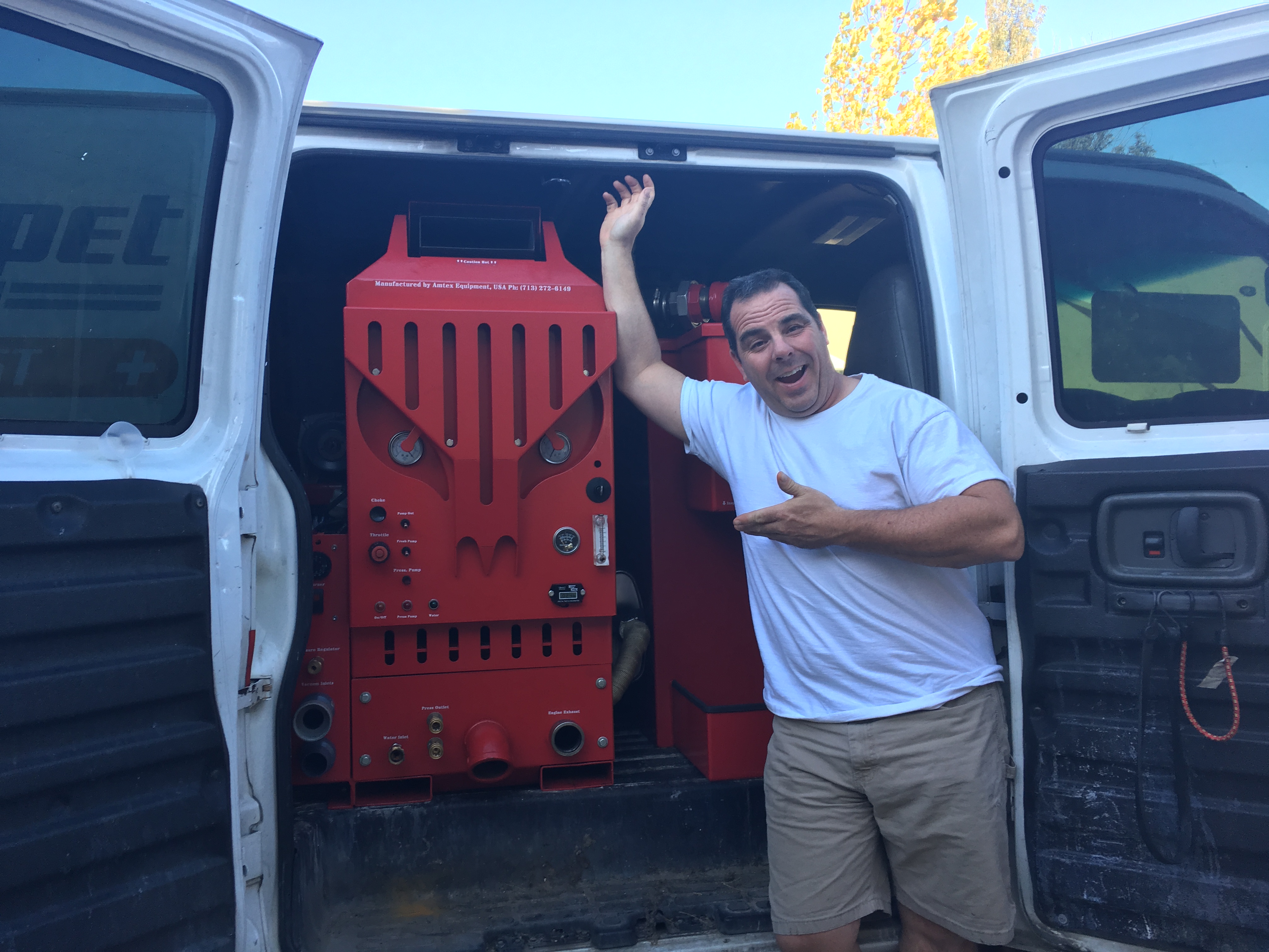

You can borrow my 2001 Express 3500 loaded with an Amtex Dragon.
