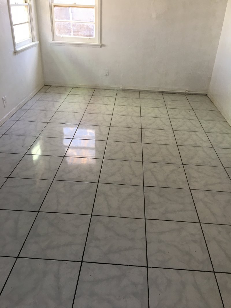

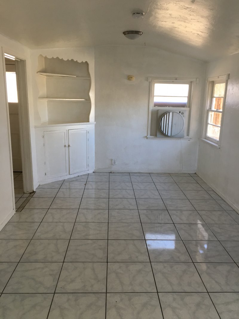

This small little 600 sq ft house the cat urine smell is atrocious. Lady wants it fixed so she can rent it.

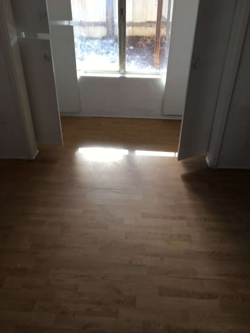

Appears the odor is in the Grout, I don't think it's in the wood or the lamenant wood have more edge lifting.
Any suggestions besides run.

Sam, mop it with a nuetral cleaner, then immediately follow up with a generous application of Unleashed Unduz-it enzyme stuff. About $30/gallon from whoever sells it locally, but it is advertised on MB too.
You MUST douche out under, behind and above the baseboards. Expect a LOT UNDER THE CABINETS. Don't be surprised if the urine has run under the laminate and warn your customer.

What's the urine like light showing? Is it sprayed on the walls also?

Don't look past the laminate.. It can look great on top, but it will sit in between that and the subfloor!!

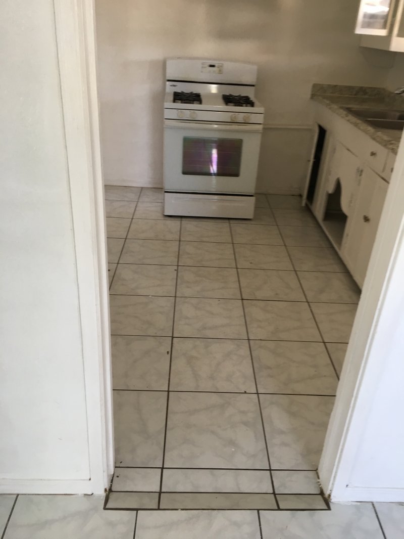

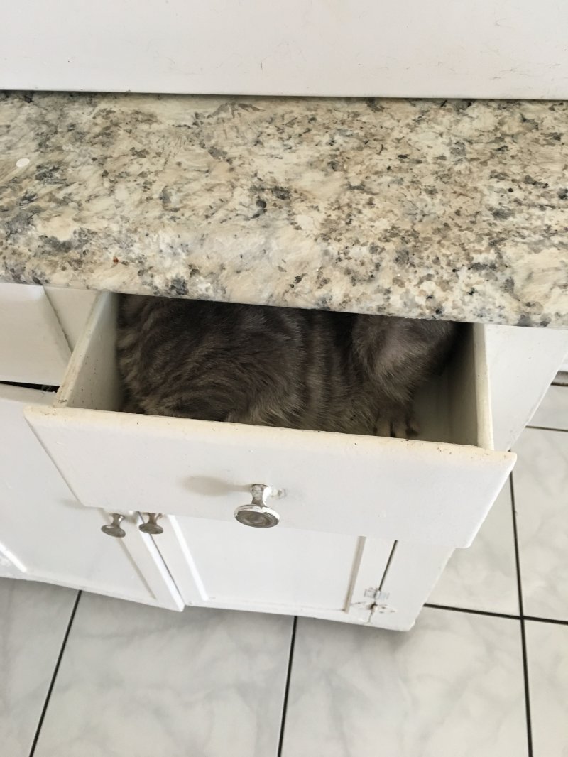

I moved the stove back and forth and out squirmed this feline up under the sink to only reappear in the drawer.
I knew a cat had gotten in since my last visit since there was fresh pee and a few dropping.
