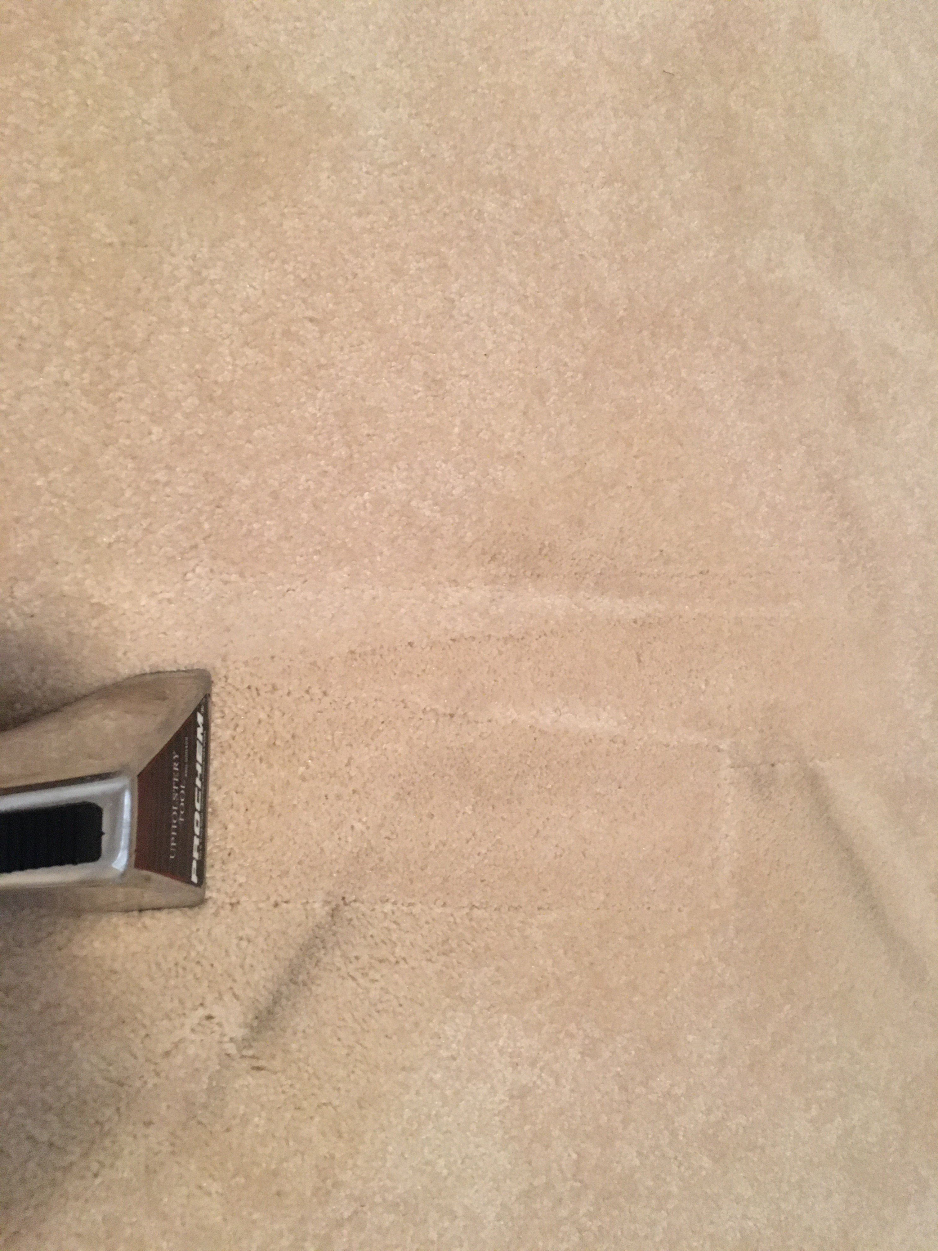

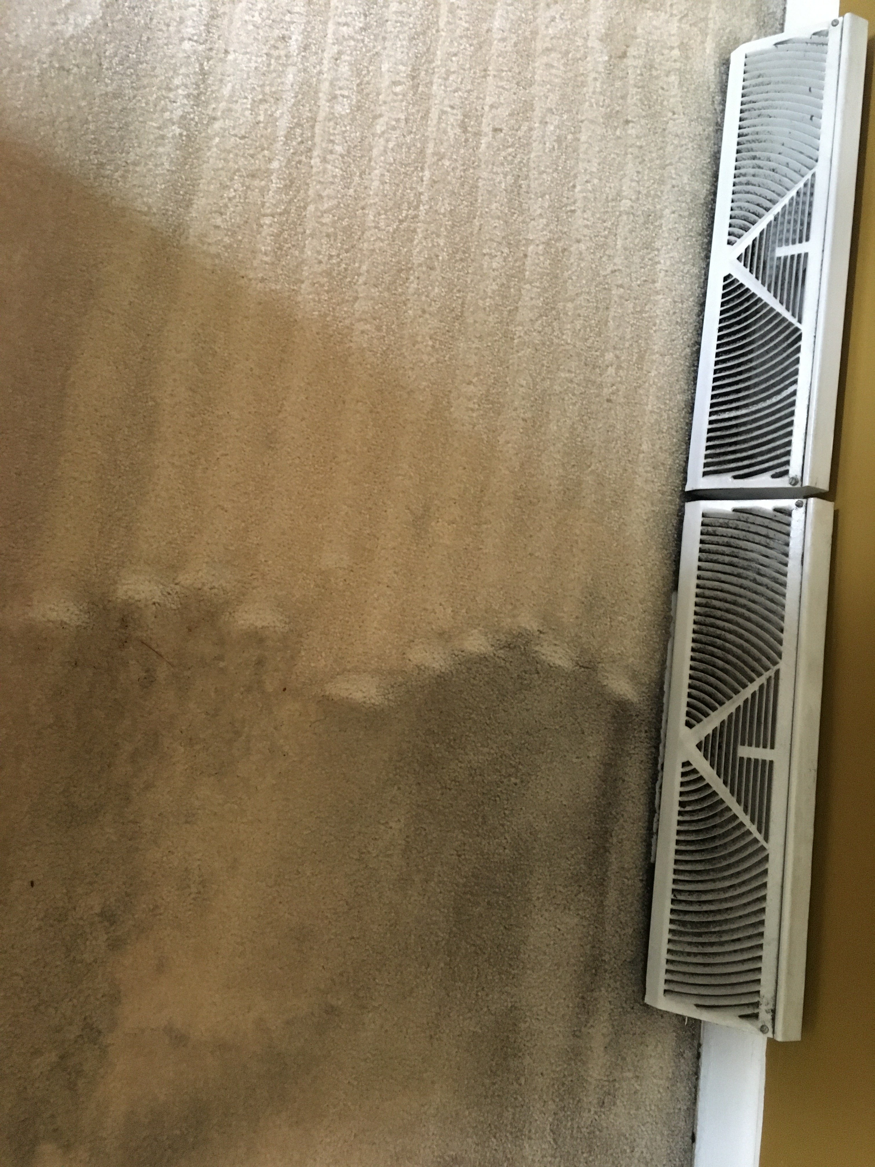

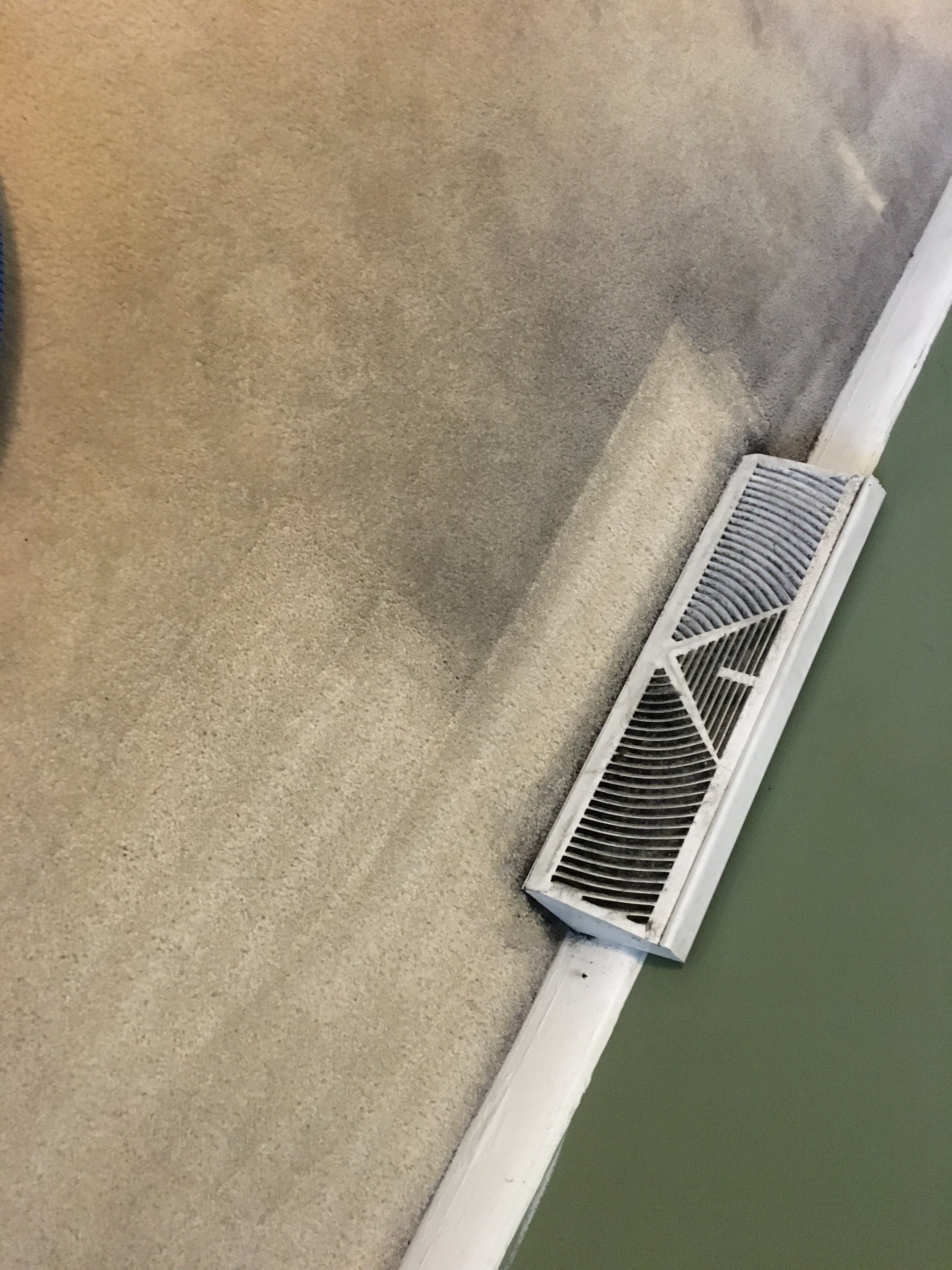

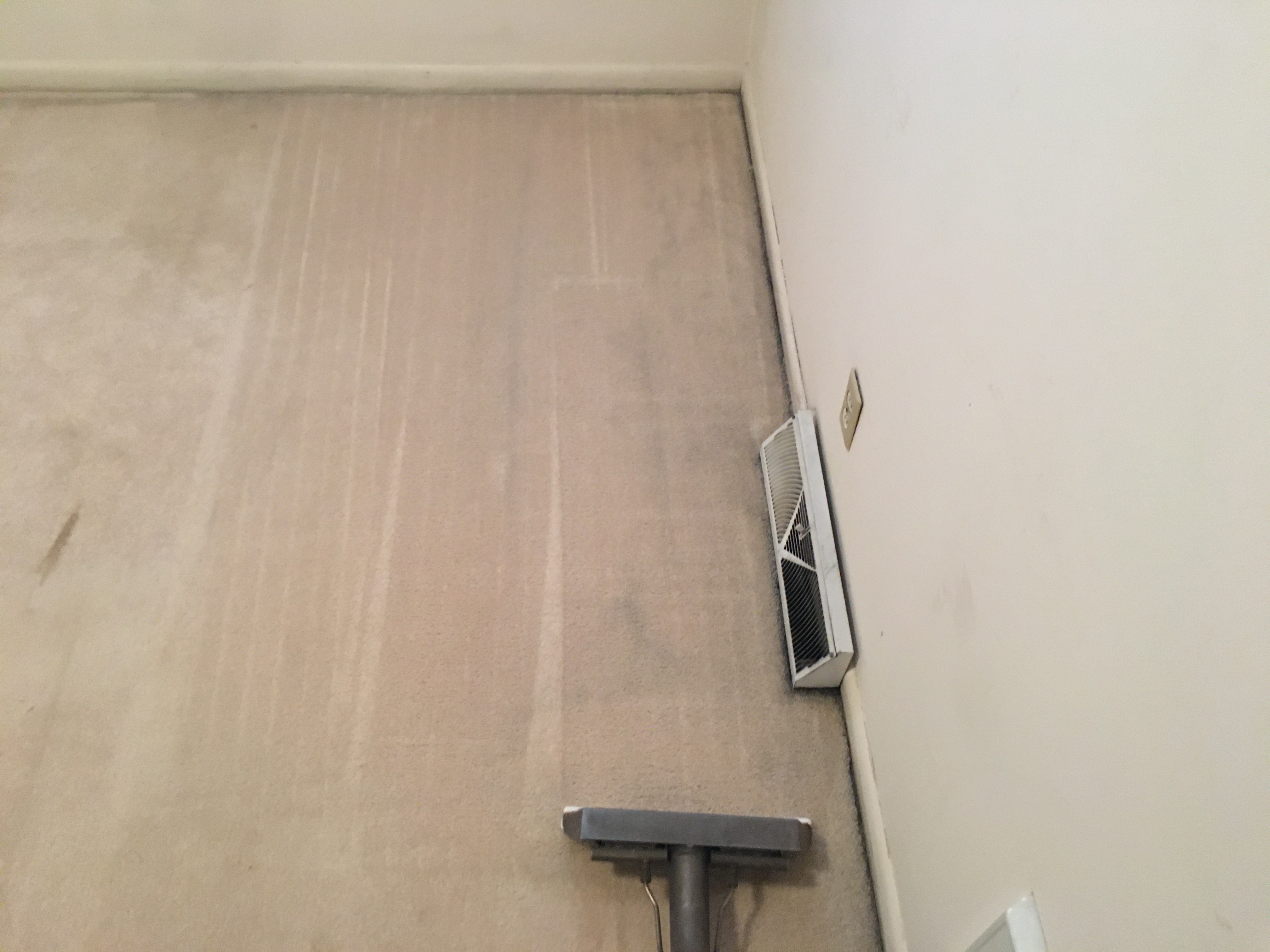

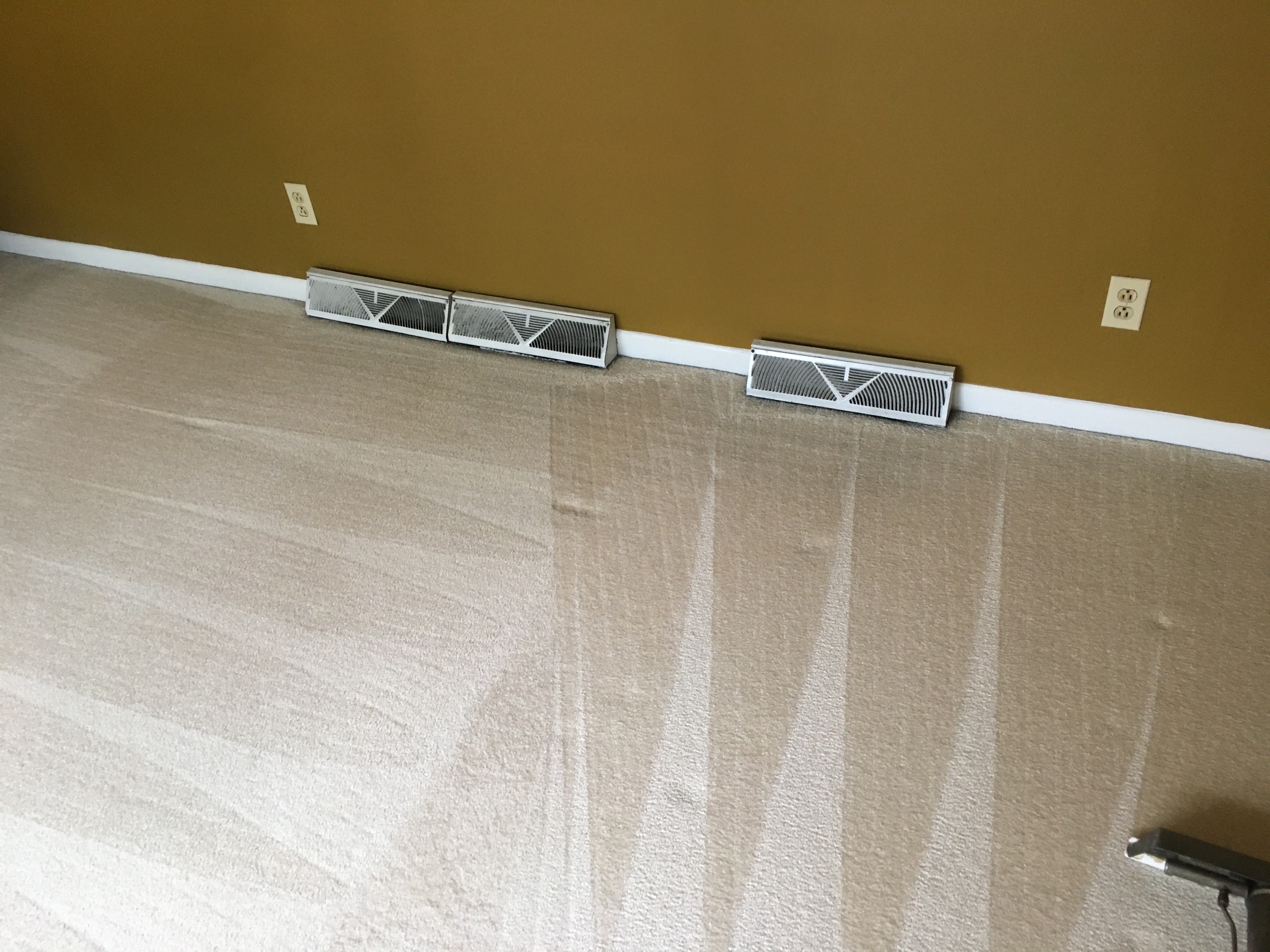

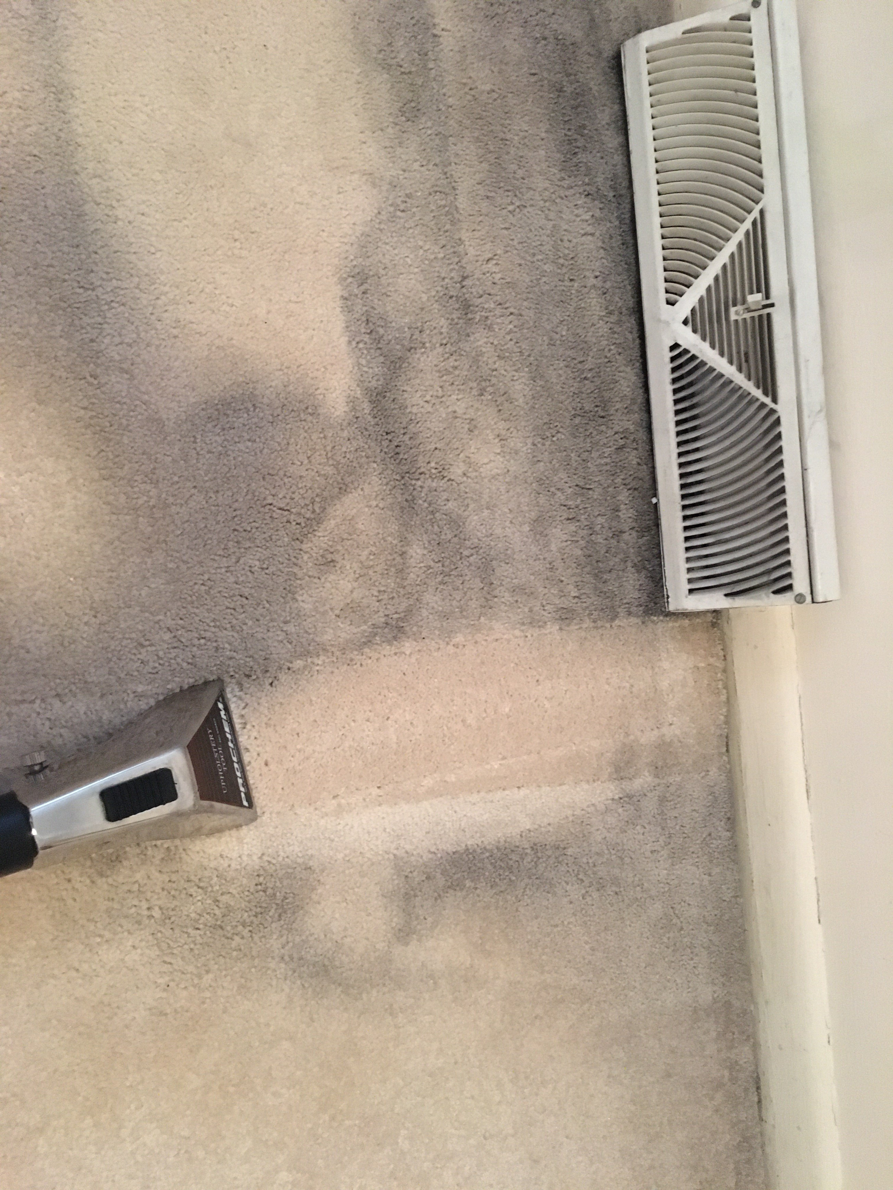

I ordered a couple gallons of this a few days ago and I scheduled this job for next week. I'll post the results next weekend 🤞
14,632
I’m very pleased with Prochem ultrapac renovate
It didn’t come out perfect, but it was presentable
