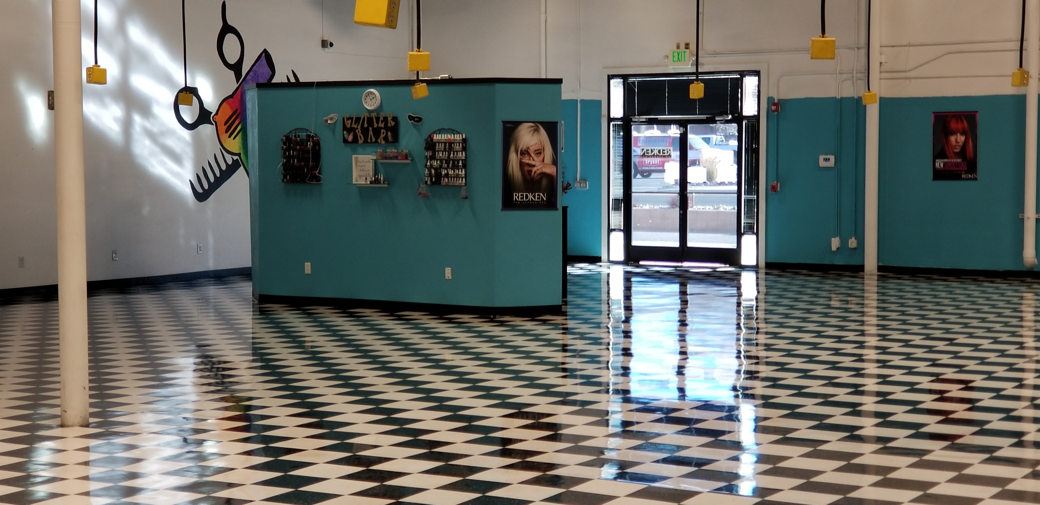

No fans, the exposed HVAC is filthy dusty..

Thats rough... makes me tired looking at that.. be nice to have the propane stripper and autoscrubber... Be done quicker..

Auto scrubber yes, hardly anyone uses propane strippers anymore.
I thought propane stripper was faster and more aggressive to strip and autoscrubber for cleaning after it.
10,223
Yes you are correct, but unless you’re doing a large grocery store or larger, there’s not much need. My buddies used to use them, but hardly now. Kinda like Quigley said, “ I sai d I had no use for em, didn’t say I couldn’t use it”.
Reactions: DAT
10,223
Ok whatever. I’ve been doing it this way for 30 yrs. but you drag the dehu. I’ll use Patton fans. Especially when they’re telling you we have mass in 45 min. You learn to dry em.
13,372
Pretty sure most sealers say do not use fans to dry.
I thought it was for leveling.
I use them but I give it about ten minutes before I turn them on.
28,275
I use fans to speed dry but I point them up from the floor on low. Just to increase airflow. Drying time is 45 minutes to 1 hour without fans and about half an hour with.
13,372
Every coat was dry in under 20, why take the risk?
The directions on the product I use says to let dry an hour between coats. I wait till its dry to the touch or almost before using the fan. It helps with low spots and corners that may take longer to dry.
20 to 30 minutes between coats usually for me. I have rushed it and reapplied after 15 minutes or so too.
