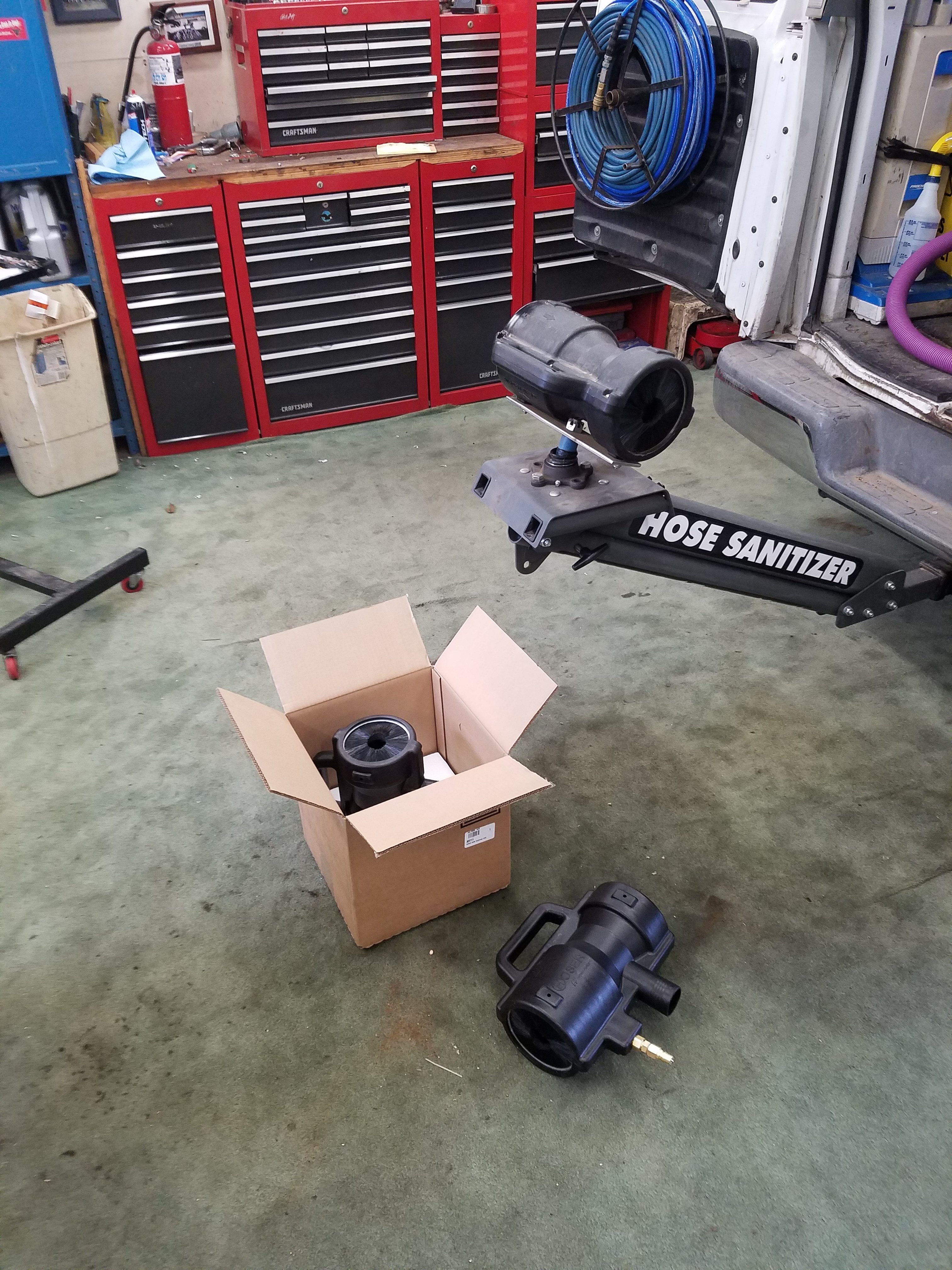

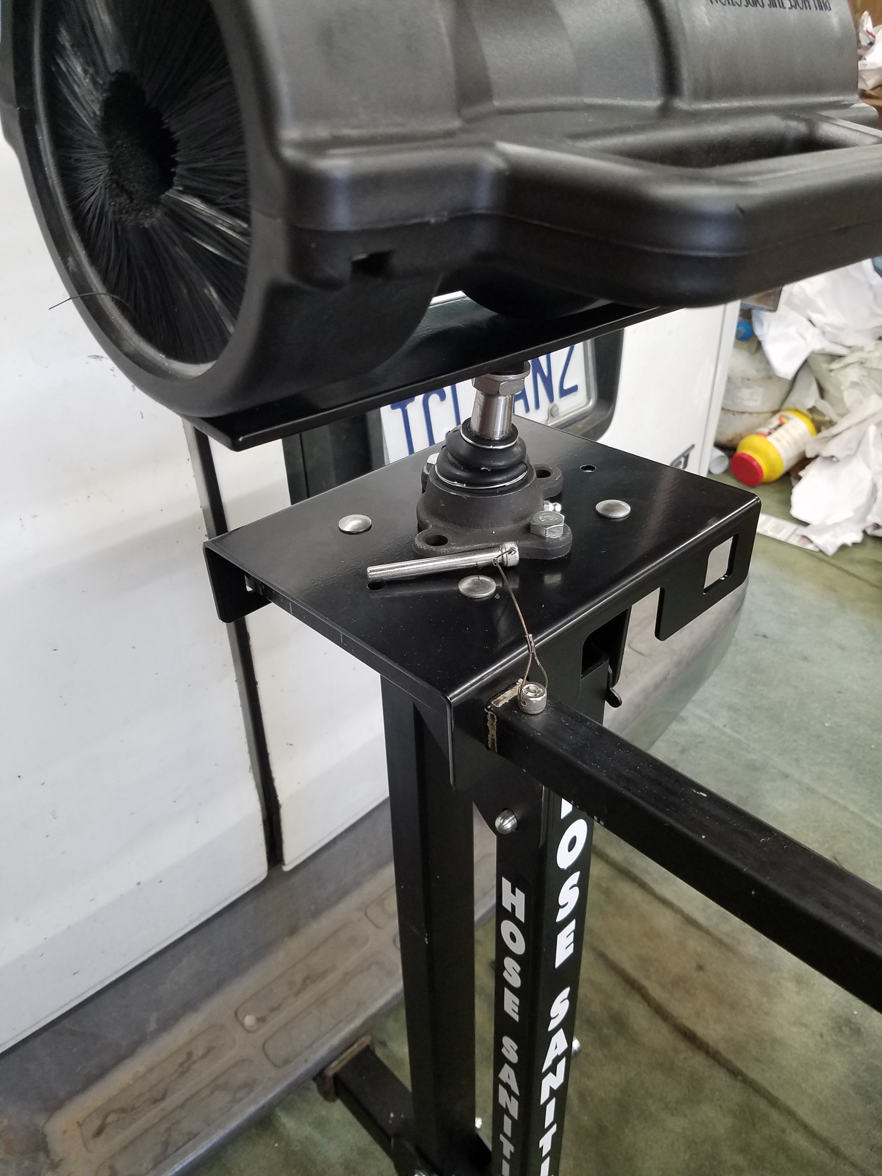

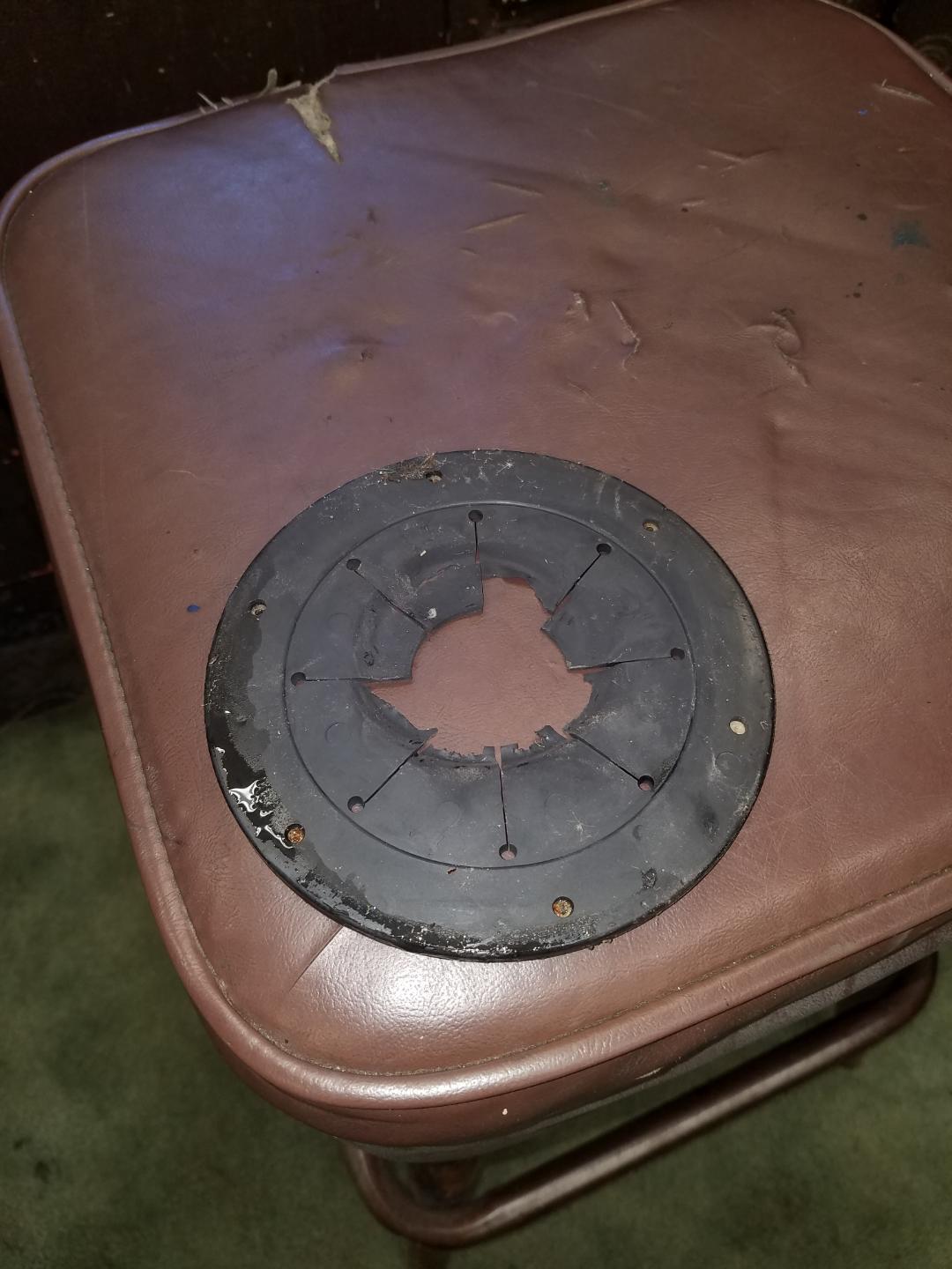

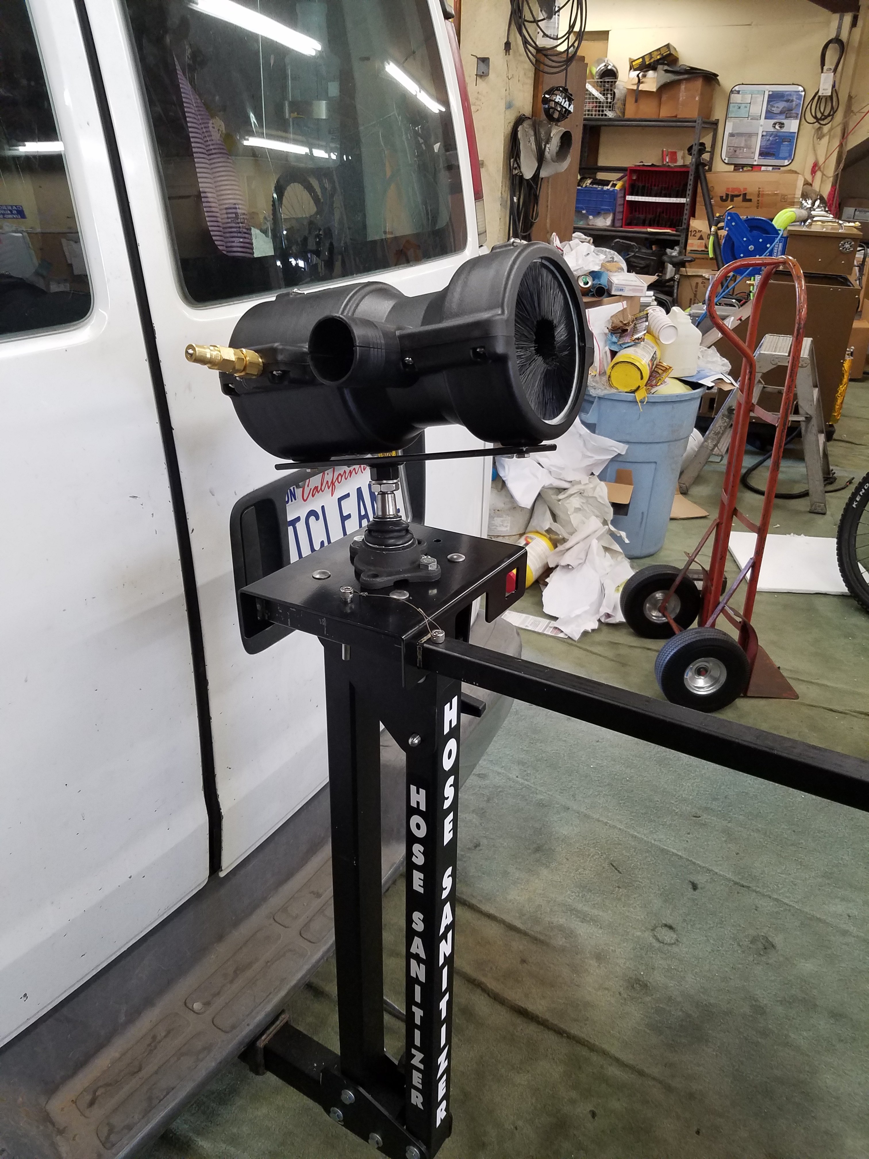

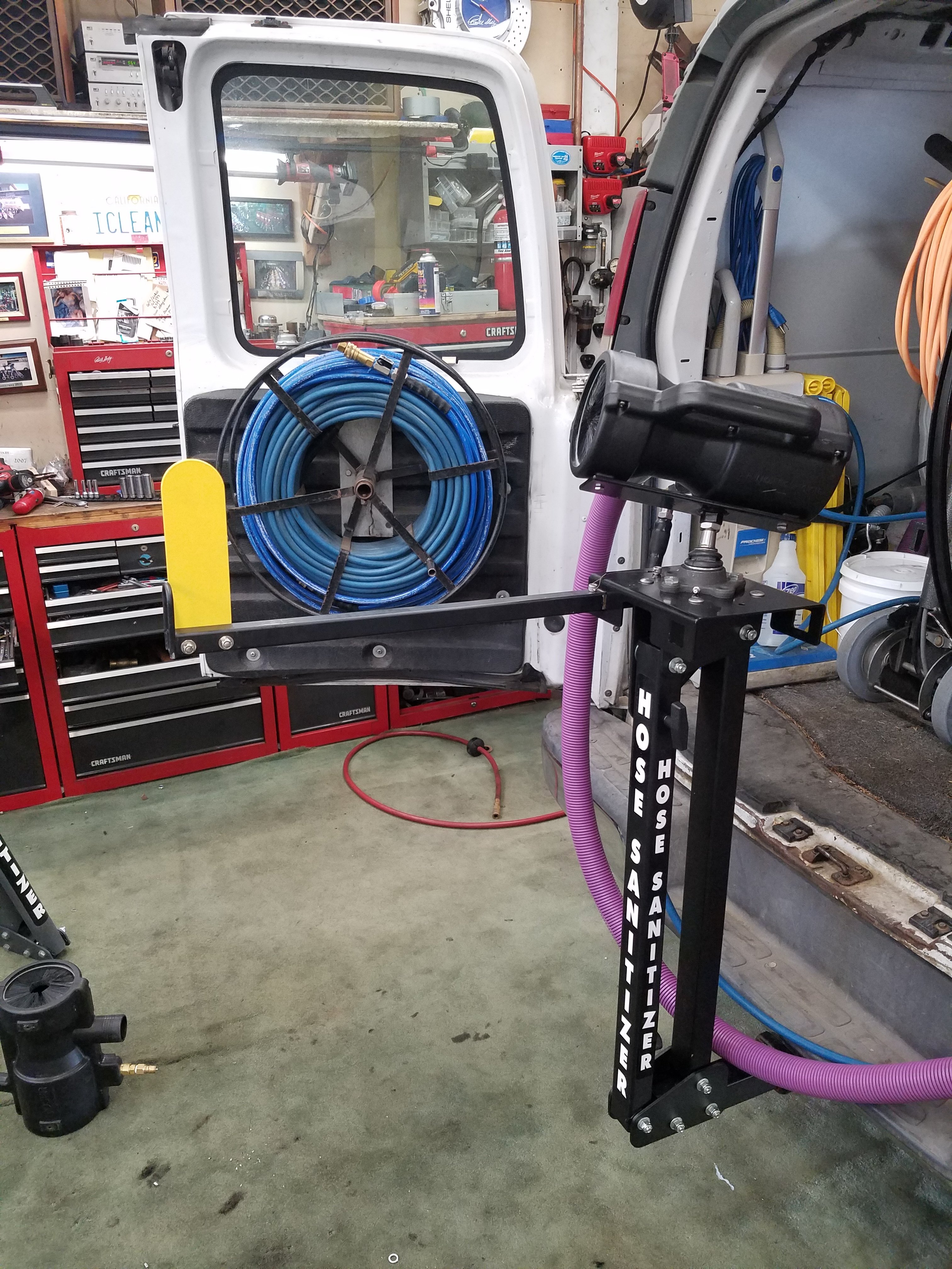

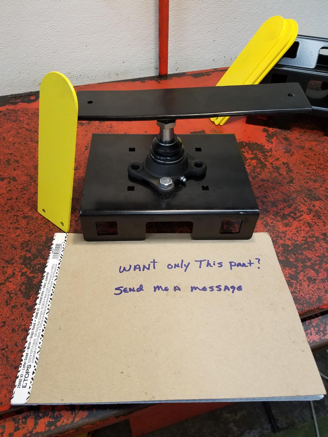

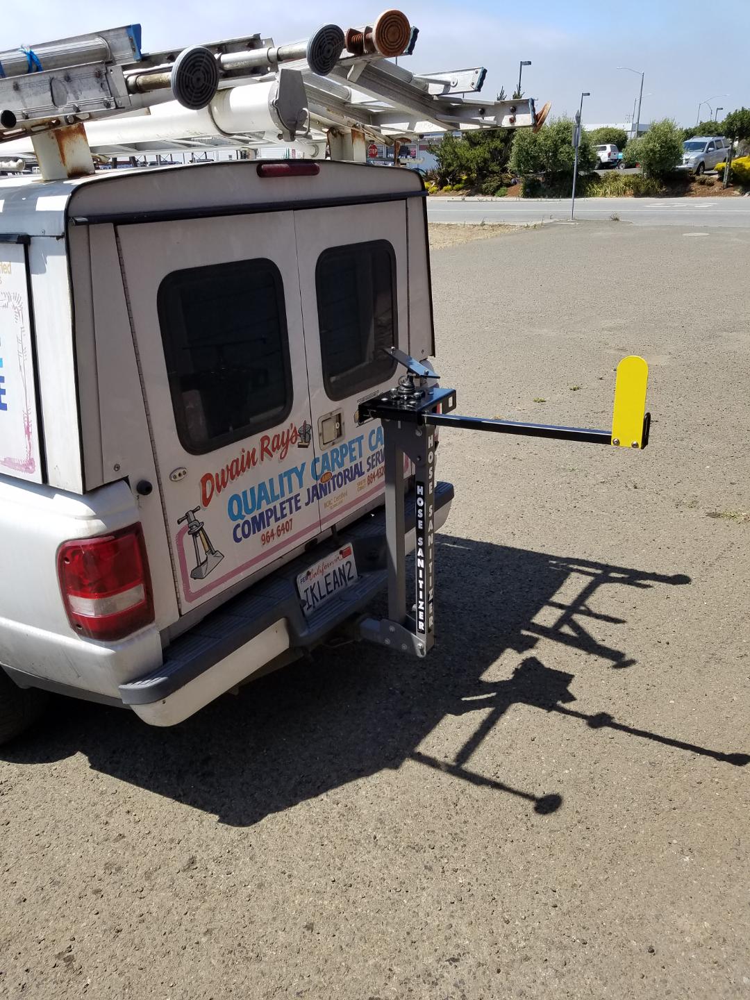

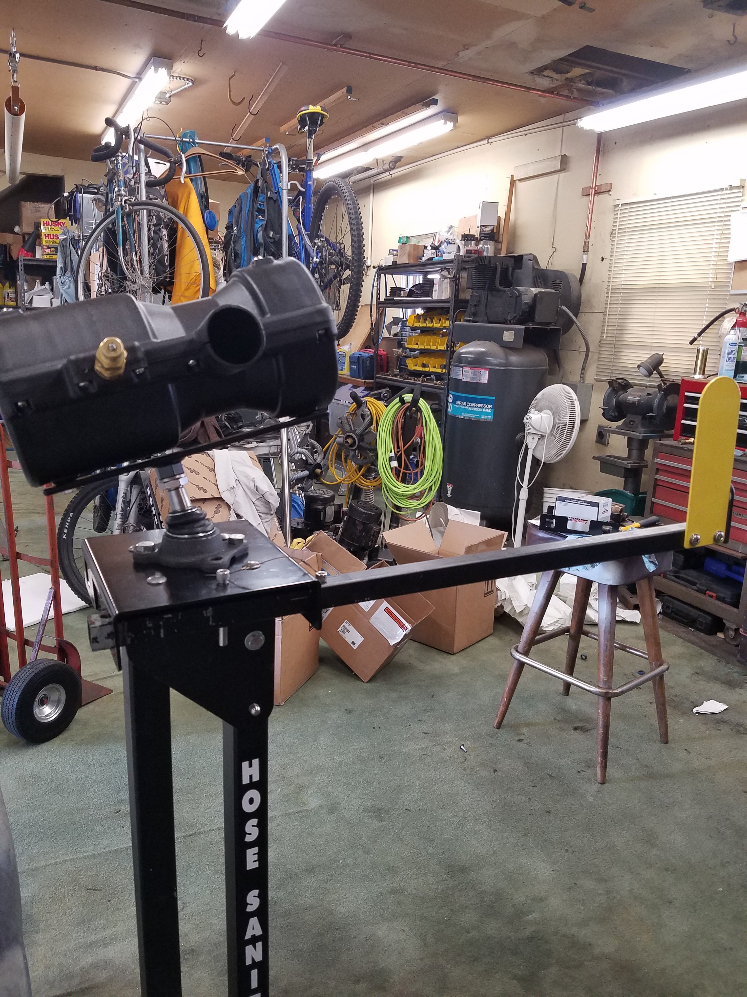

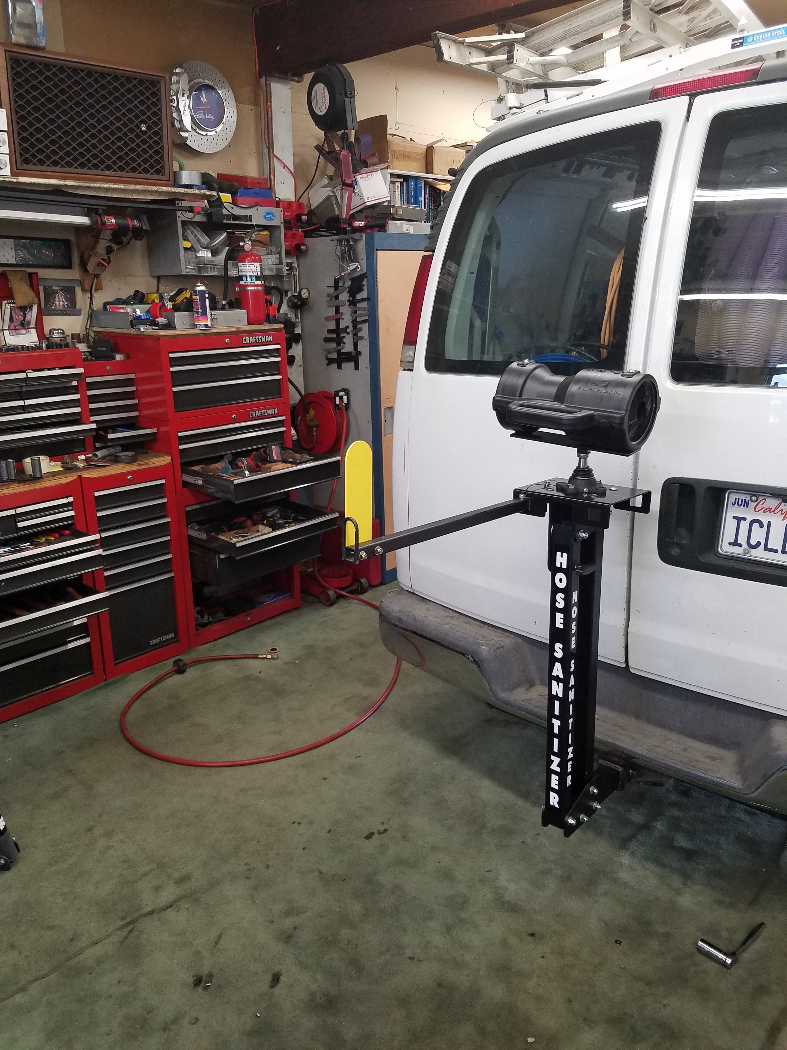

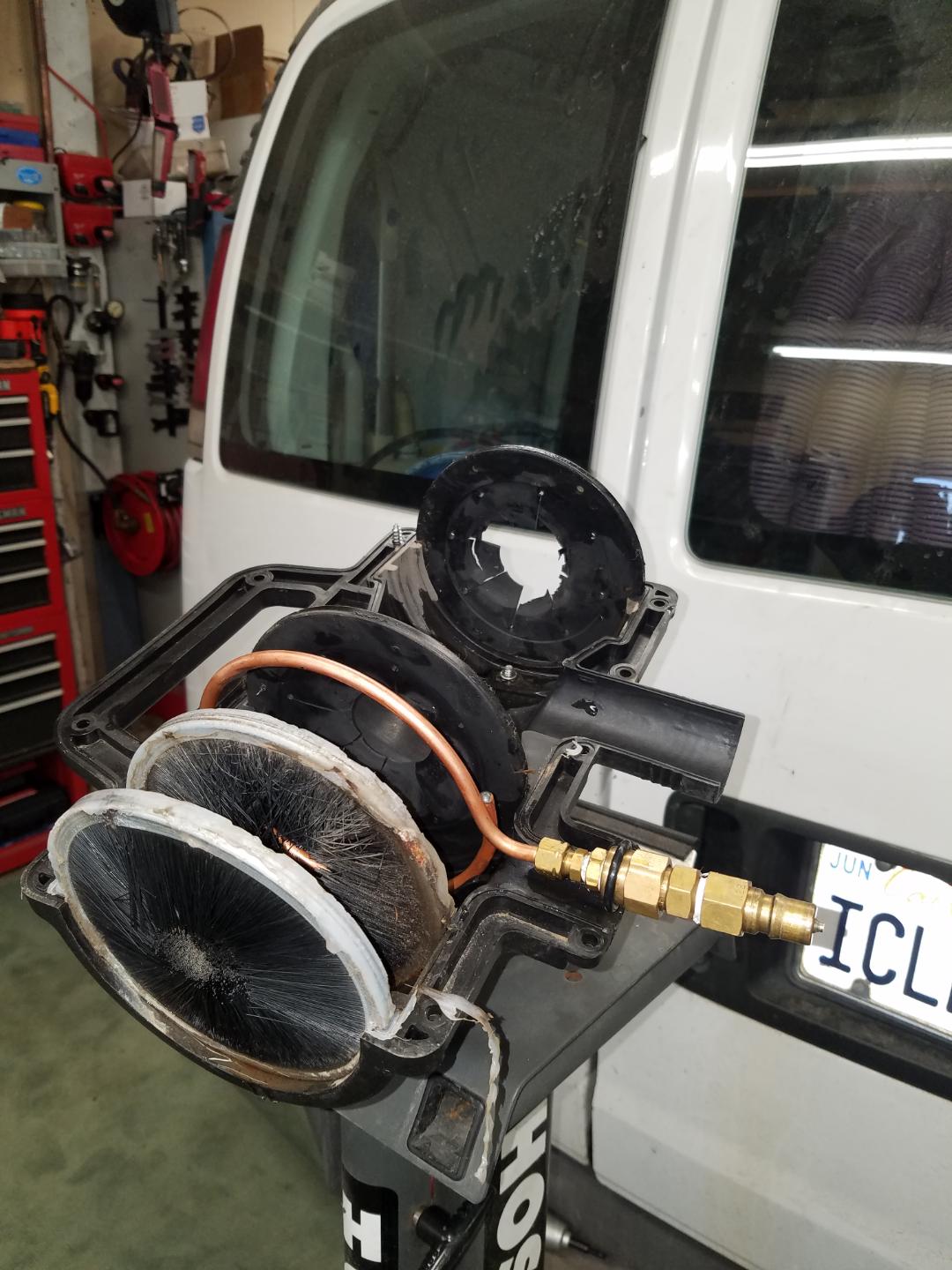

I had 1 of their first designs it had 5 jets i believe but it wasn't worth a shit the design they have now is great, this is comming from somebody that uses it after every single job and ive been doing so since the beginning of the pandemic (3 years now) Ive only had to replace the 3 rubber seals once and service the pressure wash ring once , with that all i did was scrub it with a green kitchen pan scrub pad while spraying water till all the holes sprayed. As far as price goes, i don't know where you're shopping but the most I've paid for just the hoser was 271.00 if you shop around you can find um for around 200 now the parallelogram bicycle carrier i modify to permanently mount it to the back of my van is a different story. If you can find a new one, that alone can cost upwards of 500.00 i find lightly used ones from 150.00 to 300.00 ive built 8 so far so ive bought 8 hosers in th past 3 years 1 is mounted on the back of Frankenstein 1 with a used carrier and new hoser is for sale at my supplier on Rohnert Park for 575.00 and i have a complete new one for sale on ebay for 849.00. 5 were sold the pictures of the complete one is the last all new one i have for sale if i build any more they will be made with used parallelogram less hosers and bicycle carriers i have the parts to build 4 more

Sorry i said 3 rubber seals there's 2 they were 4.50 each , bought 6 as to stock spares for any of my customers that need um
