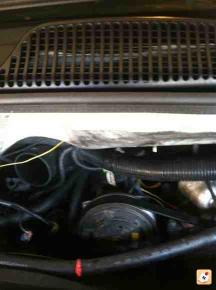

Mine has both, now what?
Electric Clutch engages the shaft which turns the blower.
Jus sayin ; )
Jus sayin ; )
I think that's what my Cleanco 47 Compact has but this thread is starting to make me feel like an idiot.
