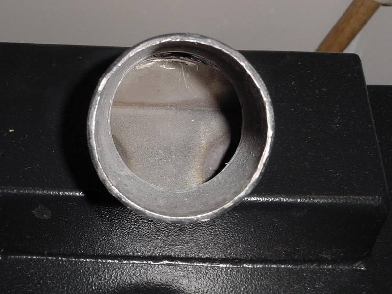

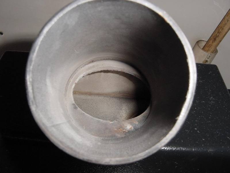

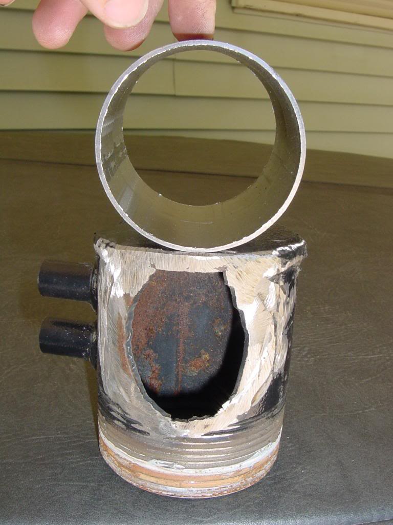

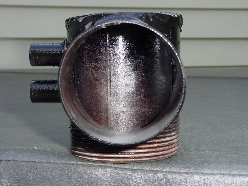

Shane Tiegs
This is what I took off my Victory. First pic is a comparison of the blower inlet opening before and after I redesigned it. BlowerInletbefore5_zps31104608.jpg This is what I put back on the blower. BlowerInletafter2_zps85d60f9a.jpg The restriction inside the recovery tank port was almost as bad. RecTankInletBefore_zps3b5a4f6a.jpg This was after I opened it up. RecoveryTankInletafter_zps27733129.jpg

Johnny
Those pics look like my Freedom 47. What did you use to open the tank? I would be afraid a grinder would leave particles that would be sucked into the blower.

Shane Tiegs
Since its SS it wasn't easy. First I cut as much out using a saws-all, using different angles meeting as near to outside edge as I could. The I used my die-grinder to finish it out. I used a shop vac and compressed air to clean out the debrie.

Larry Cobb
Shane;
That design is poorly thought out.
Having that restriction in the recovery tank inlet . . .
would generate extra foam in the tank
from the increased velocity of the airstream.
Larry

Shane Tiegs
Shane;
Larry
Foam was never a problem. The restriction engineered into this system made it impossible to get anything close to acceptable blower belt longevity. Pictured above is what I found on the suction side of the system. The inside diameter of the silencer inlet and outlet was down to about 2". After getting rid of all these restrictions the cfm increased significantly and have nearly 2000 hrs on the current belts.
