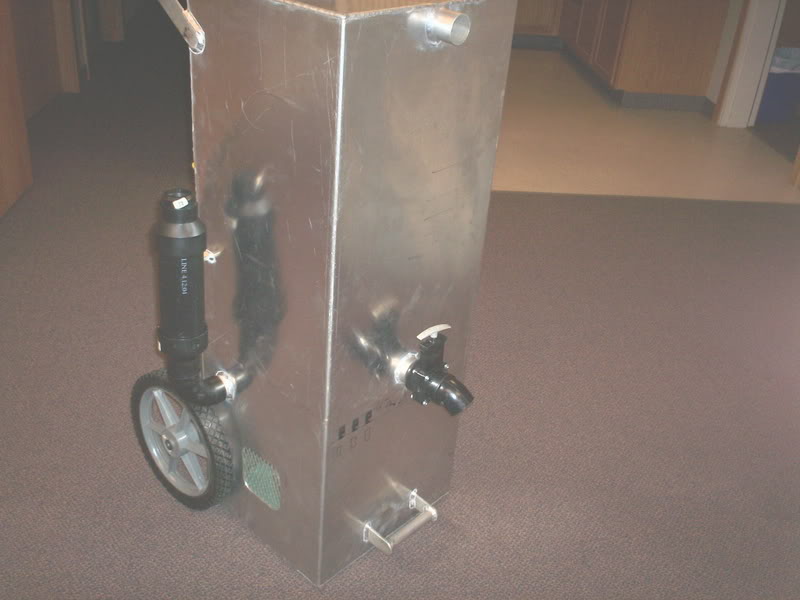

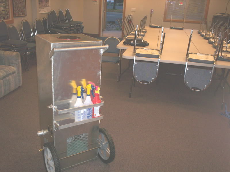

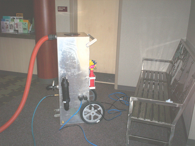

I made one for Tony Wheelright he cleaned millions sf of casino carpets he paid me to make him something pretty much bullet proof. So I made it for him.
You guys talk and want quality but are not willing to really pay for it.
Trying to please the POG'S it's an impossible job.
I remember when I brought this machine out all the critics " Oh look it's a scooter " " how much for that piece of shit " " holy shit that much!!!!! "
Then the problem with being a small manufacturer soon enough after you do all the R&D for everyone else with your concepts.
This machine even once made a trip to mikey fest a few years back. The rotomoldedplastic guys were all over it.
The components stay cool what a concept ( which is the killer of all portable machines )
I sold just one of these machines to a carpet cleaner Tony, the 5 others I made went to institutions for in-house cleaning. All these machines are still in use today.
I'm sorry there is no money making a Rolls Royce portable NONE.
you may not notice from the pictures but this machine is large with great balance large wheels when it sits on the floor it's not going to roll around. It has a 20 gallon waste tank. Easy to get up and down stairs. The dump valve fits over the standard toilet. It has a chemical shelf.
Lower loading handle. Everything is welded so no leaks or gaskets to break down between the waste tank and the components below.
I would say that willys problem with the pumptec 205 it that he just might run them to death with very little maintenance. I would ask when was the last time you lube the bearing rebuild the pump head with a 30 dollar kit before it crashes?

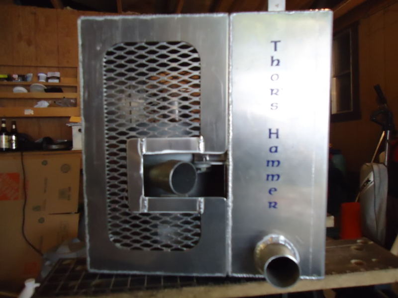

combine this system with this and it's quite the combo
