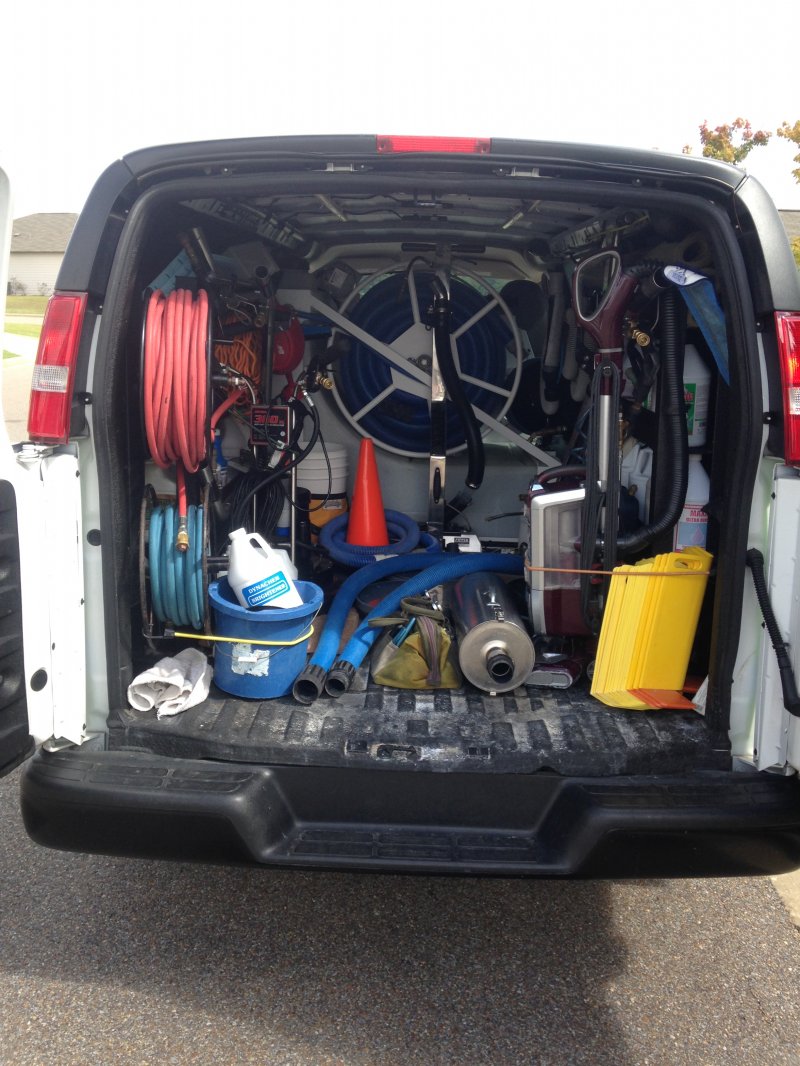

I've been talking to Butler for a couple of months and REALLY like their system for all the obvious reasons. I want the 210 waste tank, but that set up leaves very little room for all the tools needed to clean carpet and tile these days. I was told a regular size van has 21 x 31 inches of open space in the rear, and the extended van has 21 x 50 inches of space.
Does anyone have a Butler with the 210 waste tank? If so, do you pull a cargo trailer behind it for your tools? I really want one, but...

OMG!!! Is it really necessary to carry 3 of everything on the van (I hate clutter) ? The water softener wouldn't be needed where I live, so I guess there is enough room.

If you need the van more "open", just don't get the back shelves(which are huge). A three tiered shelf will work fine. It's up to you how it's set up.

The 210 gallon tank takes up no additional floor space. The legs on the hose reel are shorter and it sits on top of the tank.

wow.... My Cleanco(chev extended) has 48"w by 72" L..... 4' by 6'..... Let's put it this way, there's as much cargo space as my pickup has......

I will only run a 210 waste. Love it.
If you don't want to run 2.5 inch hose you will probably carry most of your hose on the reel. We run 2.5. The reel carry 100 feet of the 2.5 inch hose comfortably.
We carry in a 50 foot 2 inch and carry a couple of 25 foot 2 inch we hardly use.
Shelves.. I max them out. Going to put the stuff somewhere...
For equipment, I have a 15 inch Zipper Wand, a 15 inch Zipper SS Super Spinner, a Rotovac (either XL or 360i) a 10 inch CRB, a vacuum, a floor Spinner, extra hoses in case I break, tons of chems but have reduced that different types except for so many test chems. Seal-A-Door units, grooming brushes...yeah...i carry more than a lot of people... You can get as much or as little shelves you want.
Never needed a trailer...
Not sure what more you are trying to carry.
