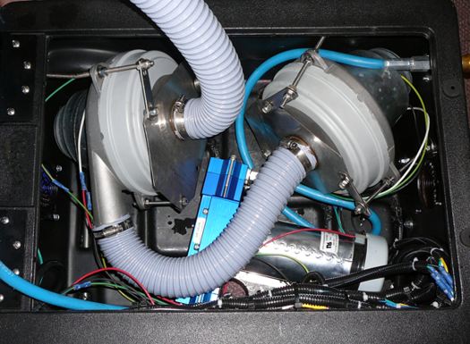

We are committed to building a new, more powerful portable extractor.
It will have Dual 8.4" Ametek Lamb Vacs with a total of 1346 AirWatts.
(the old Titan Quad-Vac we built was only 1000 AirWatts)
Pump system will be brand new Ametek hi-efficiency motor, coupled to a 500 PSI PumpTec,
delivering 1.6 GPM for superior flushing.
This extractor will operate on two 15 amp circuits,
due to increased efficiency of all the motor designs.
Projected weight should be ~95#.
Mytee extractors will be used as the starting point.
We are testing a couple of different models for interior volume.
Price will be in the $2900 range with Teflon glide SS wand & hoses.

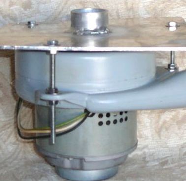

Here is a photo of the mounting plate for the 8.4" vac:
2" port for maximum CFM.
Vac shown is a 7.2" we were using for sizing.
Larry

The Breeze84 is finished.
Tested @ 210" of lift and 141 CFM.
The high Airflow is impressive.
These are the most efficient vac system ever in a portable.
The series 8.4" vacs and 2" Hose do require some volume.
The SS vac mounts are smaller than our 1st mounts for additional flexibility.
The 500 PSI PumpTec has the new Ametek 1/4 HP DC motor,
and delivers 1.6 GPM for excellent rinsing.
A fan on the left provides ample cooling air.
http://www4.cobbcarpet.com/zen/index.php?main_page=product_info&cPath=85&products_id=5103
Larry

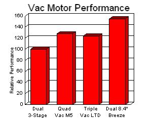

I finished testing the Breeze 84 today.
Lift on final setup was 220" of water.
More importantly, I ran the following tests with 12" wand on the carpet:
I graphed the Breeze 84, comparing it to 3 previous extractors.
I set a base extractor with Dual 3-stage vacs @ 100 relative performance.
Both the Quad Vac Titan (Mytee M5 based) & the Triple Vac LTD required at least one 20 amp circuit + 15 amp circuit.
The Breeze 84 only requires 15 and 12 amps.
Quad Vac had 28% more performance than Dual 3-stage Breeze.
Breeze 84 had 55% more performance than Dual 3-stage Breeze.
Comparing these performance levels to the TM performance levels I measured at Nick's BBQ last summer,
tells me that a Breeze 84 + a Booster with single 8.4" vac ,
should outperform a 16 HP TM with #3 blower.
ETM's are on their way !!
Larry

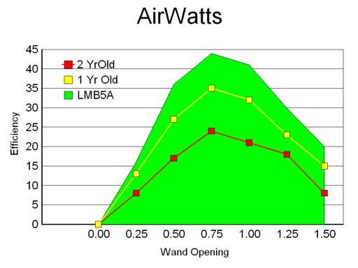

Frank;
AirWatts is the actual vac power of a vacuum system.
It is the best way to compare systems.
Here is the chart of AirWatt performance on the 8.4" Lamb vac motor:
http://dev.ametekfsm.com/Bulletins/122176-18.pdf
We plan on series . . .
with 230" of lift,
and 141 CFM.
Larry
