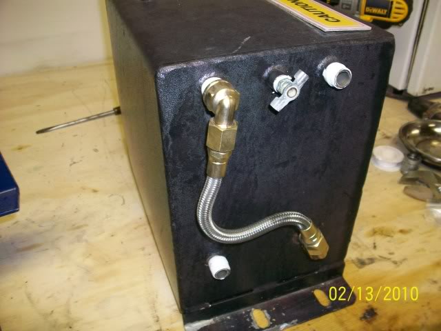

I have not seen the 1200 heat exchangers so I am not sure if this would work, but is there room to be able to wrap the heat exchanger with heat wrap such as done on header pipes and I think I have even seen Les do this on one or so of his units. I know my brother had done that in the past on our Butlers before they went to the high heat options.

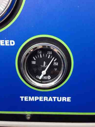

Taken from my Cleanco, I think this was a crisp December day. It does take a little bit to get there. My manual says 14 Hg of lift I think, I have the Compact 47. The free exchange of all this info is so beneficial. Companies will have to stop making false claims.
