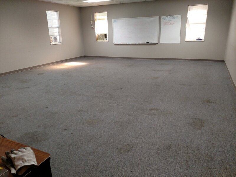

OK every time I clean with Hoss or Rx I can never get the swirls out.
Even with both glided. So what's the trick??
Somebody do a video of the proper way if my problem is operator error plz.

I've had the same problem. Instead of doing long left to right or right to left passes, try doing circular or oval patterns. I've found that it's a lot less likely to leave lines when cleaning this way. It does make it slower though.

I did groom this job with little improvement.
Will try Circle next time.
I was in a job I Rx'd months ago and it still had swirls.
These trashed commercial need RE but not happy with post swirls.
Even wand vac doesn't do much.

Use the rounded glides on cgd. I did that to my insurance agents carpet. Crb. Scrubbed, brushed by hand. They are still in his office.
11,122
Post wanding with a little steam could remove marks if its piled carpet not sure about commercial
9,380
Hawaii
IMHO, I believe it to be the overlap of the cleaning head making the pile reversal.... High heat, plus how much you overlap could be setting it....

I once permanently heat set the carpet on a commercial job with my hoss. As a matter of fact, it was a job that i just did again last night. The swirls in the 1 and only room I cleaned with it are still there as vibrant as ever. It was 3 years ago. Last night I used cimex, then zipper. The owner stated its the best its ever looked. Been cleaning it 9 years. I've never used the HOSS on CGD since that job.

That is why sapphire also came out with the Teflon/plastic glides to help with the issue. The lines simply are there because as you go from one side to the other the direction from one side of the drive plate is completely the opposite of the other side and to uniformely clean you must overlap and you return along the line you just cleaned. So the pass shows easily, then heat sets it as it drys.

Just cgd with metal or square glides. I haven't had and problems with the rounded glides. I just use the rounded on now.
Fort Worth , Texas
It can happen on both but on resi it it more easily correctable.
I think the problem for us has been if we leave those swirl lines on commercial it looks like we just bonneted the carpets when they were paying for hwe.
Then I actually have go back out and show them the hoss or rotovac in action to ensure there perception of value is still intact and without question.

I've had issues with leaving lines on commercial even with the rounded glides. I have two Hoss's and my tech's do a majority of the cleaning. We run the rounded glides because they are a lot less likely to tear seams.

I don't have the Hoss but I do have the 360i... It has happened to me before also... I do believe it looks worse when wet but gets a little better when dry... Since I've gotten the Zipper jr, I've been Cimex/Zipper commercial jobs... For Residential, I haven't had a problem... Nap brush after RE'ing to get rid of the swirls...

I've never trusted a rotary on cgd. Two aggressive with the heat you are asking for trouble. In my opinion they need to redesign that head. The vac slots are way to small. Your just chocking down the vacuum with those small slots. Longer and larger slots might get rid of the streaking problem although I doubt it. Open it up and the little hair balls would go up and carpet would be drier. It also needs to switch glides quick, not a bunch of little screws. I'm running the Square ones and never going to change them.
