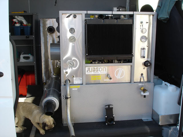

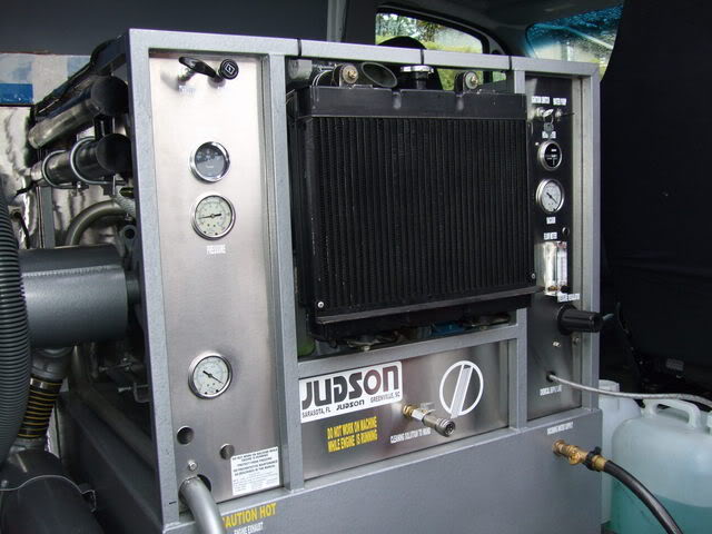

That is a pretty impressive looking TM, I personally dont care for the blower exhaust sticking out the side like that though. Wouldnt take much more work to run it through the floor to under the van.
Also, the gas can mounted in the van is a big issue. Especially in California. wait till the Fire Marshal - OSHA - or insurance adjuster sees that. I would get a external gas tank. Maybe small companies like Jerry's dont get inspected like the larger companies do, but We were inspected every year.

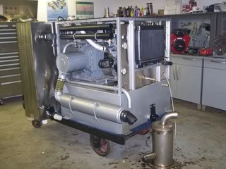

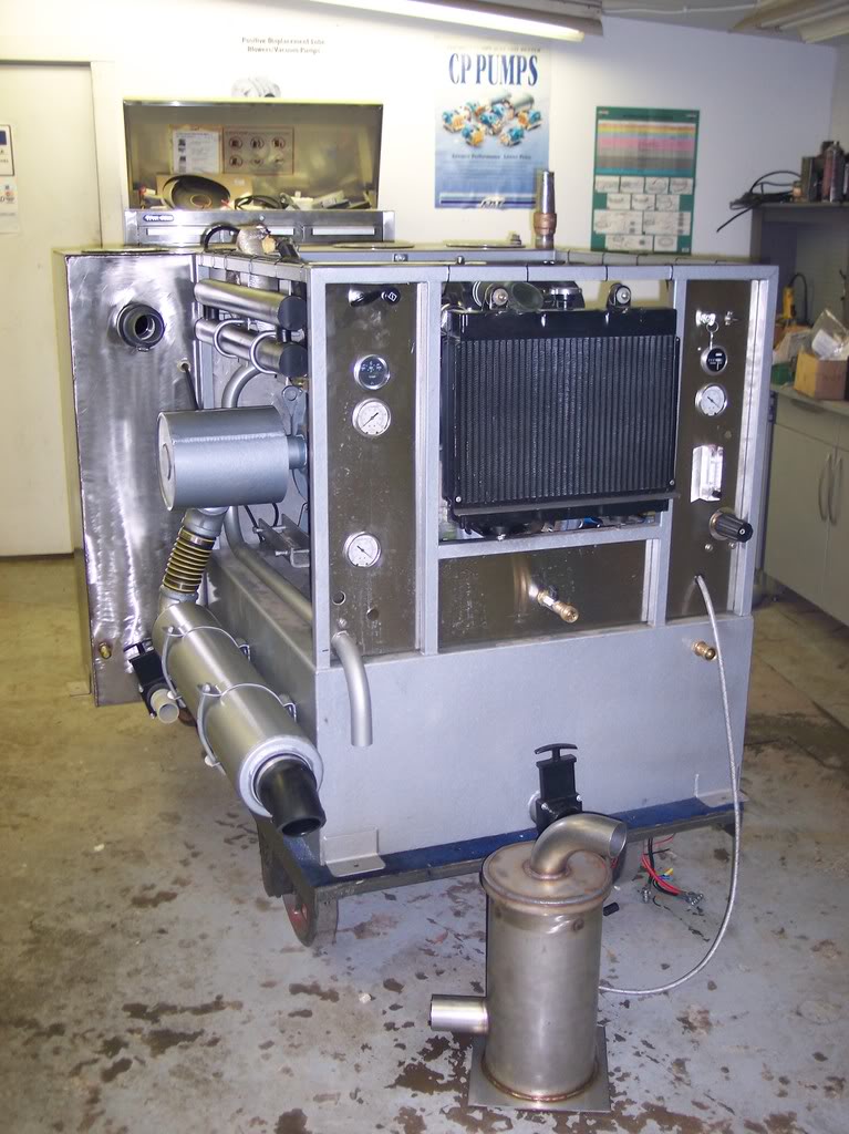

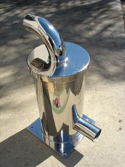

When I ship the unit to Greenie to be installed in Cu's van, it was supposed to be temporary, just for the show, but Cu seemed to like the unit, so I told him to just keep using it. As far as the temporary gas tank, we are installing a fuel cell under the van. Or we may convert the engine to LP. The silencer on the side of the tank can be mounted under the van, if room allows.
The main objective of the silencing system, was to demonstrate the performance of a 45 blower on a single wand. The plumbing system of the blower has virtually no back pressure and the exhaust of the silencer has no blower noise.
At the show, the unit was ran on 400 feet of vacuum hose and the vacuum at the wand was very impressive. A properly plumed 45 has more cfm than can physically go through the wand.

Good Les. I would hate to give Bill Bane another front page add for his weak ass eletro mounts.

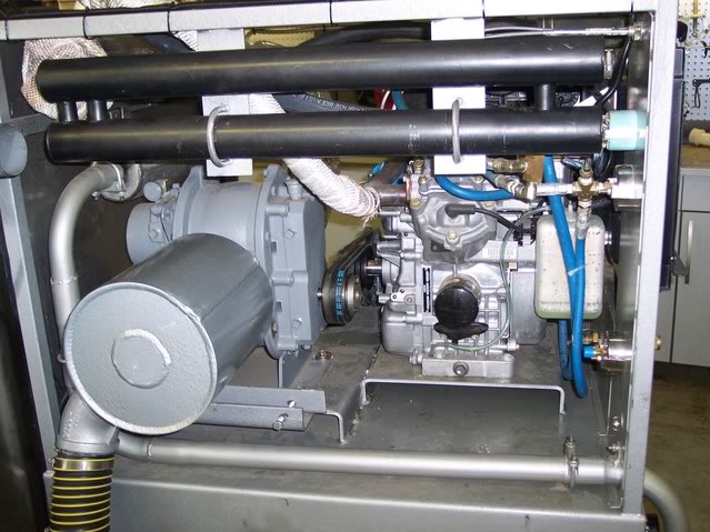

I also noticed the use of very small pulleys on the blower and engine. I know this is a newer model, but dont you expect quick wear on the belts do to slippage with such a small pulley? Why not use bigger ones?

Scott,
I don't know why other manufacturers have to use scare tactics to sell their machines.
There are more TNT truck mounts than any other one machine in the market today, and I don't know of anyone who has had a fire with a TNT.
If they did, they never called us.

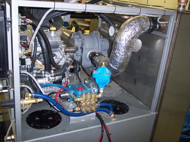

We have always used 3V belts. Each belt delivers 9 HP. A set of belts on a Judson TNT, last about 4 years.
The pump pulley comes with a 6" pulley on the clutch. This means that we must go with a 3.35 on the engine to keep the pump from over reving.
Then we come off the engine pulley to the blower with a 3.65 with 3 belts.
The total drive to the blower is close to 30 HP. The blower under full vacuum draws around 9.
It's just a good proven belt system that we have always used.

What size is that blower? Your website only says it a tri-lobe.
What type of diverter system does the heat exchanger have?

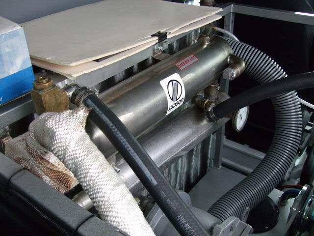

One thing that I have been impressed with what I am hearing about this machine is that it is designed to deliver 200 solidly at a much higher flow, all on a NO BACKPRESSURE 45 blower. This is huge for the engine and longevity of the machine. Personally, I think there are ways to still capture the heat from the blower, without building backpressure, but I'm not a TM builder.
Any machine that will sustain 200 on a greenhorn is going to be pretty good. My maxx470 will out do that, but at what cost? My machine was more, and we all know that HM has known backpressure issues if you don't maintain the equipment properly.
I'd like to know how the machine can not divert and not bypass, without BLOWING UP the HX's or pressure lines coming out of them!

Well I dont see why you couldnt pre-heat the water box with the blower exhaust, that should give you a few more degree's and make it easier to sustain flow.
Personally I would like to see much more then 200 at the mount though. Stanley Steemer units run 220 or so at the mount with a 04 wand, but cant maintain flow. When dual wanding with 2 04 wands the water is cold.

because it puts it back through the water cooled engine aka radiator...

Just to be clear, I didn't say / ask about the potential of "blowing up" anything. I know how the system works and that's not really a concern.
I couldn't read the temperature gauge, so I asked what it's reading. It looked to me like it was about 200 degrees, and I was asking about that...
