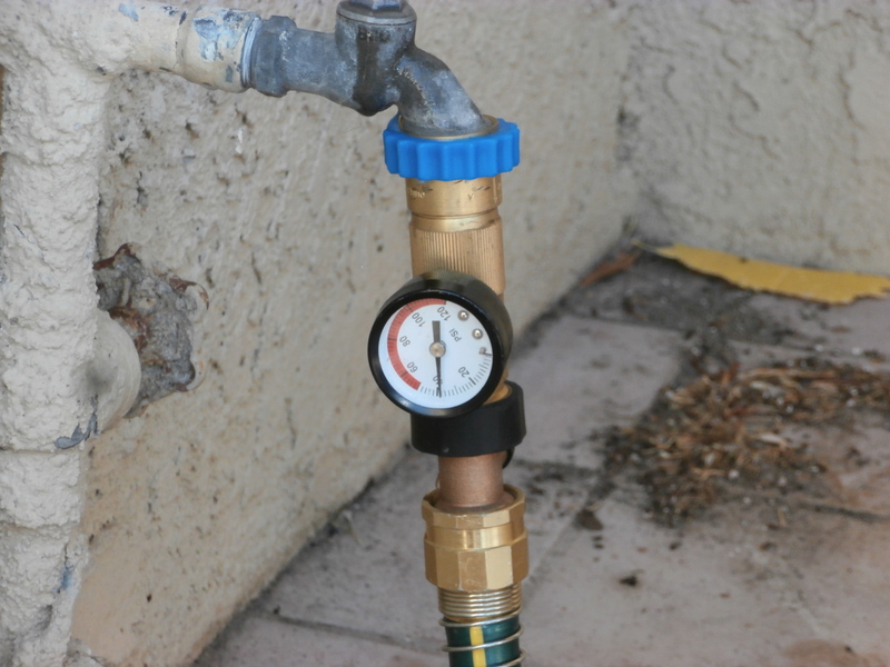

The older version has a float in the "water box". If you have high incoming water pressure the float can stick.
Get a 40psi pressure regulator and put it on the water fill QD.
That's not it...sometime last year I was pretty sure that I solved this problem.....I was getting really bad back pressure at the end of my hose....so I put a regulator on the hose before it went into the truck.....calm the pressure down before it hit the regulator/pressure valve built into the machine....everything was fine...she ran great...every once in awhile it acted up but it would bring the pressure right back..and I could just go on...annoying..but no bug deal....for some unknown reason..it just started getting worse...Yesterday I had to bring the Thermalwave way across the other side of town because I could not get it to come back while a tile job was being done...All my filters are clean...orifice is clear......there is no blockage any where....I know I have water pressure coming into the machine...for some reason it just all of the sudden won't keep up again....Once it does this...even if............( normally I don't.. but that is another story )......I have the heat off...it will spike and hit 320.....from that point on I am in total cavitation and things are getting pretty dangerious and someone is going to get hurt........
I can tell you what I think it is.....I think it is the inlet pressure valve....It is only supposed to allow a certain PSI into the water box...it is the first thing the water hits coming into the machine...there is a pressure cap on the water box....if it gets to much it will pop the over flow....I don't think that this thing is letting in enough water for the machine to keep up....that's why my hose back pressured so bad.........
Replace the pressure valve with one that may allow more flow into the machine.........you will probably keep popping the pressure cap......(?)
I talked with a guy today......(same machine as mine )....that runs off fresh water tanks that feed his water box..he does not feed threw that pressure valve and has never had a issue...
This is a great machine and I still stand by it....I would buy another one with out hesitation..still the best slide in out there.......This is the worst I have seen it....It is my understanding that the new ones do not do this but I can't honestly say if this is true or not....It has a little hic up that really needs figured out before someone gets hurt.....
