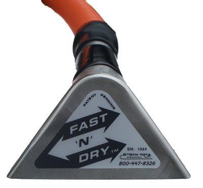

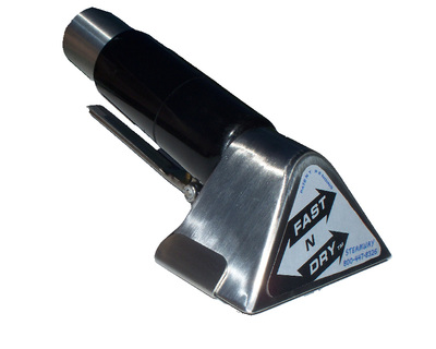

Does the HK clog with hair or fiber like the SS tool and require it to be dismantled to unplug?
Would like a side by side video comparing the two and telling of their faults honestly without bias.
I can't remember the last time I had to clear fuzz from the Hydrokinetic, though I suppose it could happen.
Loren Egland
Oct 18, 2006
1,284
Antioch, California
Loren Egland

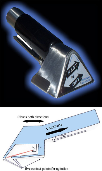

The Hydrokinetic is a little heavier but more rugged than plastic tools. I use it for its higher cleaning performance while leaving the fabric dryer. I also use heavier 3/8 inch solution hose, 2.5 to 2 inch vac hose, and two inch tubed wand for the same reason.
It's nice to use carpet cleaning pressure and flow and not have to lower either. It cleans in both directions, lifts the fabric up into the tool and shears through the fabric only. The glide helps it hold the fabric in place while easily gliding over the upholstery and the shape makes it easy to fit into the crevices. It's hard not to like the original dry tool.
I have never seen or used the Fast-n-Dry upholstery tool, but my guess is it will work similarly.
