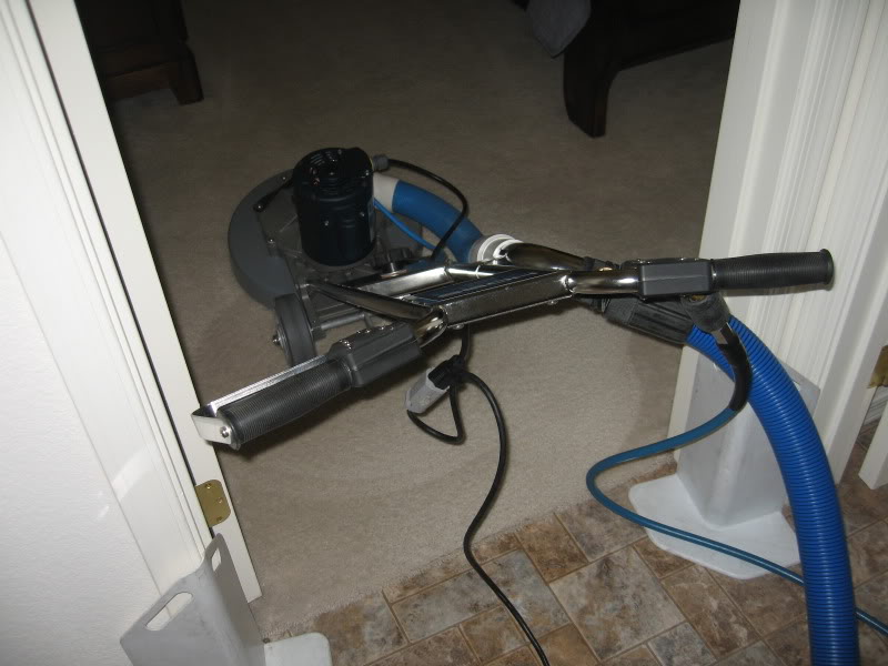

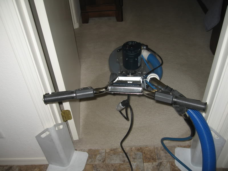

Need to turn the hose connector more at a down ward angle....
the wider handles make it more comfortable to hold and control...you can manipulate them thru a 30 inch door witch seems to be pretty standard....
but with the hose sticking out the way it does on the right.... and 99% of the doors are on your left side...you can get it in there...you just really have to watch yourself....
