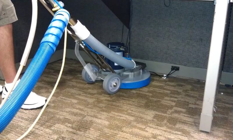

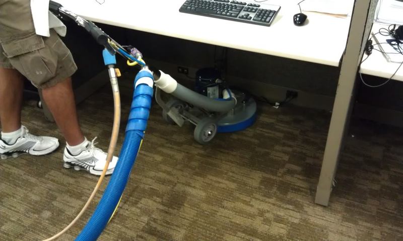

Well, gave it good commercial test run last run. 5 hours of straight cleaning dual wanding with a RX. First off, I have had very little rotary experience either with these or 175s. I have always been a crb (when necessary) and higher flow wand.
It took a little to get used to, but you do notice right away the tug (power). I started with the 52 (against Jim's advice) at 500 psi (dual). figuring the dual solution would really be closer to 450ish. The 52 was too wet after doing one hall. Changed out to 47 disc. Still good flow. Was basically running one slow speed wet with a slightly faster dry pass. I got better as we went along.
A few dislikes, seems like I need longer handles for my 6'4" frame. The noise from the clear elbow at the base was annoying to say the least. I tried several things to stop it to no success. This alone would keep me from buying. It is pretty noisy overall, but that whining is bad. It continued with vary high pitches throughout the night. After almost 4 hours, I gave in and passed it to our other tech.
More likes than dislikes, it fit nicely under the desks that we were doing (better if longer handles). It will grab phone and data cords if not careful. :shock: Only one casualty. We were cleaning 6 y/o carpet tiles that had never been cleaned.
It noticeably lifted the pile on these tiles even with only one wet and one dry.
I did very little spotting as compared to the wand. Really only gum and it went quicker than with a wand as well. Even though it was a pain at first, I liked that hair (and stuff) would get caught on that solution tube for easy disposal as opposed to clogging the vacuum ports.
It seemed to work more efficiently than the RX, but with my limited experience with these tools I'm not sure how qualified a statement that is. It will get some serious consideration for purchase. Although, I would love to get my hands on a Zipper tool to compare side by side for commercial purposes. Overall, very happy with it. Will put it to use on some residential tomorrow. Thanks for Jon Don of Tampa for letting me test drive it.

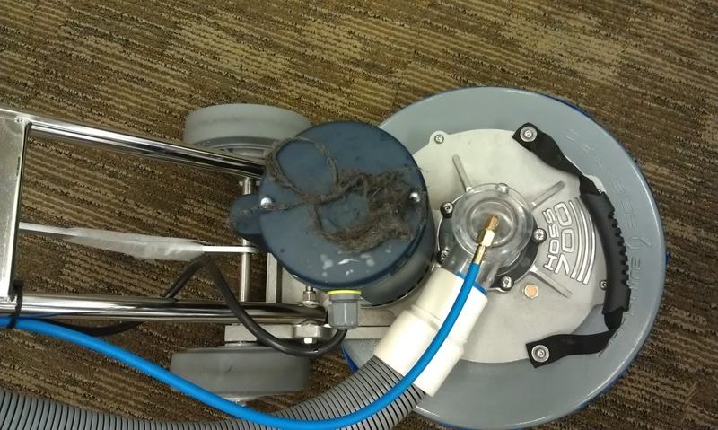

Jim Bethel
837
Sunshine Coast, QLD, Australia
Jim Bethel
Mikey P said:
that noise is the Axel system and there is a lift kit for 6 footers available.
Sorry Mike, I know what he is referring too here, and it's not the axle (they have different wheels that stop that rattle that you heard originally Mike)
Whoever put this together (with no disrespect to whomever did it) hasn't tightened/adjusted the bolts and the clear vacuum tube. What happens if not done properly, is the white gasket that sits between the clear sight tube and the base can suck air and vibrate the gasket giving it a sharp piercing/whistling sound. It's a real quick fix and once adjusted - you won't hear from it again.
