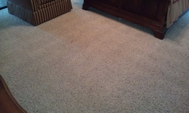

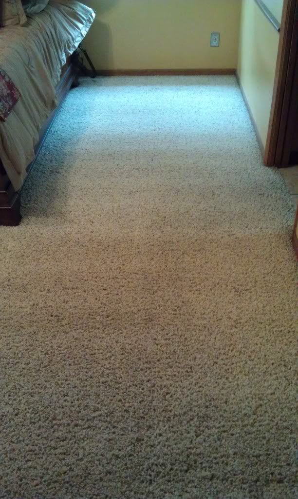

I have continued to use this in different conditions. Overall, I have been very happy with it.
However, did a carpet last week - thick nylon pile - that streaked pretty bad. I had to respray and wand it out.
I have not had any streaking until now, I checked all jets, check valve, etc to make sure flow was sufficient. All checked out. Is this machine not a good fit for this type of carpet?

looks like you may have went to fast.......
The Hoss is faster then the RX and the 360i...but you still have to find the pace.....
ON all rotaries.....you have to give the machine time to do its job.....
