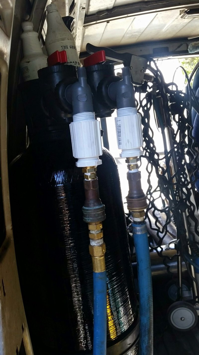

on my van I use a live fresh reel...so from the reel it goes to the softener and then out of the softener into the machine......

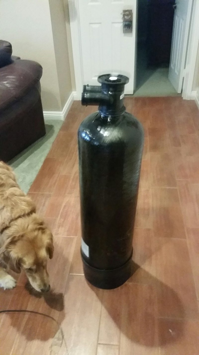

I purchased mine about 2 years ago and didn't realize I was holding out. i have the 21,000 grain which measures 8 inches in diameter and 36 inches tall. Hope this helps:

I have a kinetico in the cab over..not much room in the van for the brine tank and all...I like the the one Tom found..small and simple to use...
I will more then likely pull the kinetico out and replace it with another one of these....

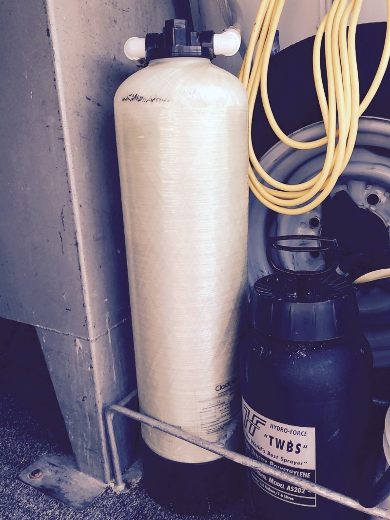

Yes, the top screws off. I will probably get it to dissolve first in a a five gallon bucket and then pump it into the system. That's how Prochem does it and I have one of their brass inline siphon system, looked like a big hydroforce dema valve. I'll use the top cap as a back up.

What the heck does clack mean?
Hi Guys, This is Will from ABC Water, 602abcWATER (222.9283). I decided to jump in here to answer some questions about the portable water softeners we sell. Clack is one of the manufacturers we use for some of the tanks and in/out style heads we use in building our portable units. Any other questions, please let me know.
