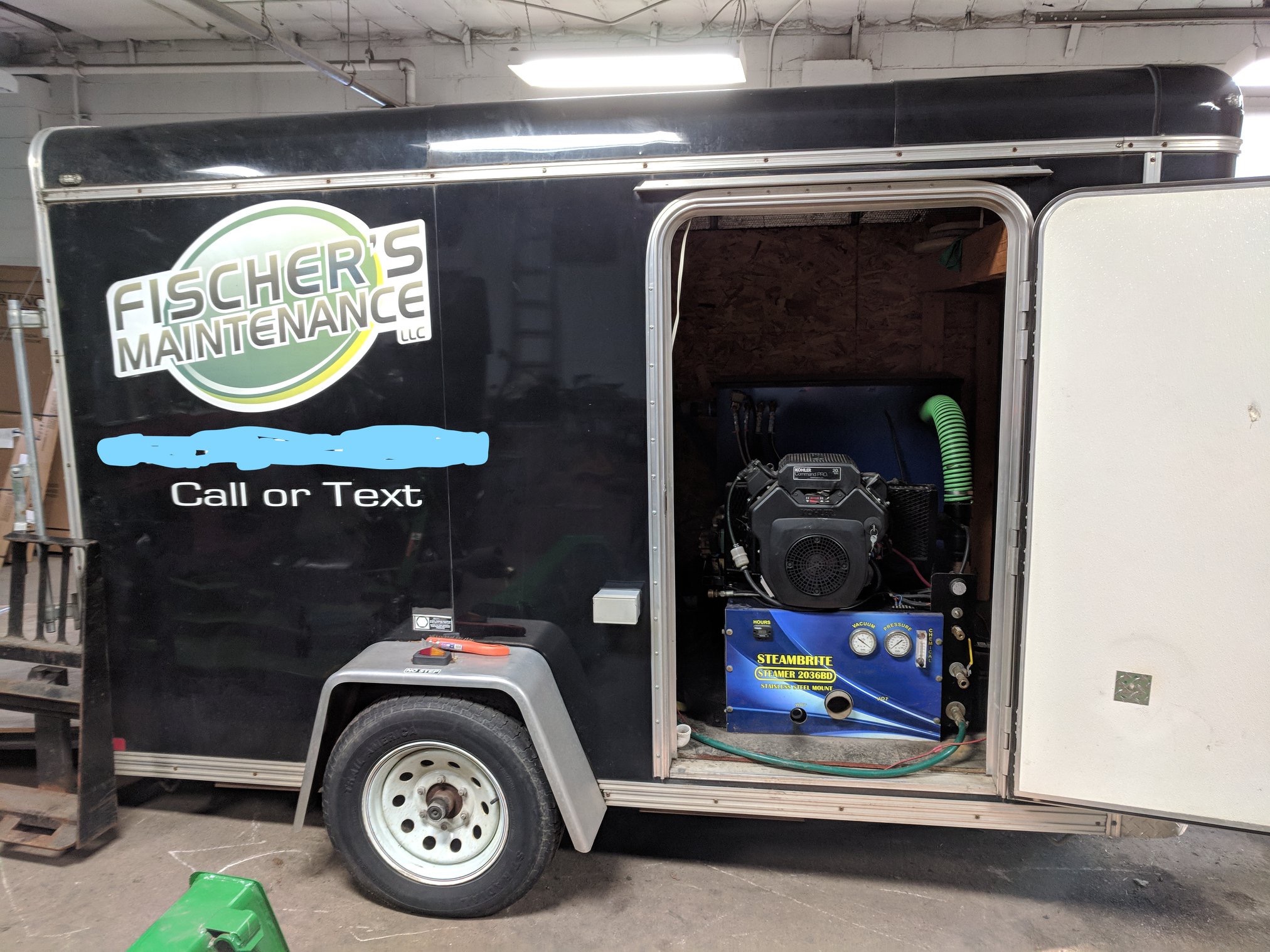

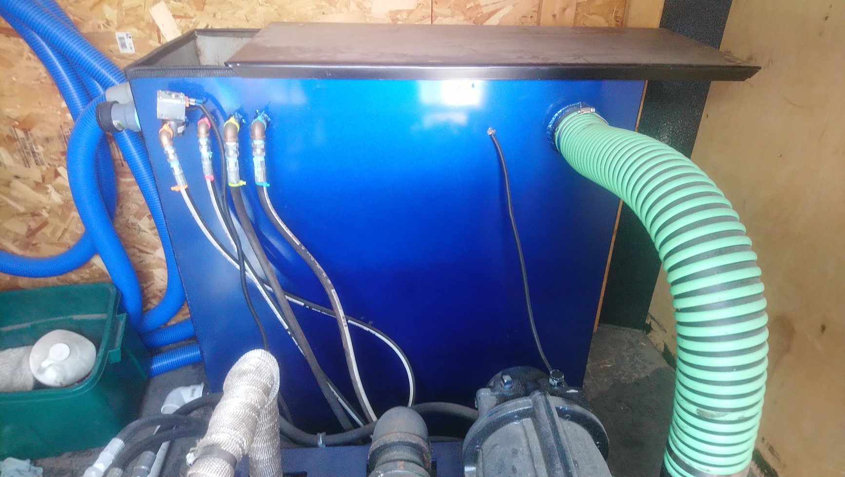

Here are some pics... the only pics other than one showing 41 hours on it.

I've never run an EZ so I can't say for sure if its junk or not. I'm not biased against the manufacturer like some though so I'd consider it. Plenty of folks love their EZs
At 3k and low hours I'd probably chance it after making sure there were no signs of freeze damage/nerf goop/other issues.
Looks like a decent unit

Try it out, see if it's worth the money. If you know the guy won't he be honest about being junk or not?
I don't know anyone that owns an EZ any more. They owned the only ones and not the CAD versions, which look better.
It's cheap but might be worth it, as long as it's not a problem. Run it and find out.

I don’t know him, he’s just known in some circles and doesn’t seem to be a chump. I spoke with him over the phone and he didn’t pull a Guerkink or anything. Definitely didn’t try to sell me. Said the trailer has been stashed in one of his two shops the entire 2-3 years he’s owned it.
He’s 9 hours away.
