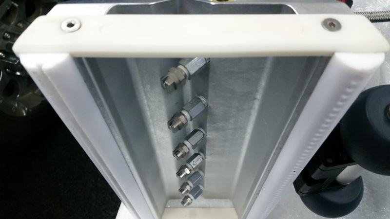

That it flushes like crazy. Have the larger unit with six .02 jets. Slot glide in front and hole in back.....

Some people have contacted me and not seen the Zipper wand or the underside.
So I grabbed a few pics this morning....
Got a nasty restaurant tonight, so going to keep the slot glide in the front (this is the way it came set up) but I do have another hole glide for the back to try. We do prevac also, but I am not sure it is going to help the restaurant tonight :biggrin:
