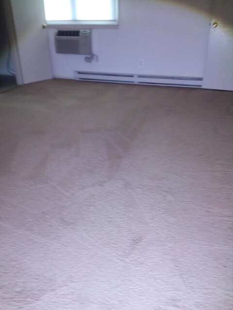

I know all you guys here do excellent work but there are a lot of guys out there using TM's that are SOAKERS
SOAK and Leave
But all you guys using the HWE Method get a bad name because of the SOAKERS
I do move outs at one Apt Complex and the maintenance guys tell me about tenants having carpet Steam Cleaned by SOAKERS and carpet still being wet the next day Stanley Steemer
They have had me go in and reclean jobs after SOAKERS because of wicking
I did one last week because it looked like it wasn't cleaned but it was and that one wasn't Stanley Steemer
Every time tenant moves out carpet must be cleaned before new tenant moves in
Tenant moving out must pay for and get carpet professionally cleaned with proof (receipt) to get their security deposit back
If tenant doesn't get it cleaned Apt Complex has me clean it and money gets taken out of tenant security deposit
Apt Complex recommends me but some tenants find cheaper Company
