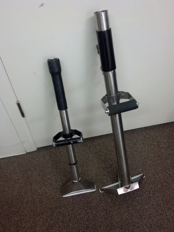

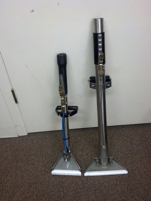

22in, we had a PMF tool similar to what Saiger has and hated it. Really disliked having to use an adapter hose to fit the 2" and it was too light, didn't feel like it glided very easily.
We went to the Prochem about 3 years ago and all the guys really like it.
Although when I can I use a full size wand :headbang:
Reactions: Mike Pailliotet
Ofer stay off your knees and get a longer tool. Jordan ours has a 2-inch tube, yours was 1.5?
I liked the wand too that's why we went with the pmf cut down version Olsen sells.
Ok so here is the deal-doe. :winky:
A wider head just allows fewer passes and the longer handle (34-36 inches depending where you measure from) less bending. The 2-inch barrel means no hose whips, just use your regular vac hose.
It is also lighter gauge material which also helps but because it is lighter you have to be more careful not to ding it up than with the PC one, which is pretty much indestructible.
It makes cleaning steps tolerable, while much easier on your back. Although you will get a steam bath from the heat kick back because you are now flowing some good heat. A great trade off in my opinion but some of my guys prefer the wimpy tool for that reason.
The difference is incredible. I cannot go back, the PC tool now feels like a toy for a boy!
Much easier to process stairs now with the larger tool. I still look at them with some reluctance but once I start cleaning I realize its no longer the chore it once was. :biggrin:
Our prochem is 2", the pmf style was 1.5"
While the PC tool has a 2-inch connection at the barrel it quickly drops back down in size past that connection.
Not true of the PMF. :cool:
A wider head just allows fewer passes and the longer handle (34-36 inches depending where you measure from) less bending, the 2-inch barrel means no hose whips just use your regular hose.
While the PC tool has a 2-inch connection the barrel drops back down in size past the connection. Not true of the PMF. :cool:
That's the one I want! I'll call Olson on Monday. Probably no glide for me though
I think they are hybrid. haven't had it happen yet. If you don't use a glide on your current tool you likely won't need one on this tool either. We have glides on all the tools so we ordered it from John this way.
