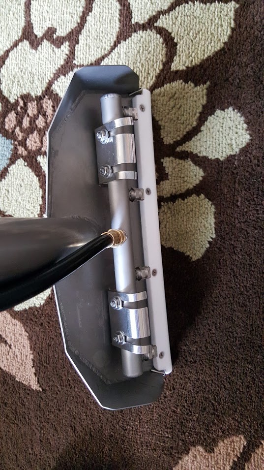

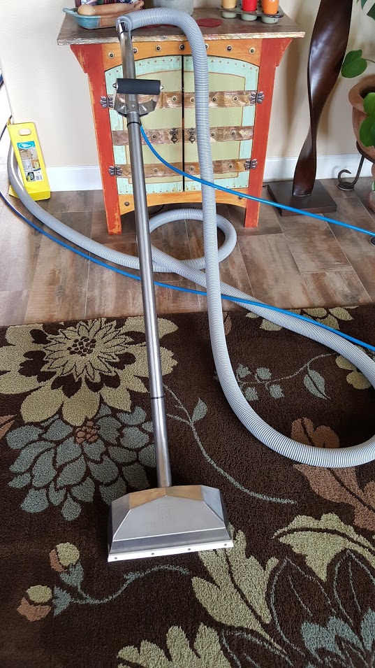

I first tried this Mach 12 in Vegas in September.
I need to use it more before coming to a conclusion but so far I'm loving it.
While it is a custom length for me, its very light, easy to toss around fully adjustable manifolds, secure two piece glide and believe it or not....
appeared to dry as well as the 2" wand I tested side by side.
with a 25 foot inch and a 1/2 whip..:eekk:

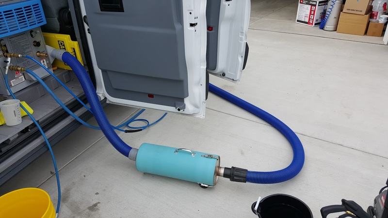

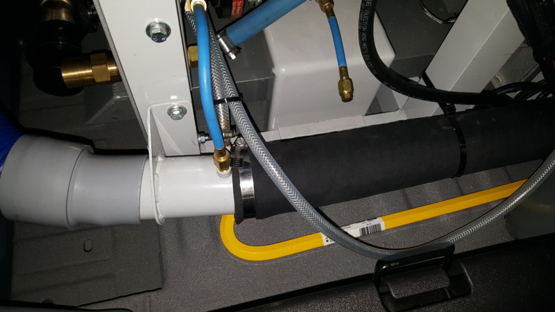

First you get a 2.5" tube that is ~4 ft. long (was that optional ?).
But then . . . you restrict it with a 1.5" x 5 ft. tube on the wand.

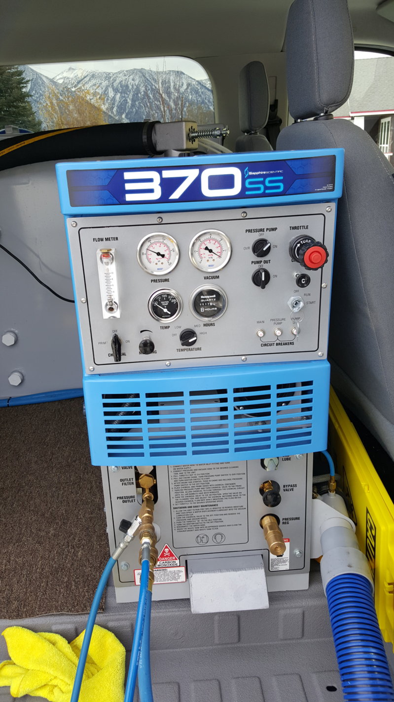

whats all the hub bub about vacuum hoses, 2.5", 1.5"? It is what it is as long as you try and achieve a balance. Just like water pipes over a long distance.
This little hummer 370 starts off 2.5" at the machine. You can start off 2.0" if you want, I've done it several jobs now with 75' of 2". Blower is spinning somewhere around 3200-3300. Your shop/install is supposed to set the relief at 13". I've used 50' of 2.5" so far on most of my work, 2" from there to my 4 jet WestPak. Went 175' couple days ago and then tried another 25' for kicks. Suck like a bandit. I don't miss my 47 blower spinning at 3400.
Hooked up my PMF 1.5 2-jet with 50'-2.5, 100'2.0 and then 20' of 1.5. Worked great. Just gotta keep things tappered down as you go.

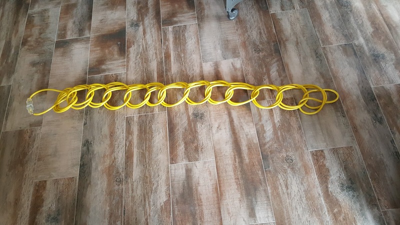

My new employee started winding cords that way last week and I was ....WTF!
Winding a cord like that is called a Daisy chain and is the best way to wind 100' or more cord. Does not damage, twist or tangle. It does take a minute to make but well worth it when you unwind and your cord is not tangled.
